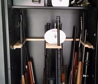

Put all the guns in gun socks, and remove the bolts. This allows rifles to be stored MUCH more tightly without damaging finishes, etc... Store the bolts on a shelf in Ziploc bags labeled as to which gun they go to.

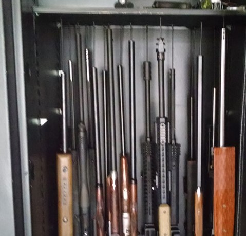

Rifle rods will increase your storage space by allowing you to store the vertically instead of an angle.
Before:
After:
