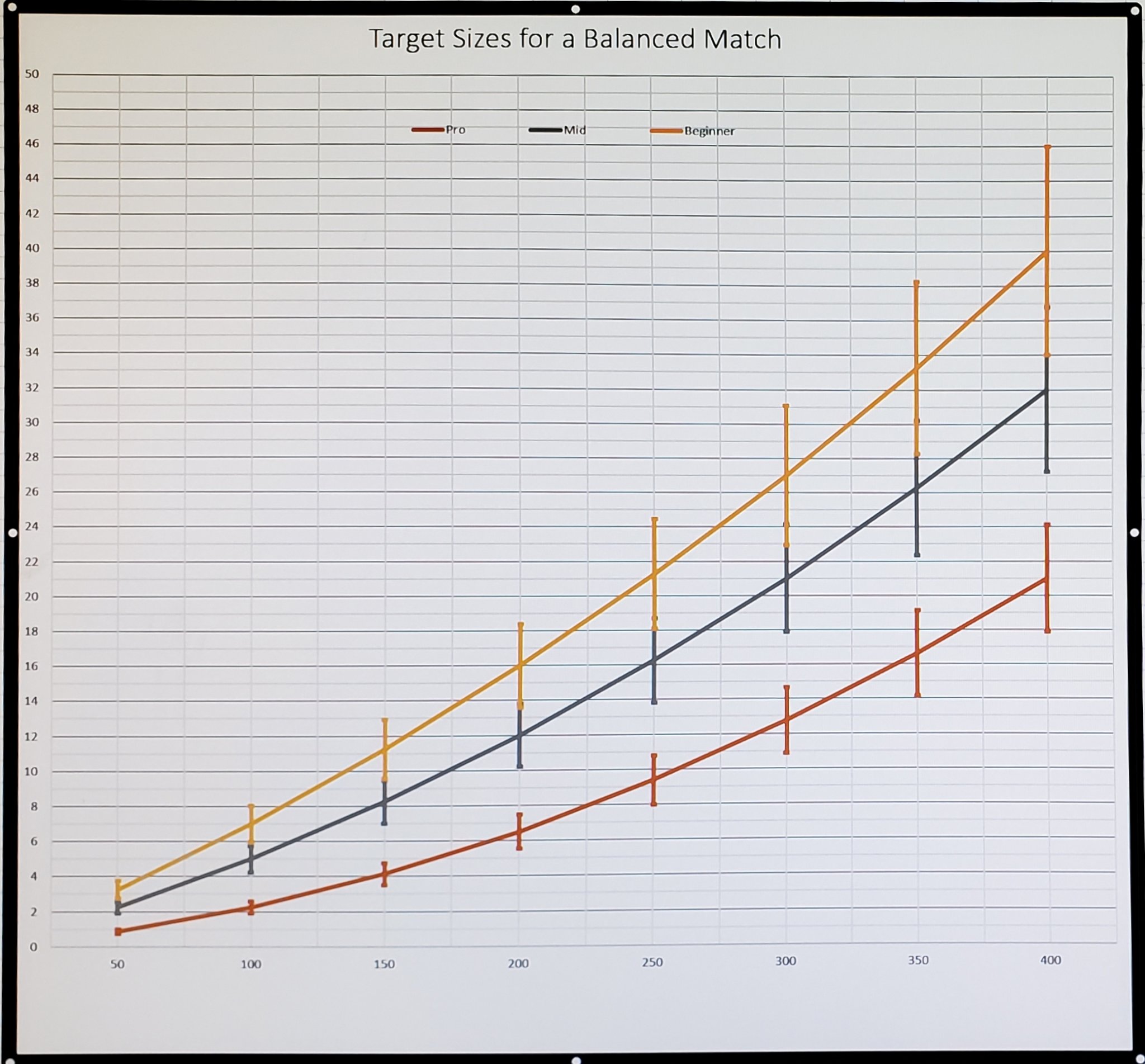

I find math super interesting so lets forget about testing differences etc. and just think on what you can get away with to hit 400 yards. You have a 4" at 400 if you can hit it 4x out of 10 thats 40% or a 0.5 SD of 2" +/- this gives a expected 10 shot group ES of 3-4 SD or aprox 12"-16". If you shot 100 rounds we would expect a group ES of 24" well maintaining a 40% hit rate. This is why Justins 50 at 200 is so... ah inflammatory. It fails to show the odds of hitting a much smaller target then total group size is quite high.
This also explains why you have guys who can shoot those 400 yard targets. I like your idea of extra shots giving new shooter much much higher odds of hitting. If they hit they will be back.
I have a bit of a project I'm doing to help new MDs with target sizes and PRS matches. Its unrelated to what your doing but its target sizes that should have a 100% hit probability based on skill level, wind reading ability etc. The bar up and down are for prop/ stage difficulty.
Beginner is a loose term here. This is based on what can be hit 95% of the time on demand any day of the week first shot.
