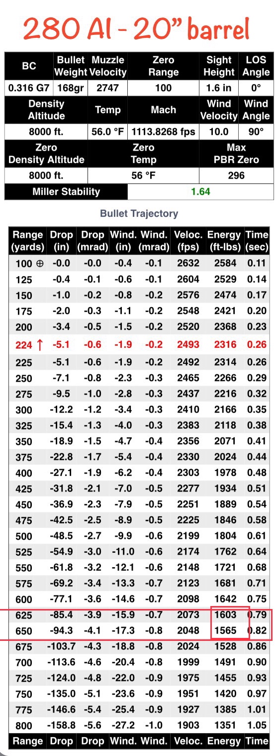

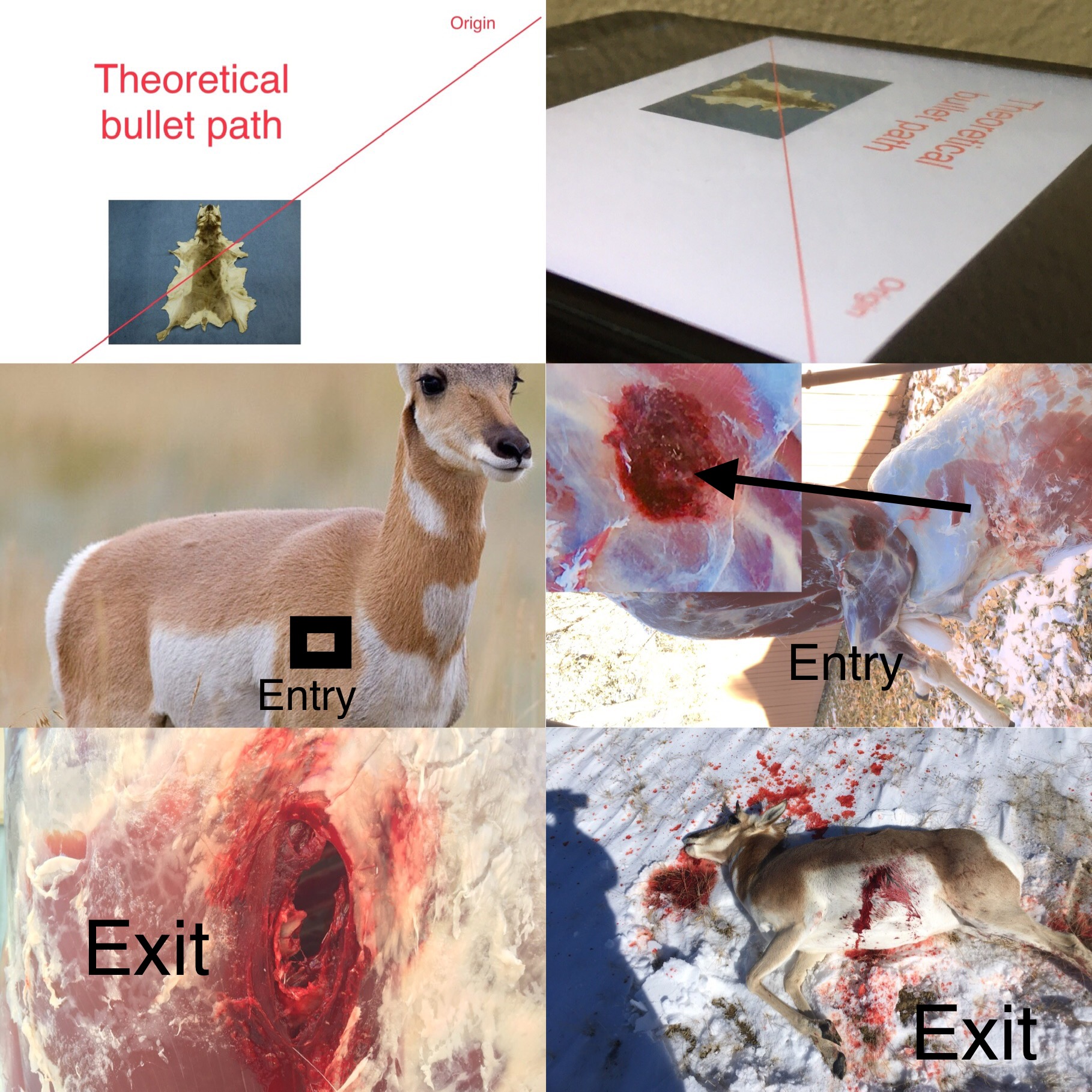

2019 late season doe Antelope at 638 yards. 20 inch rem 700, 280 AI Criterion barrel pushing 168 Berger hunting VLD 2747 fps w/ Thunder Beast Ultra 9 can. Even though the exit looks a bit far back no guts were disturbed.
Ballistics put the bullet traveling aprox 2060 fps w/ energy at aprox 1580 ft lbs
Post hunt gps tracking against gps tagged photos, suggests it went 20 yards before dropping. In my excitement I assumed she dropped where she stood and did not check in the snow. The heart was undamaged. I love game heart.....
Here is a buck from last season. Same rifle and ammo aprox 250 yards in the chest. He was actually coming toward us after he heard me put down a doe at 142 yards suppressed. Freakin opening day.... You can see some damage lower right under the left shoulder. Did not really lose anything there because the shoulder was ok and I mostly grind that anyway. Again the heart was missed. He fell where he stood.
