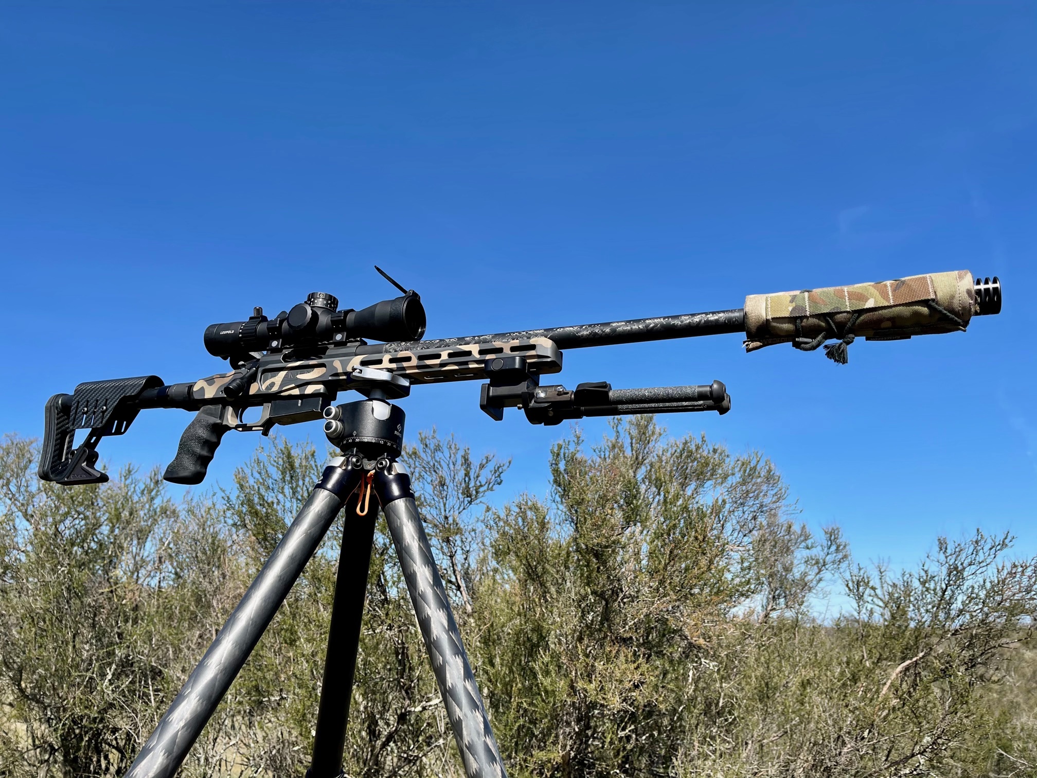

As a hunter, who shoots long-range in our hunt unit because of the way the topography often forces us; as well as a competitor who has owned much of the top tear glass including a ZCO. The ZCO and some of the other top their glass; are not on either my long-range hunting magnums or other hunting guns.
I see a lot of votes for the ZCO and I love mine, but the feature set comes as an overall weight package that defeats what I am trying to accomplish on a hunting rifle that I will not only need to carry but need to add a tripod, glass and still pack out the animal. I am not hunting varmints, other mammals that one might leave where they lay or steel. I can't count how many times I seriously thought about leaving thousands of $$ of gear on the pack out as the meat can't be left; ounces matter to me. Counting ounces, I still end up with a full features system; my magnum is 9lbs with, mag in, full arca rail, a huge Ti brake, exposed turrets, and a usable FFP scope with illumination (MK5 3-18).
I ran 5-25s but came back to 3-15x/3-18x. A 3-18 and your hunting rifle is wicked well past 1,000 yards on a mammal and usually will have the field-of-view on the low end to work when you're surprised by something a hair closer.

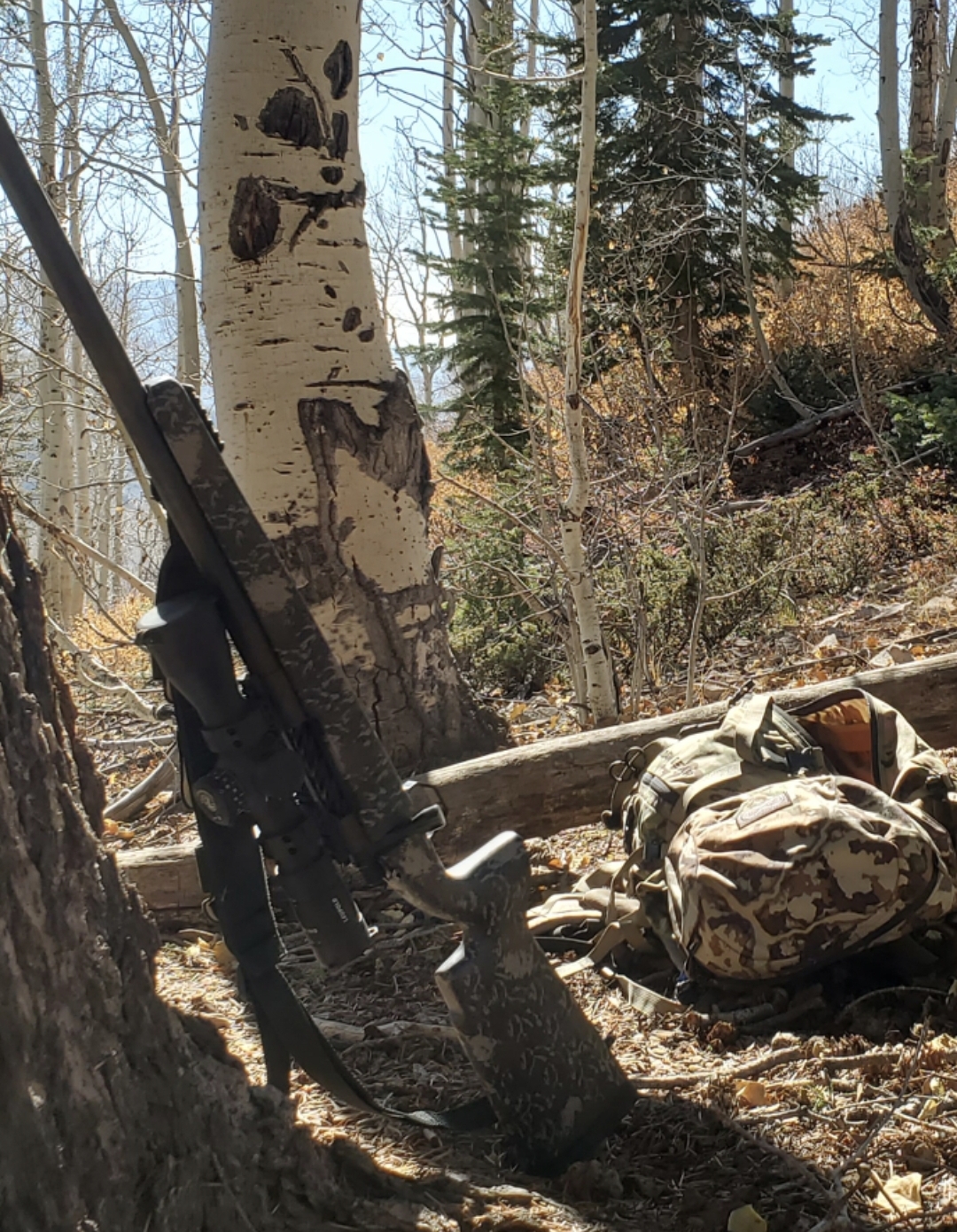

I run a SB 5-20 ultra short on my hunting rig. Great, compact scope, but a little on the heavy side. Worth the weight penalty.
NF Atacr 4-16 F1 is another option
March 3-24
Another vote for a MK5 3-18. Weight matters if you're hunting somewhere steep, and I don't think I've ever used more than about 12x for a shot when hunting.
