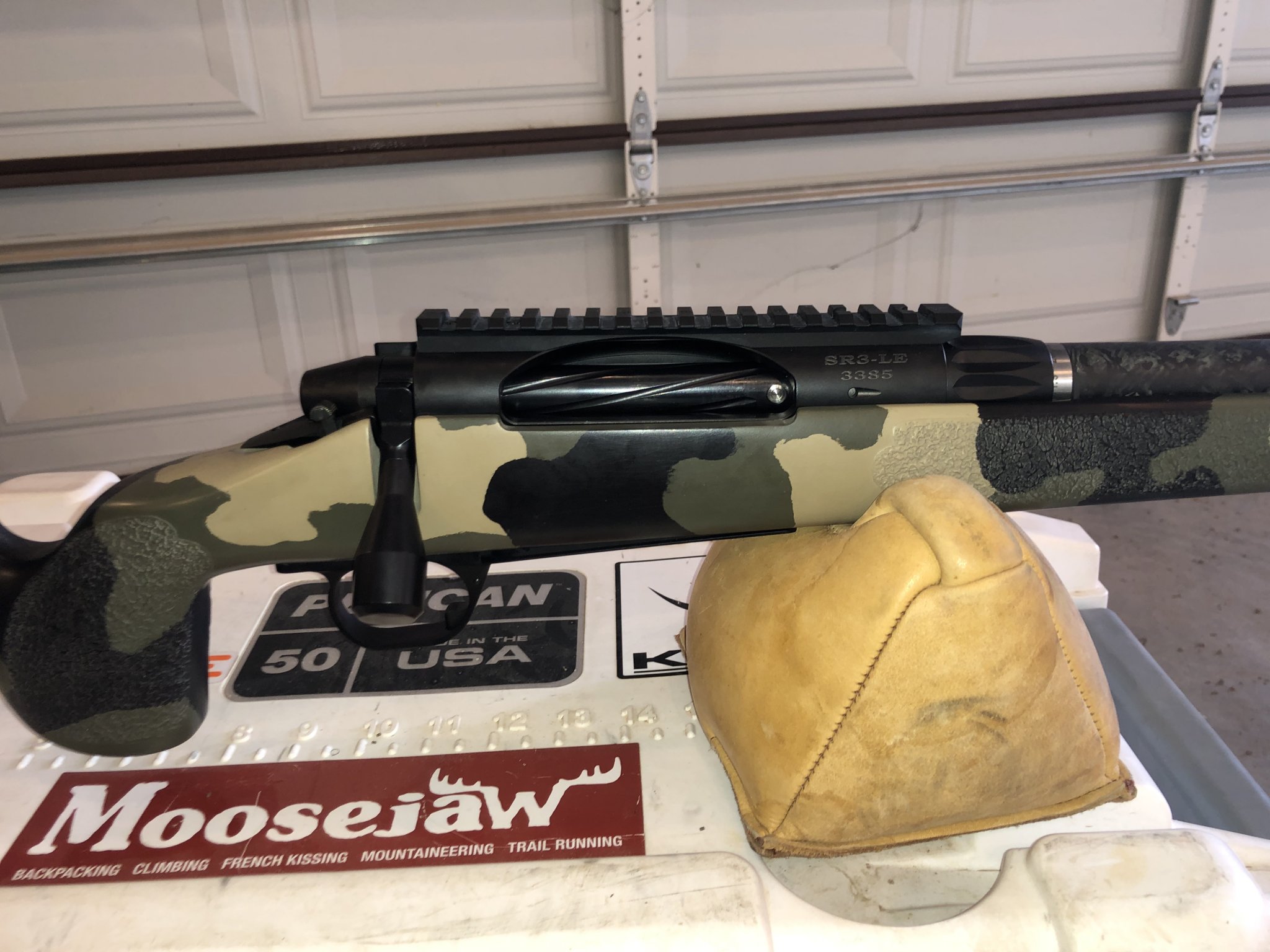

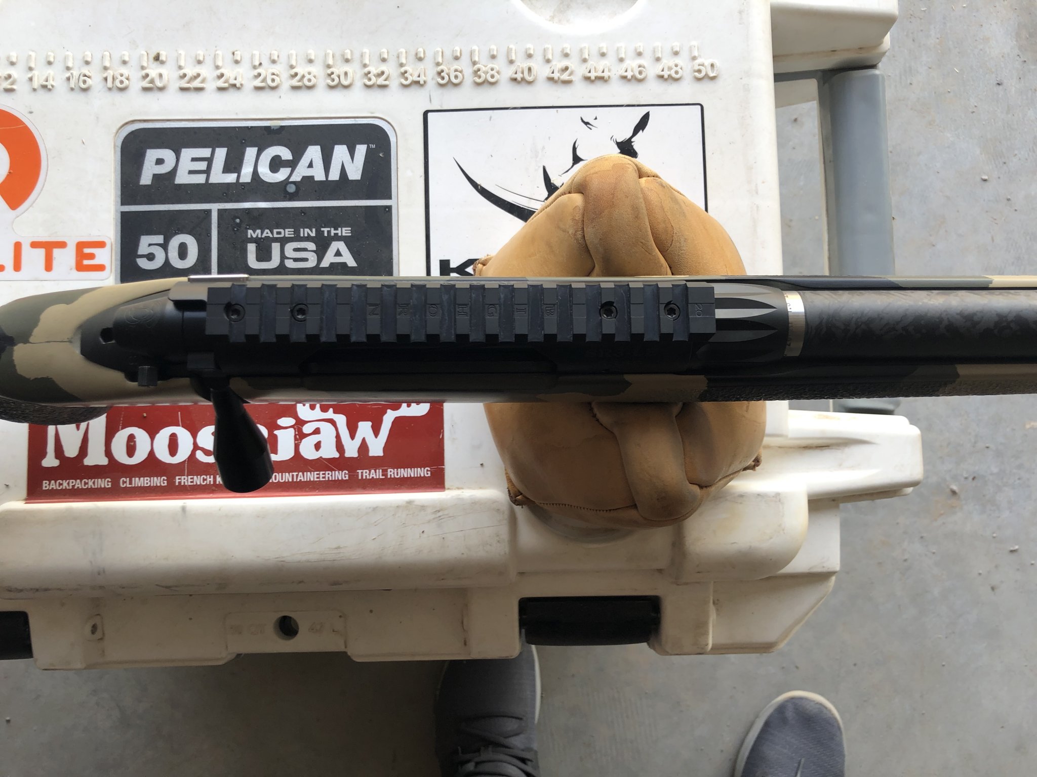

This is Nuke short action, AG composite adjustable stock, 26" sendero proof, Mesa Precision M5 bottom meta, Accurate Mag 5 round, M10 rings, MK 5 3.6-18, TT special, Modular Evolution bipod, with pic rail up front for bipod and ARCA plate in front of magazine for tripod.
Detachable bm and light weight don't really go together. Adjustable stock adds more weight. How "lightweight" are we talking? I have LR hunting rigs that range from 8# to 12# scoped. The low side of that is the only thing I'd call lightweight. This build list you have here is going to be over 9# before it's scoped. That is not a lightweight hunting rifle.
I would like to get under ten pounds when all said and done.

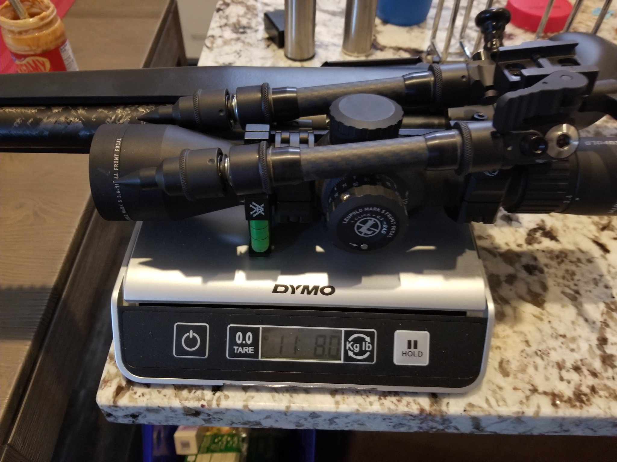

Ok so I got it weighed, bare rifle minus optics and bedding, im at 7 pounds 12 ounces. I also have a 4 inch pic rail up front instead of sling swivels. Should be 8 lbs after bedding. looking at a nx8 and NF UL rings should be about 10 pounds which is great for me. I could have saved wieght on the stock going edge fill and a non adjustable stock, but I wanted GAP camo and they dont offer that with edge fill. Hope this helped.
Reactions: BrentlyWhite
Very nice that is the weight I am shooting for. How about a picture would like to see your rifle.

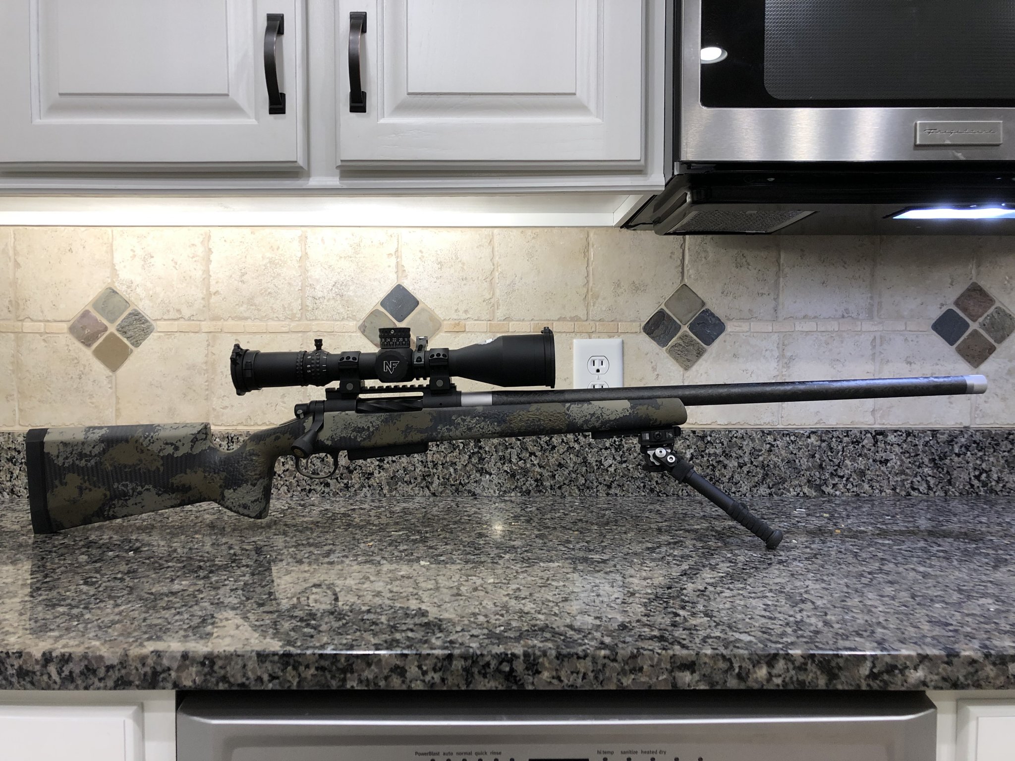

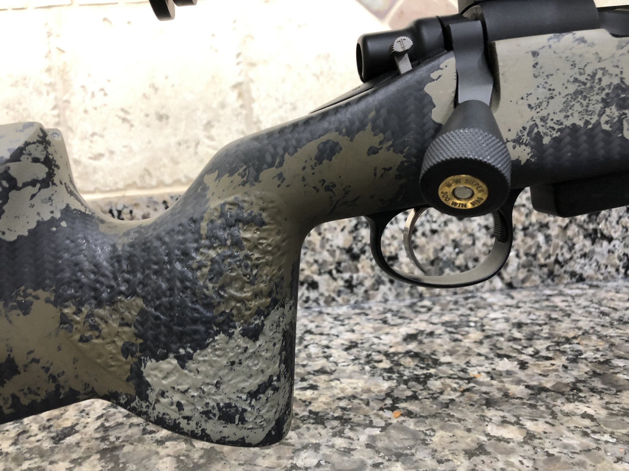

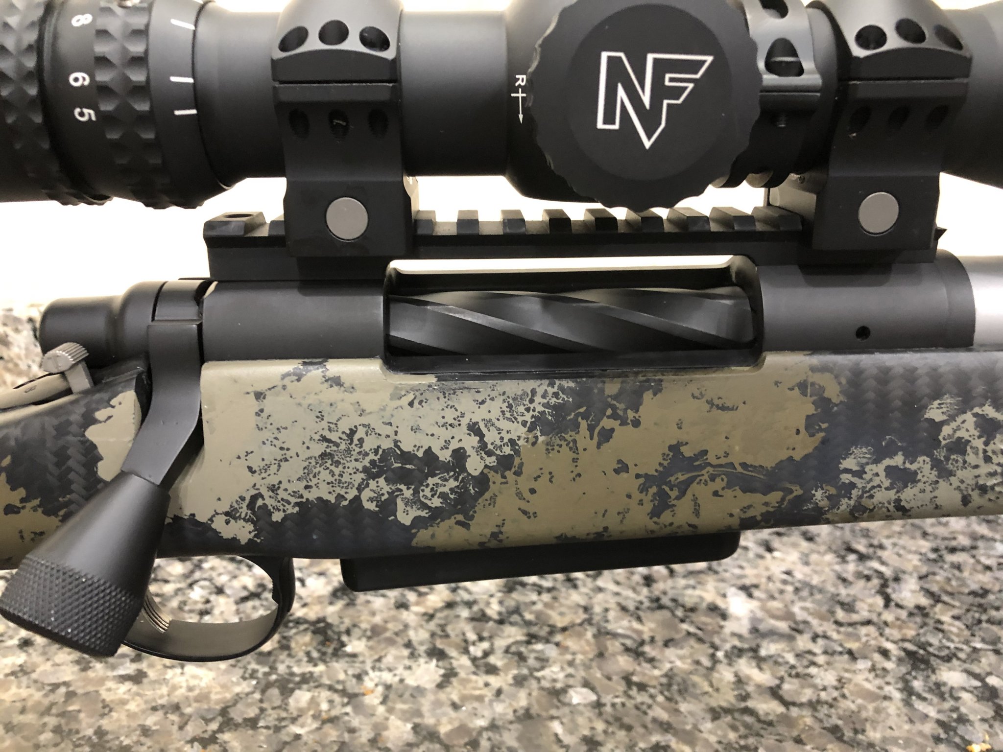

I had a similar idea. Ended up with a TL3, proof 26" 28 nosler, TT Special, EH1 with CIP mini chassis and an AMG. Couldn't be happier with it. Shooting 195's, loaded to 3.730" (with room to spare in the mag) at 3030 fps with Retumbo. Weight with scope/rings and empty mag was just under 10lbs if I remember correctly.
If you go win mag, I would def recommend getting CIP DBM or Wyatt's box if you reload, to make sure you have plenty of room. No reason to hamper yourself with COAL when you are building a custom.
ETA: If you order direct from Bighorn, get the CIP cut on the action. If not, just let any gunsmith shave off some of the feed ramp. I didn't get a CIP cut, just the standard long action, and sometimes when feeding from the mag the tip of the bullet was getting caught under the feed ramp, I would have to tap the bullet with my finger to get it to clear. $80 for an hour's worth of gunsmith labor and its 100% reliable now.

I have changed my mind on the Stock. I love the XLR Element 3.0 Magnesium Chassis with Carbon Fiber Butt Stock and Grip. At less than 30 0unces its hard to pass up. I did the math and the rifle without scope would come in at around 6.6 pounds. With a Lone Peak Ti action is comes in at around 6 pounds.

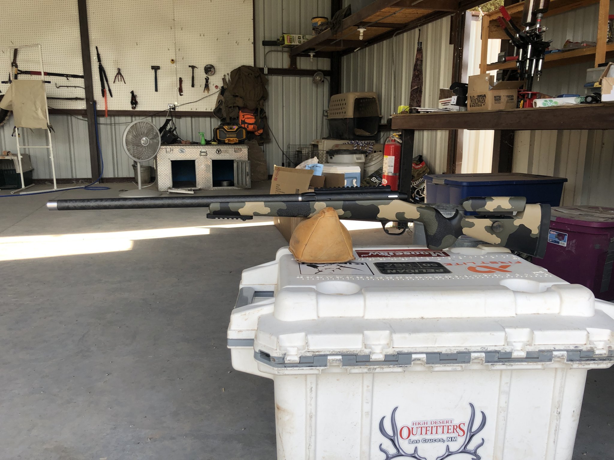

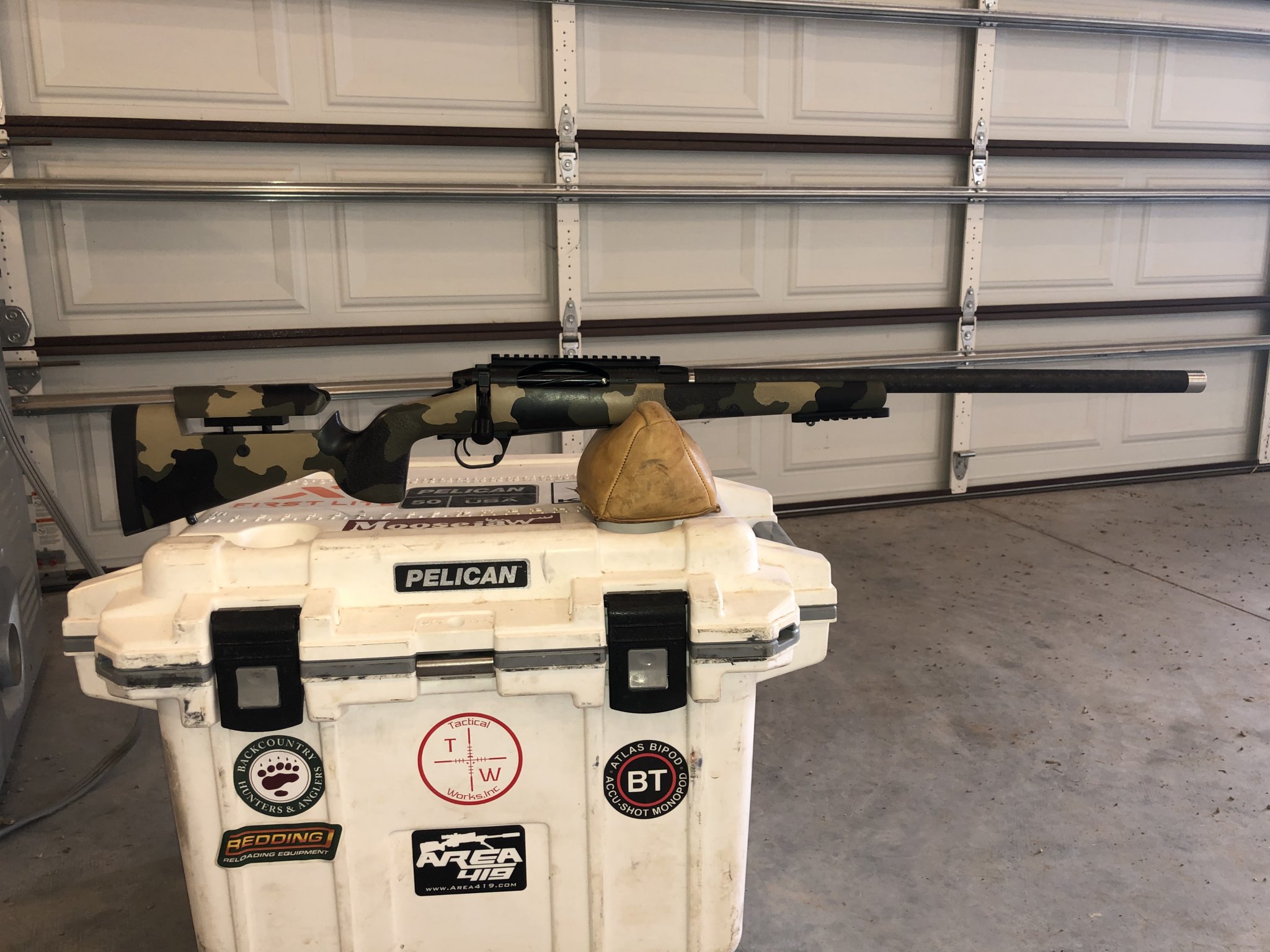

I did a similar build. The 300 Wm chambered with the Rhian Manthis reamer from PTG is badass if you plan to shoot the Berger 215s. I am running mine right at 3100 FPS out of a 26” Proof barrel. I highly suggest the HS Precision DBM as it fits mostly flush and allows you to load the 215s plenty long to get that 3100 velocity. Here is a pic of the build.
I did a similar build. The 300 Wm cambered with the Rhian Manthis reamer from PTG is badass if you plan to shoot the Berger 215s. I am running mine right at 3100 FPS out of a 26” Proof barrel. I highly suggest the HS Precision DBM as it fits mostly flush and allows you to load the 215s plenty long to get that 3100 velocity. Here is a pic of the build.
215s at 3100?? WOW! what load if you don't mind telling?
