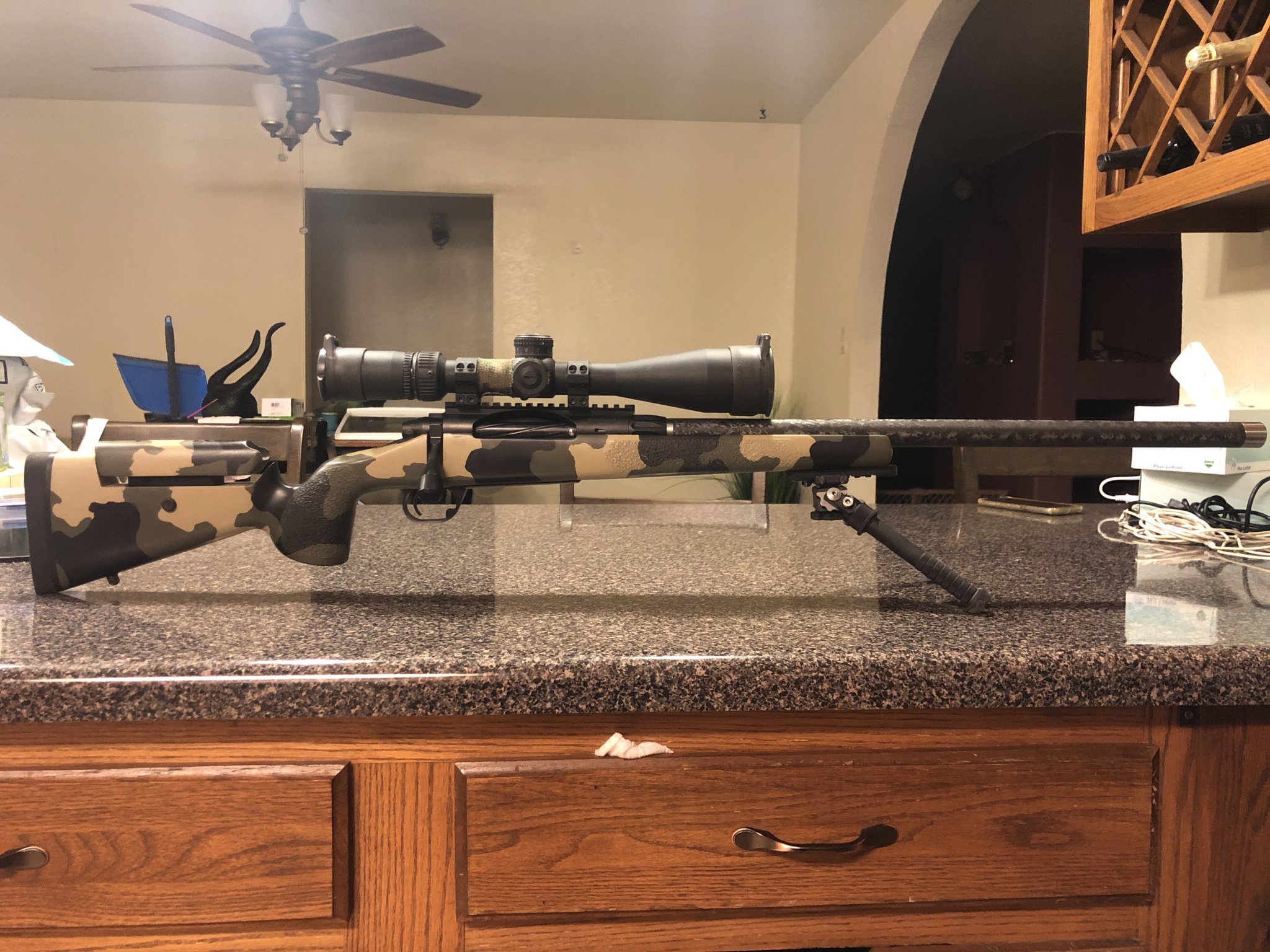

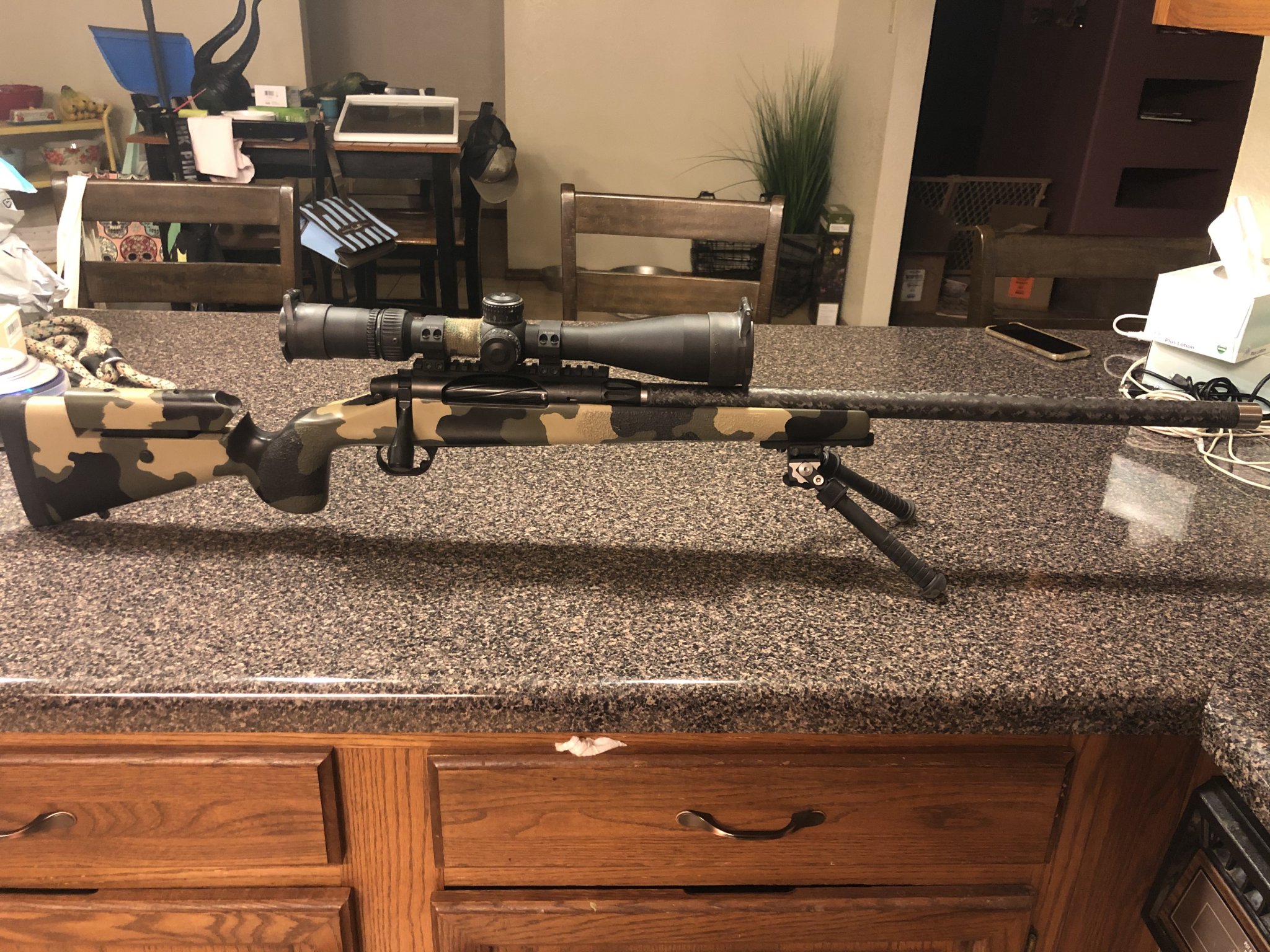

I've got my rifle being built right now, expect it to be around 8.5 pounds unloaded, but at a maximum of 9 pounds if weights aren't as advertised.
6.5 SAUM - 0.180 freebore done by TS Customs
Lone Peak Fuzion Ti - medium length w/ Wyatt's extended box: 24 ounces
Manners EH-1, BDL, no mini chassis, w/ 1 sling stud rear, atlas rail front: 28 ounces
Hawkins BDL w/ Wyatt's box: 4 ounces?
24" Proof Sendero Light: 45 ounces
Insite Arms Heathen Lite Brake: 1.1 ounce
Bix'n Andy Tacsport: 3 ounces
Hawkins ultralight rings: 3 ounces
Tangent Theta 3-15 Marksman: 28 ounces

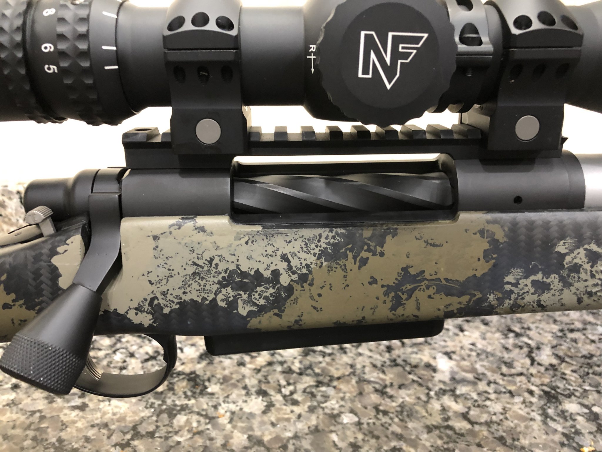

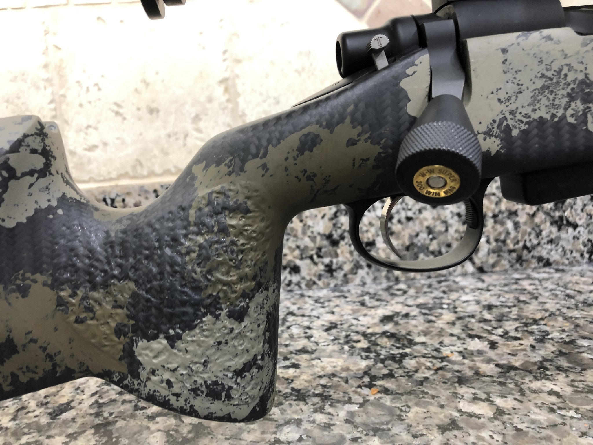

I went with the AG Adjustable Chalk Branch, and it’s a good stock that only required minor fitting*. That said, I kinda wish I’d waited a month for the XLR Element Gen 3 magnesium/carbon to come out; it’s a full pound lighter, more adjustable, and the same cost once you account for the bottom metal, sling mounting, etc.
* Fitting required was:
  • Opening up the barrel channel for an ARC Barloc. Frustratingly, the barrel channel isn’t perfectly centered.
  • Opening up the ejection port for an ARC Nucleus.
  • Machining the bottom metal cutout about 1mm deeper to seat the magazines higher and ensure the bottom metal was flush. This is the one I’m annoyed I needed to do, because I specified “Hawkins M5 DBM” on my AG order.

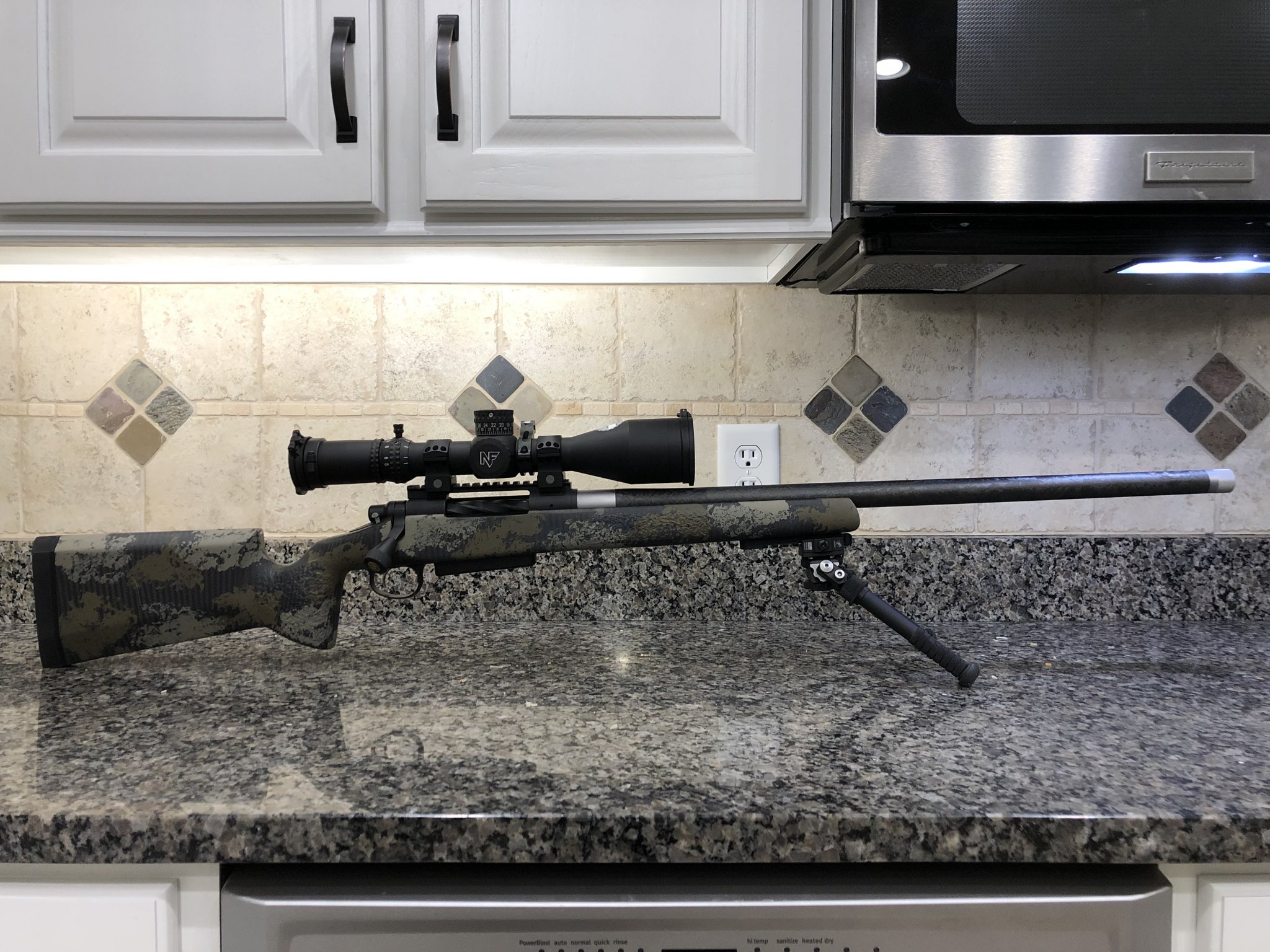

Well she’s done. As it sits with a razor amg 10 lbs 11oz. I could save quite a bit of weight by not going with the pic rail, atlas and adjustable cheek. Really happy with it. Now to get a load worked up.
