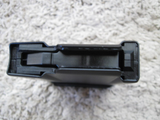

Accurate .223 Mag out of the box:

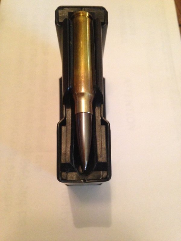

Accurate .223 Mag after modification. Not my picture, but a good illustration none the less. All the material removal is done on the front end only. I never heard about anybody bother modifying MDT or AICS .223 mags as they are already 2.50-2.55" long inside. accurate mags.jpg
