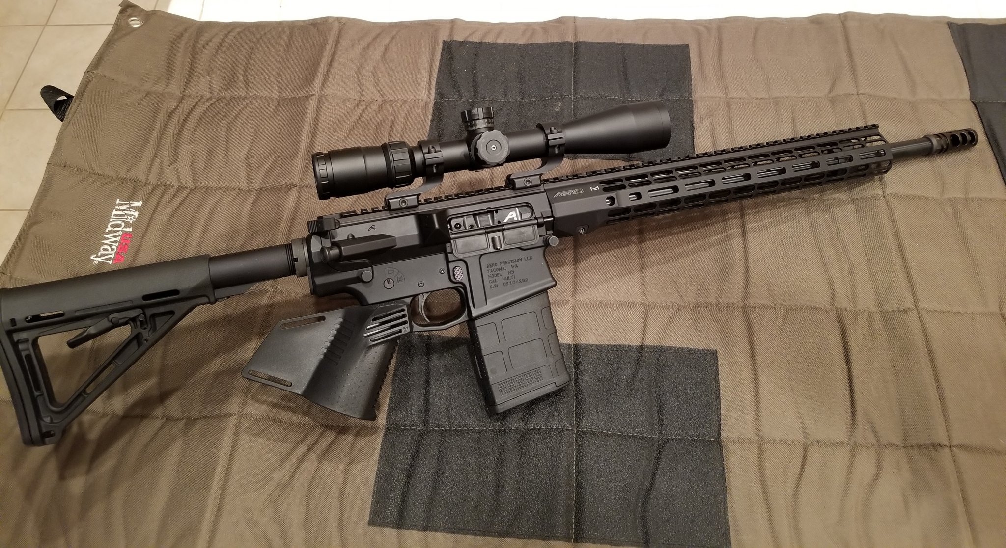

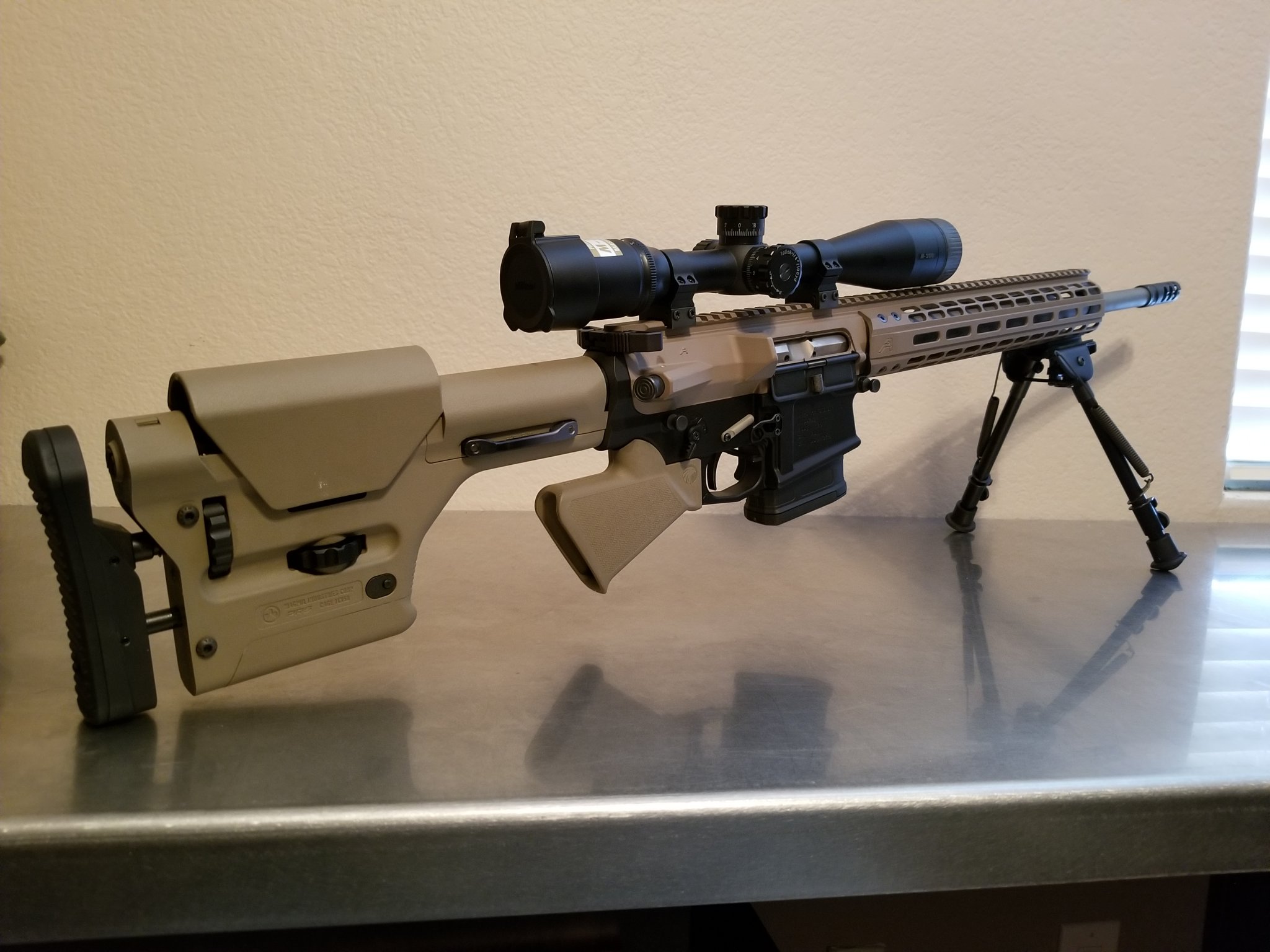

I built myself and my dad complete Aero M5 rifles and we love them. They both work great. Mine has the PRS so it's a bit heavier but his is not too bad. And we live in comie-fornia so they are featureless.
