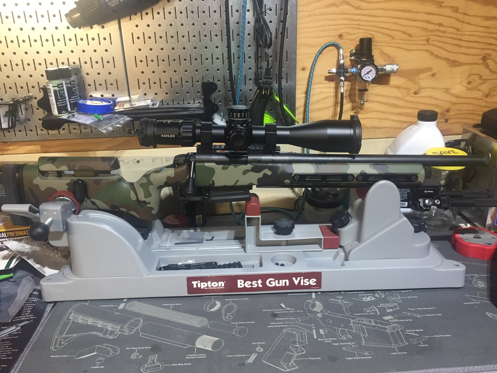

    I went the decked out Bergara route and worked at saving where I could. Took advantage of sales on the Grayboe stock, TT Diamond and stalked the exchange for a used Kahles. Saved me $1100 vs. a V-22 and if I decide I must have a Vudoo, I already have everything to slap on the barreled action and then sell the Bergara off.
