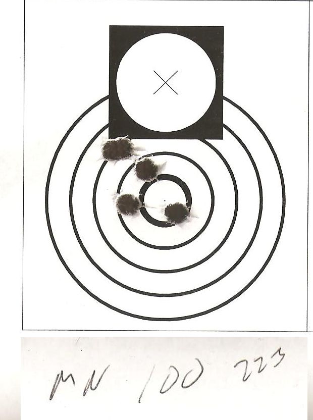

I have a dozen Mosin Nagants, the best accuracy / precision is the one I converted to .223.
I think most every cartridge has the same accuracy potential, but what really helps is a heavy rifle and a light bullets.
Mosin Nagant with Rem700 .222 barrel reamed out to .223 and manual magazine follower/ lifter.
13x40x40 Leupold vari x III left on 13X by mistake
12.5 pounds as tested
33-35 gr Vmax moly 15 gr Blue Dot 2.17" OAL
a) 0.87" 5 shot group at 100yards

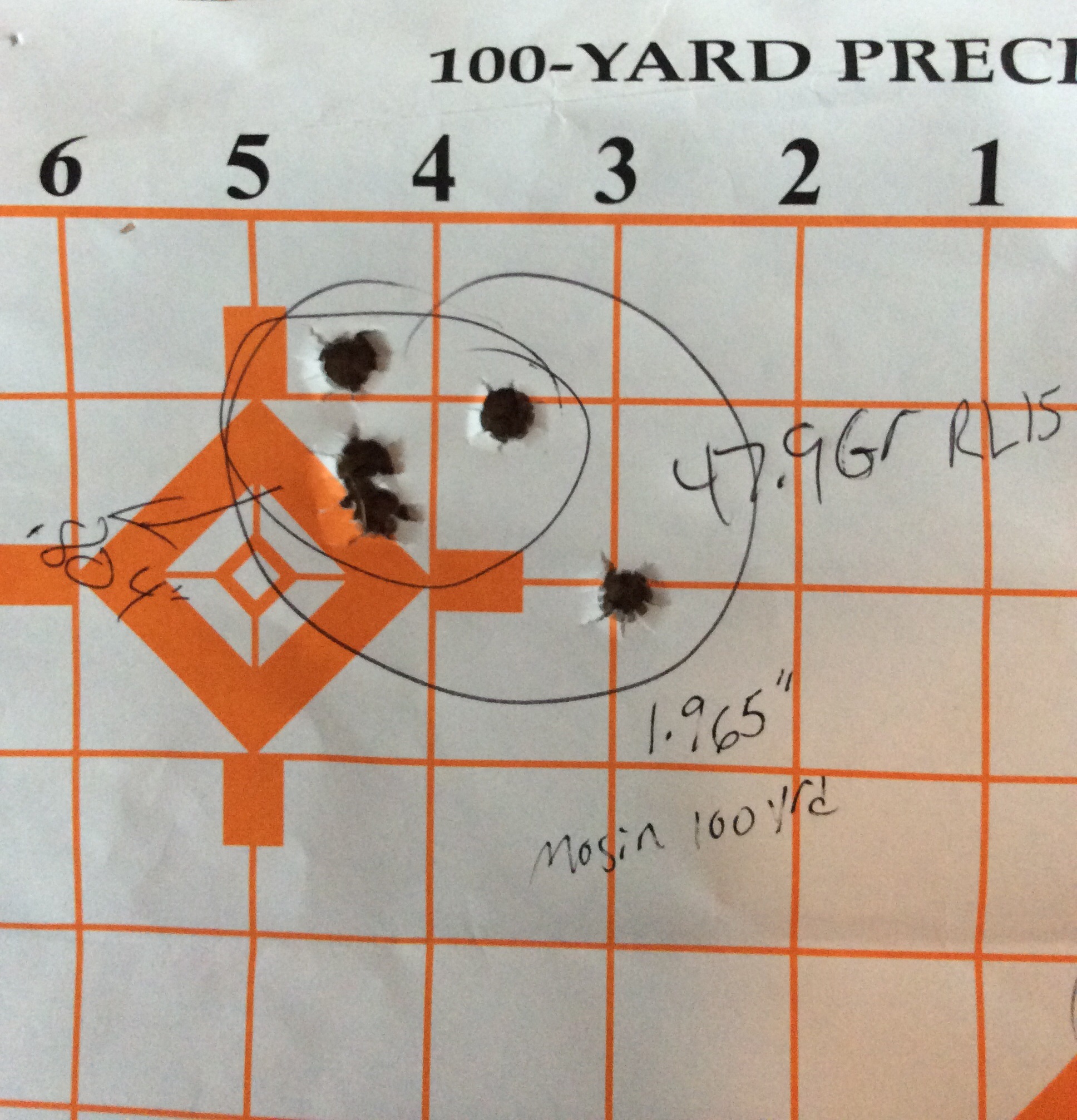

Ok I've worked up a load that cut my groups in half. Here's what I came up with. 47.9 grains of reloader 15' in privi brass, a cci primer, and a Speer 155 grain spitzer. Group size is 5 rounds 100 yards in 1.95". If I discount 1 round I think I pulled it's .804". Under 1 moa I'm really happy with that.
