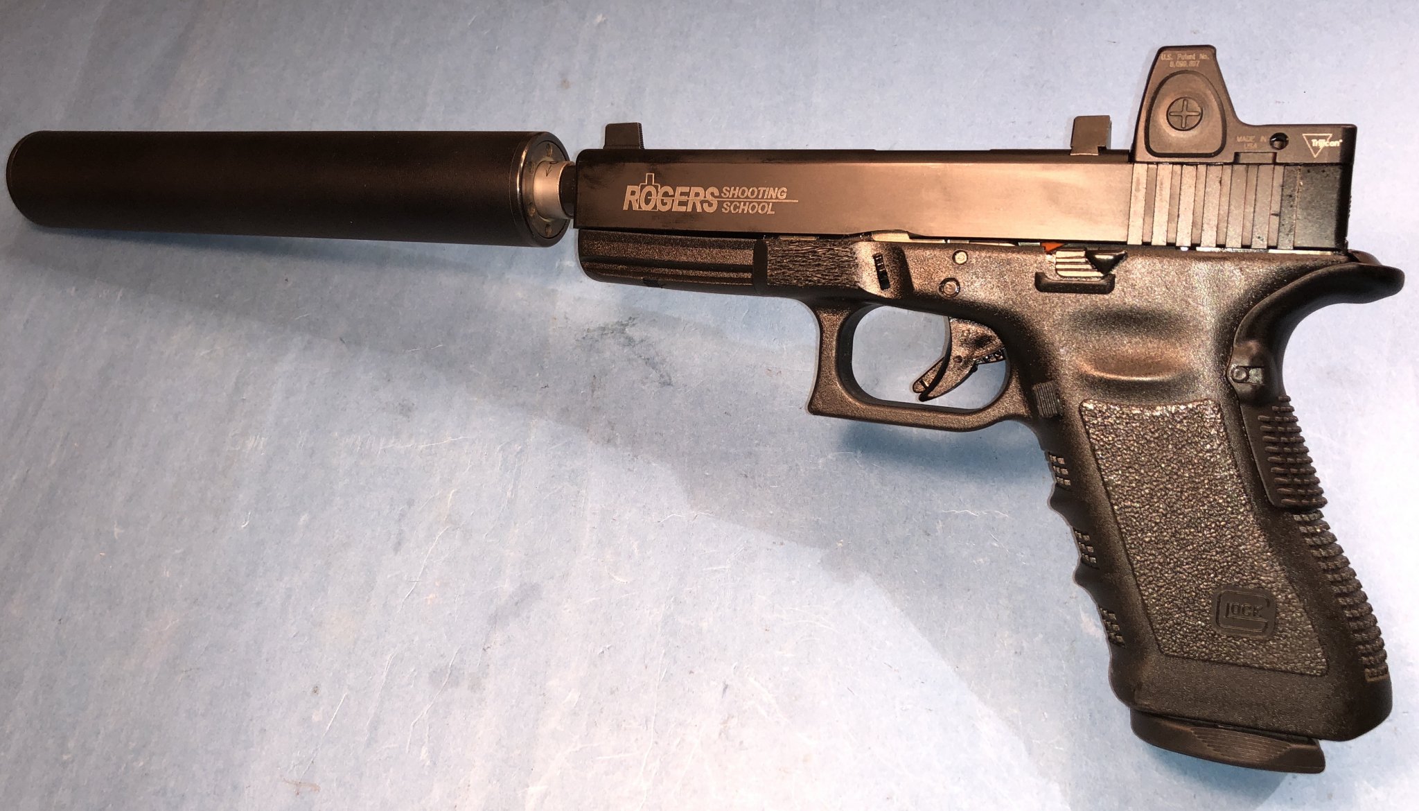

Ive had the Obsidian45 for a year or more now and love it. I shoot it on my G19, SIG P229 9mm, SA 1911 .45 and my custom built AR9. Now I cant speak much to improved accuracy because all of these guns are shooting replacement barrels. The G19 is shooting a custom run Lothar Walther threaded match barrel and it shoots tiny little groups with its RMR RM06. The SIG is hands down my favorite 9mm suppressor host. The balance is perfect. My favorite suppressor host of all my pistols is the 1911 .45. It is stupid quite with 230gr handloads at 826fps.
I did have to put the straight spacer into the can for the AR9 which sports a 7.5" 9mm Wilson SS match barrel. This is what I shoot the most with my Obsidian. Well I should say my son does, hes pretty much stole it from me. I handload for all these guns and you will find that different ammo shoots and sounds different. 147gr and up is where you want to be for 9mm ultra quite. I currently shoot Extreme 165gr RN with N340 and most people cant believe its a 9mm. All you hear is the action and it hitting steel like a 45.
Here's a video I took of a random guy at the range I let shoot my G19/Obsidian45/165gr sub loads. He never shot a suppressed gun before and had a blast.

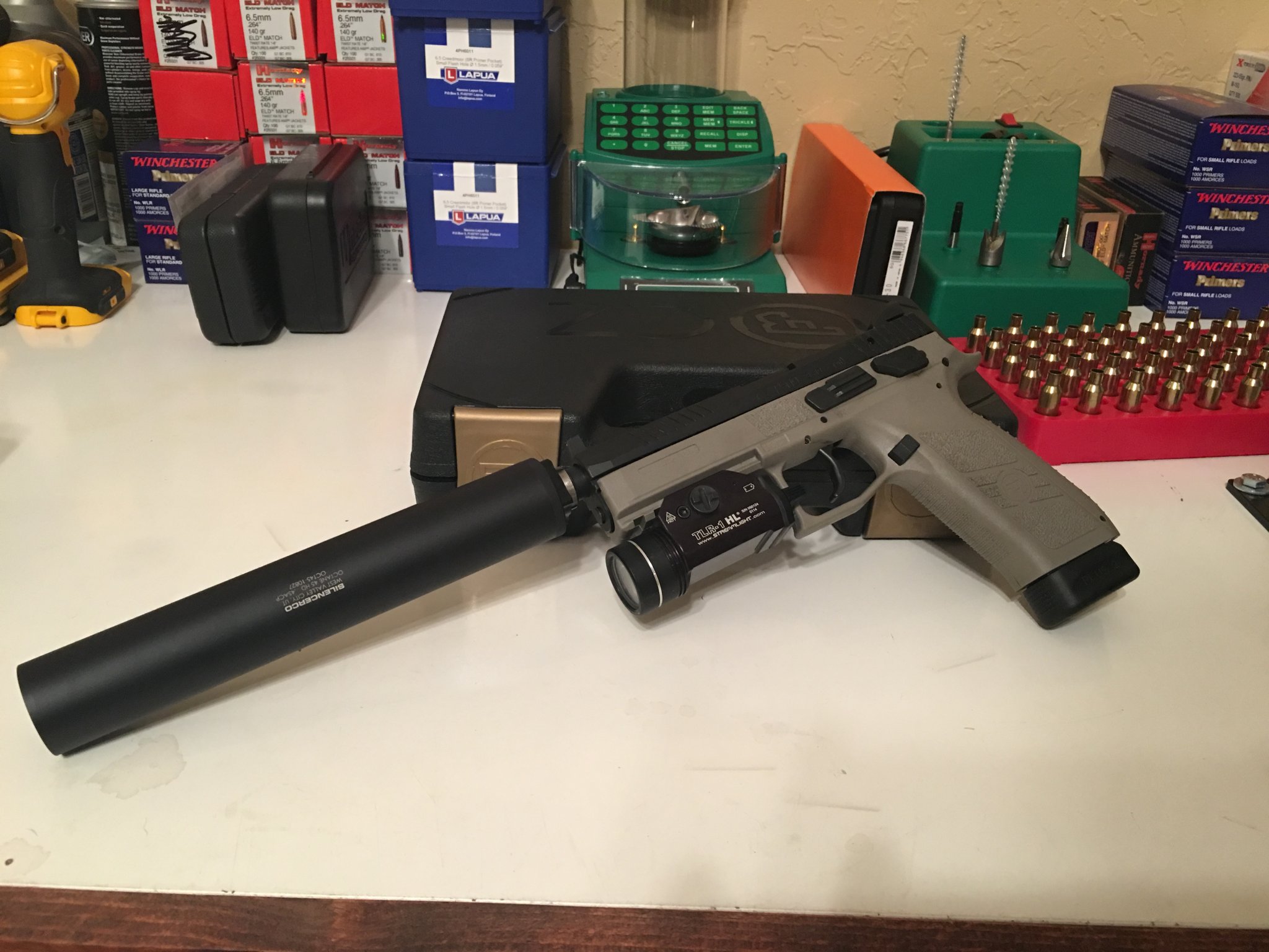

CZ P07, CZ P09, FN 509 Tactical
Or Dan Wesson Discretion ;)

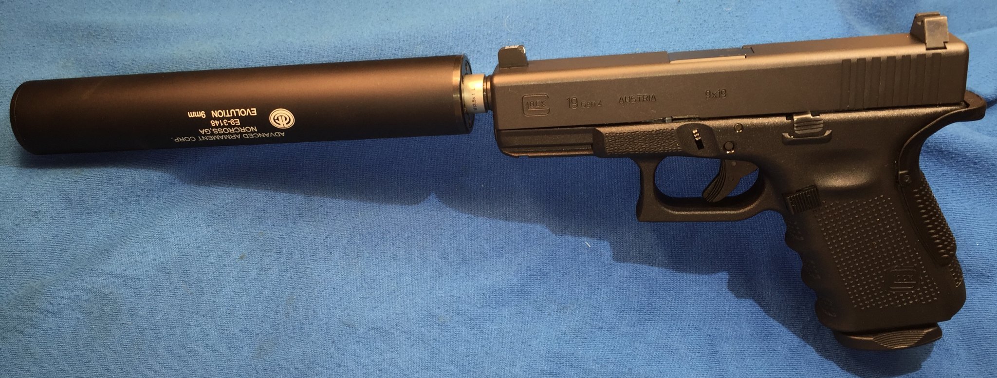

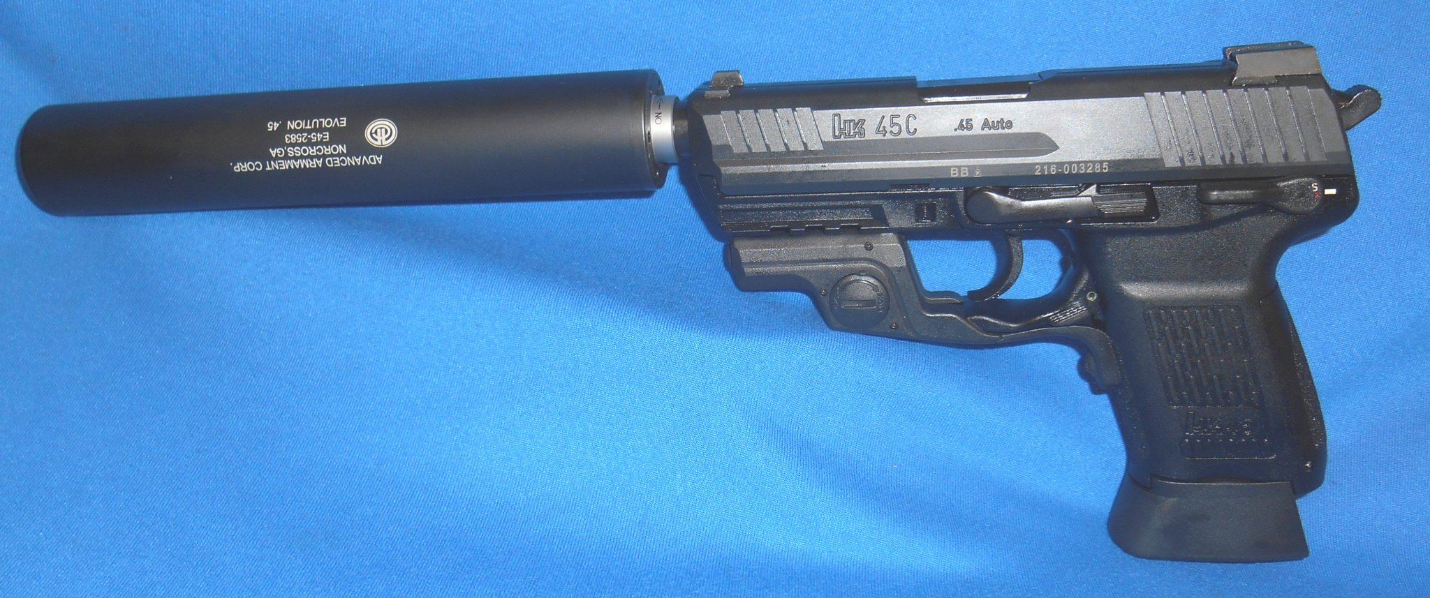

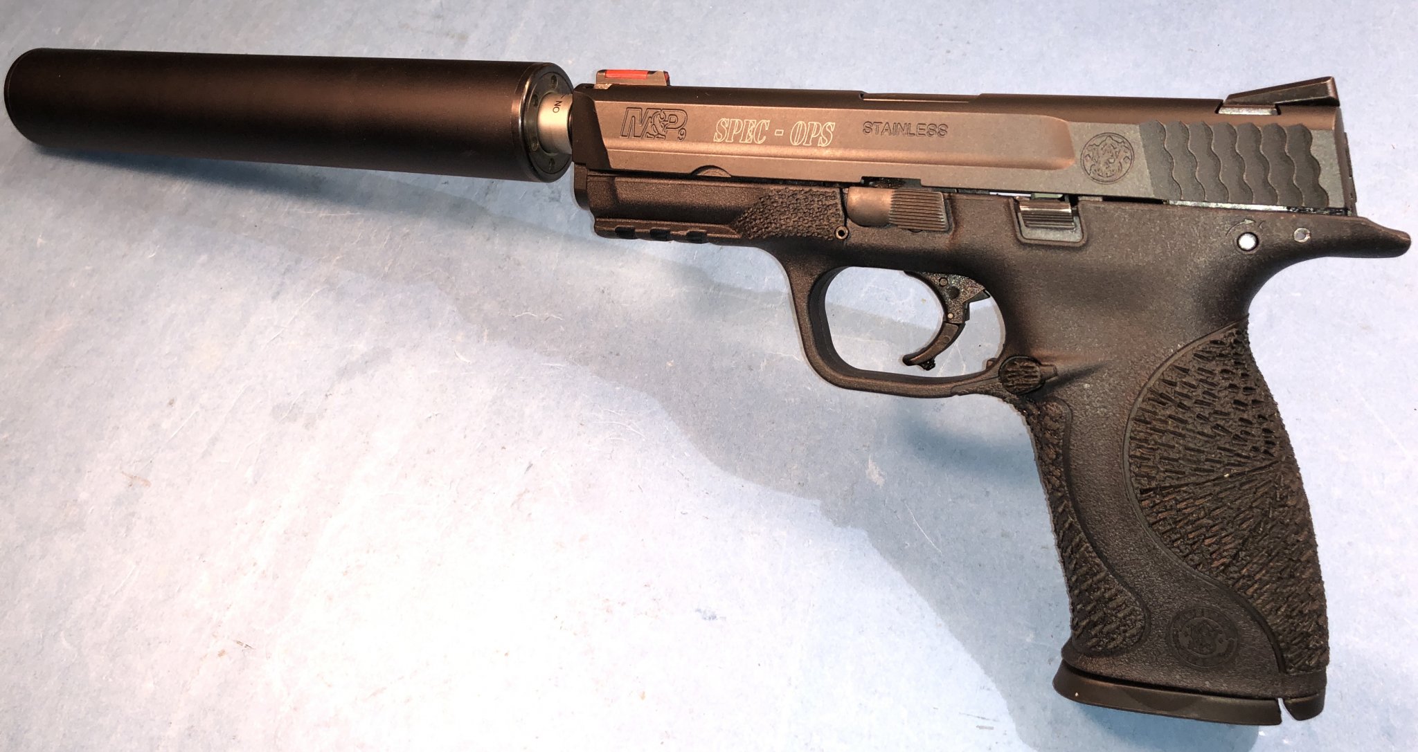

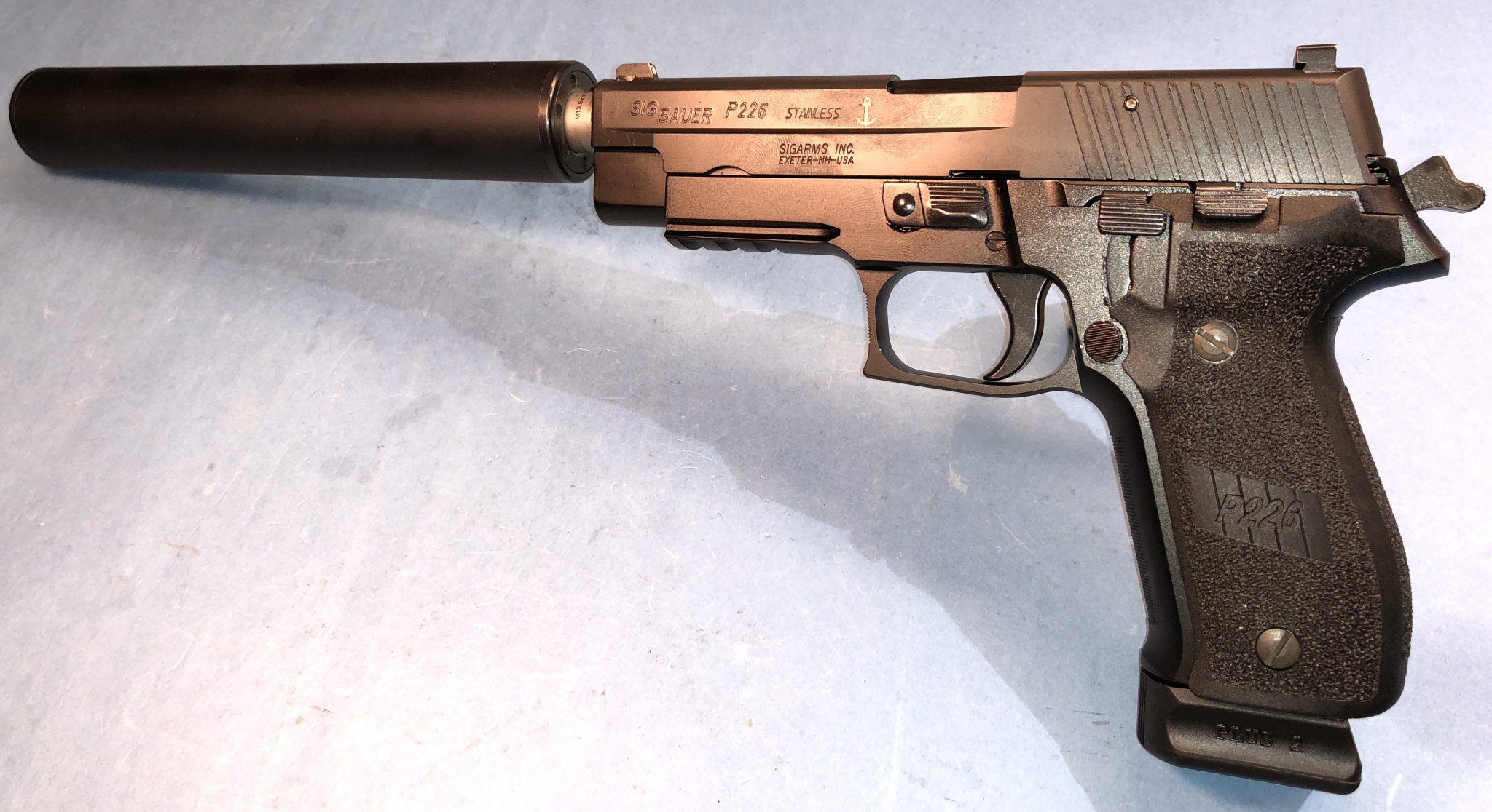

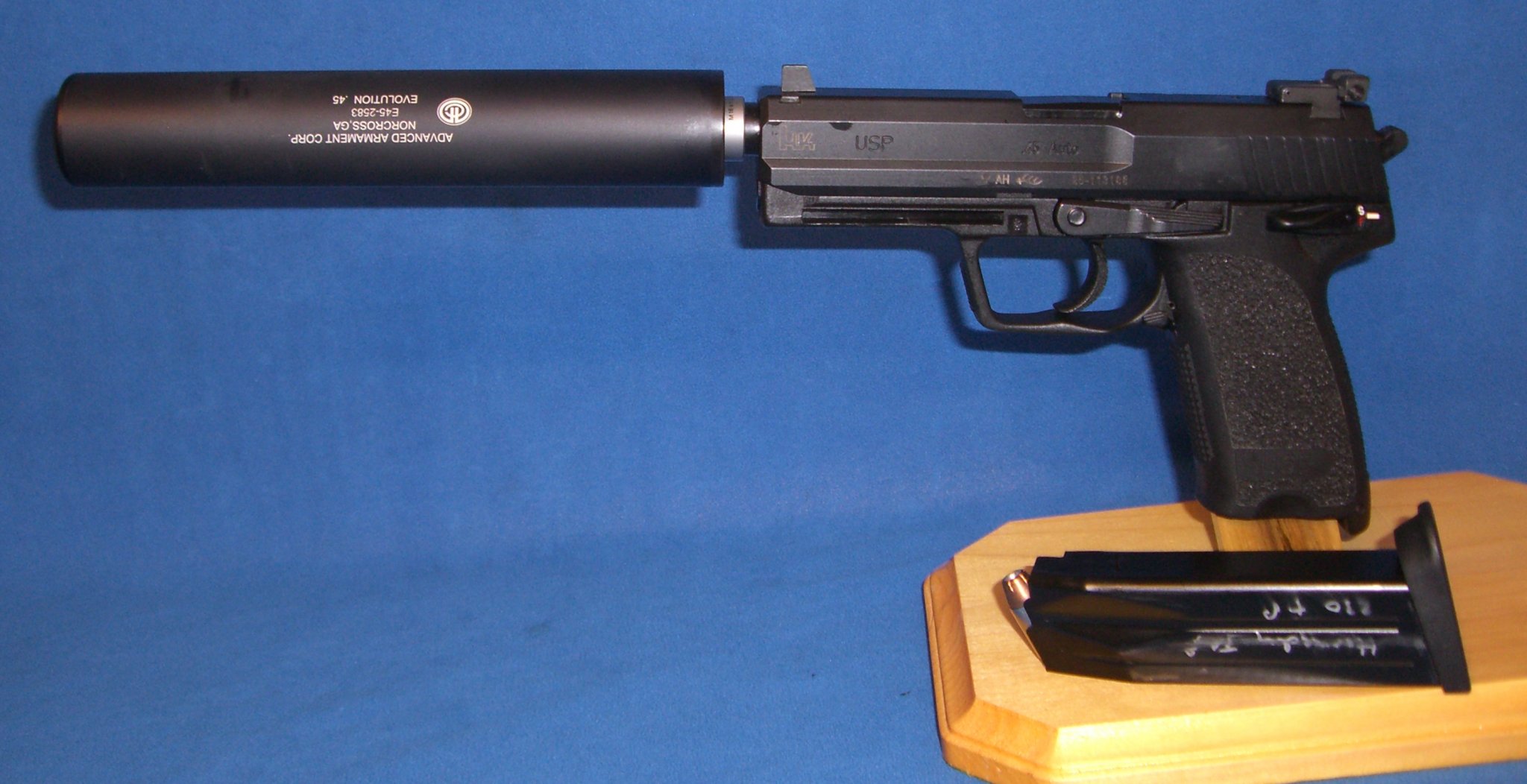

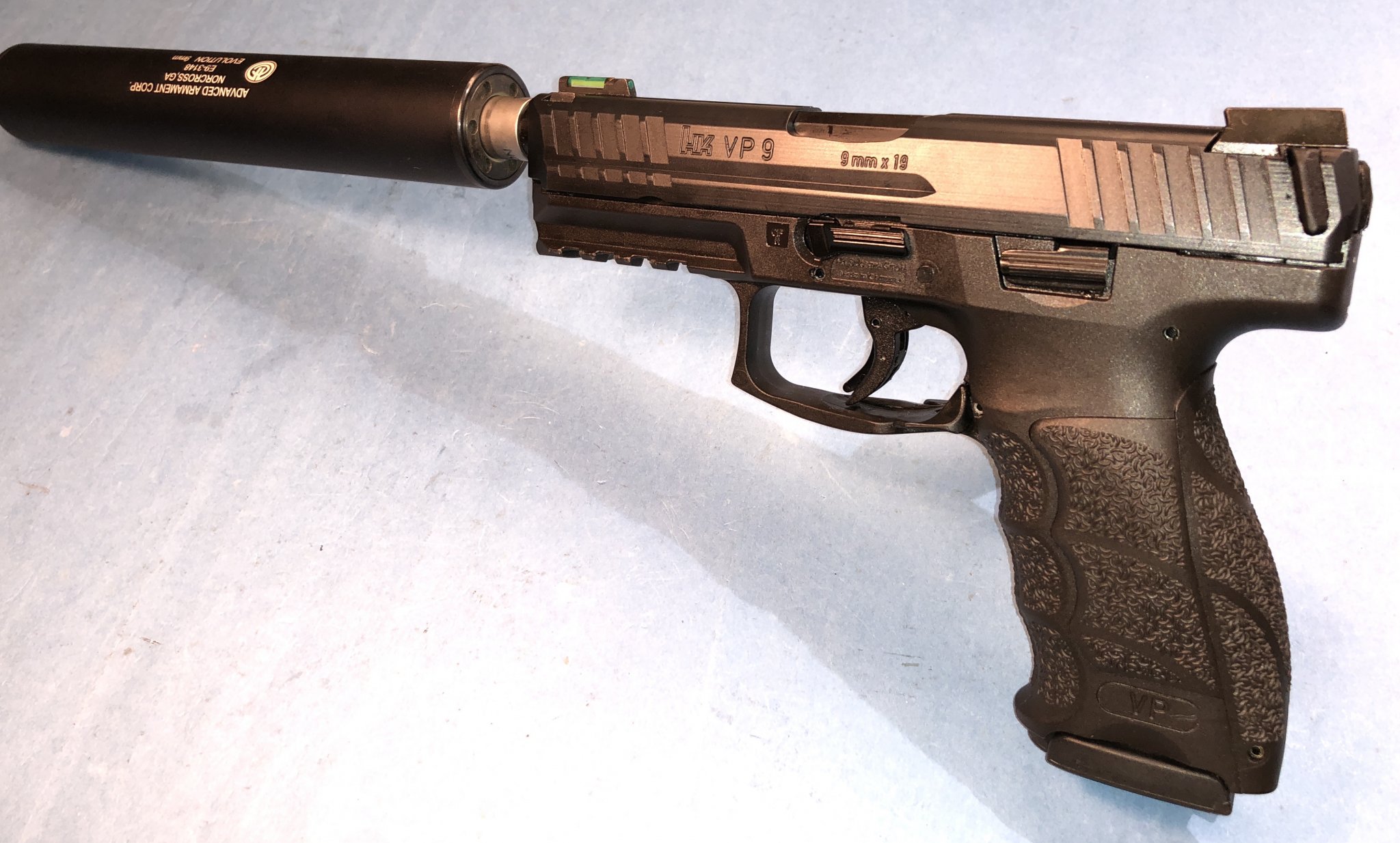

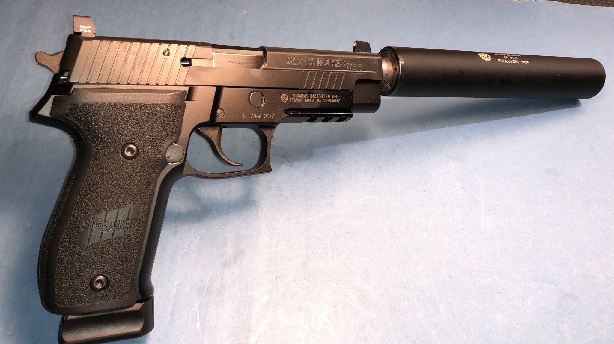

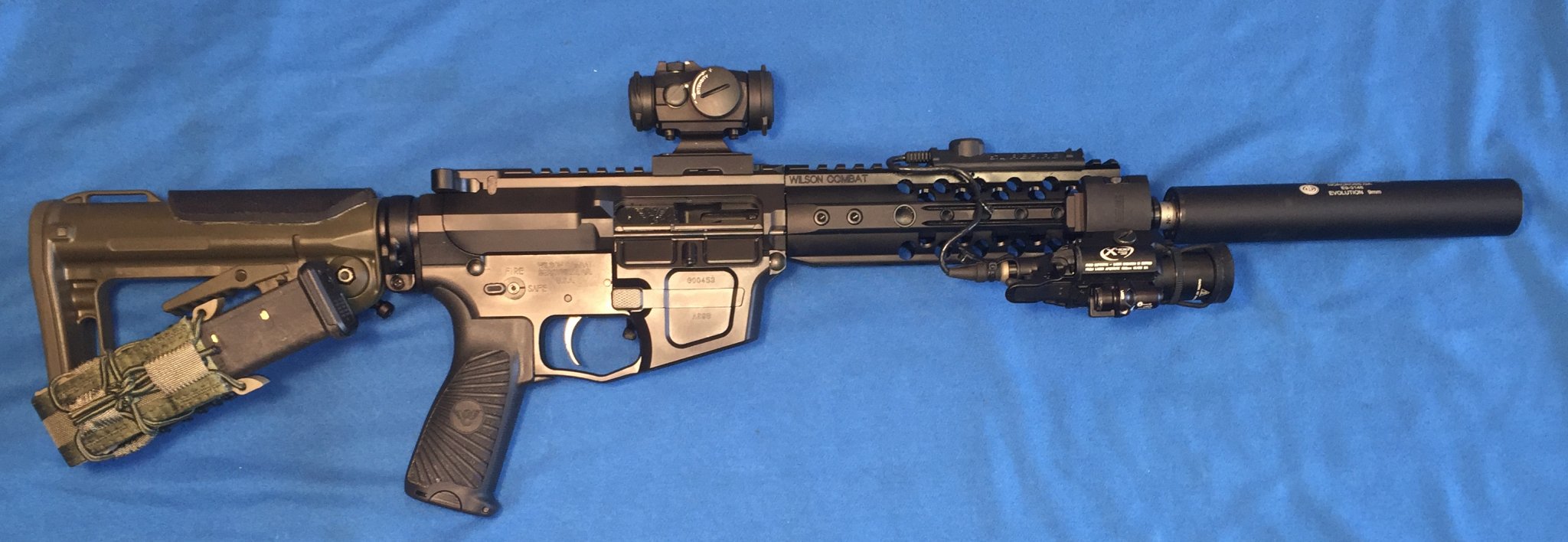

Some that I host on your list. My favorite is the HK 45 Compact Tactical. A polymer frame host is not a handicap. For fixed barrel e.g. Beretta M9 (I'll dig up those photos) variant just remove the booster spring from the suppressor as it is not necessary, just like with rifles e.g. this Glock-based 8" Wilson AR9 .
They are all fun to shoot and run reliably. Although not necessary, tall suppressor sights, laser or RDS make target acquisition much easier.
HK USP & Compact Tacticals; VP9
Glock 17 & 19
Sig 226 Navy & Blackwater
M&P9 SpecOps

That Wilson!!!!!!! Oh I love it!!!

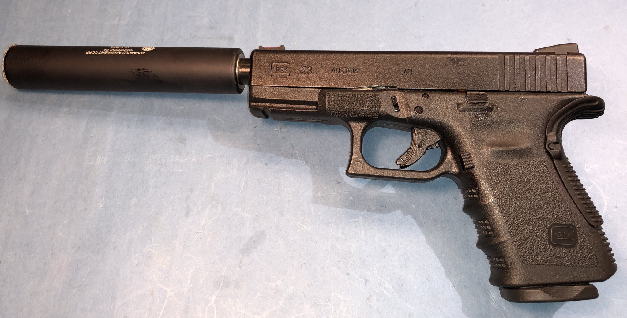

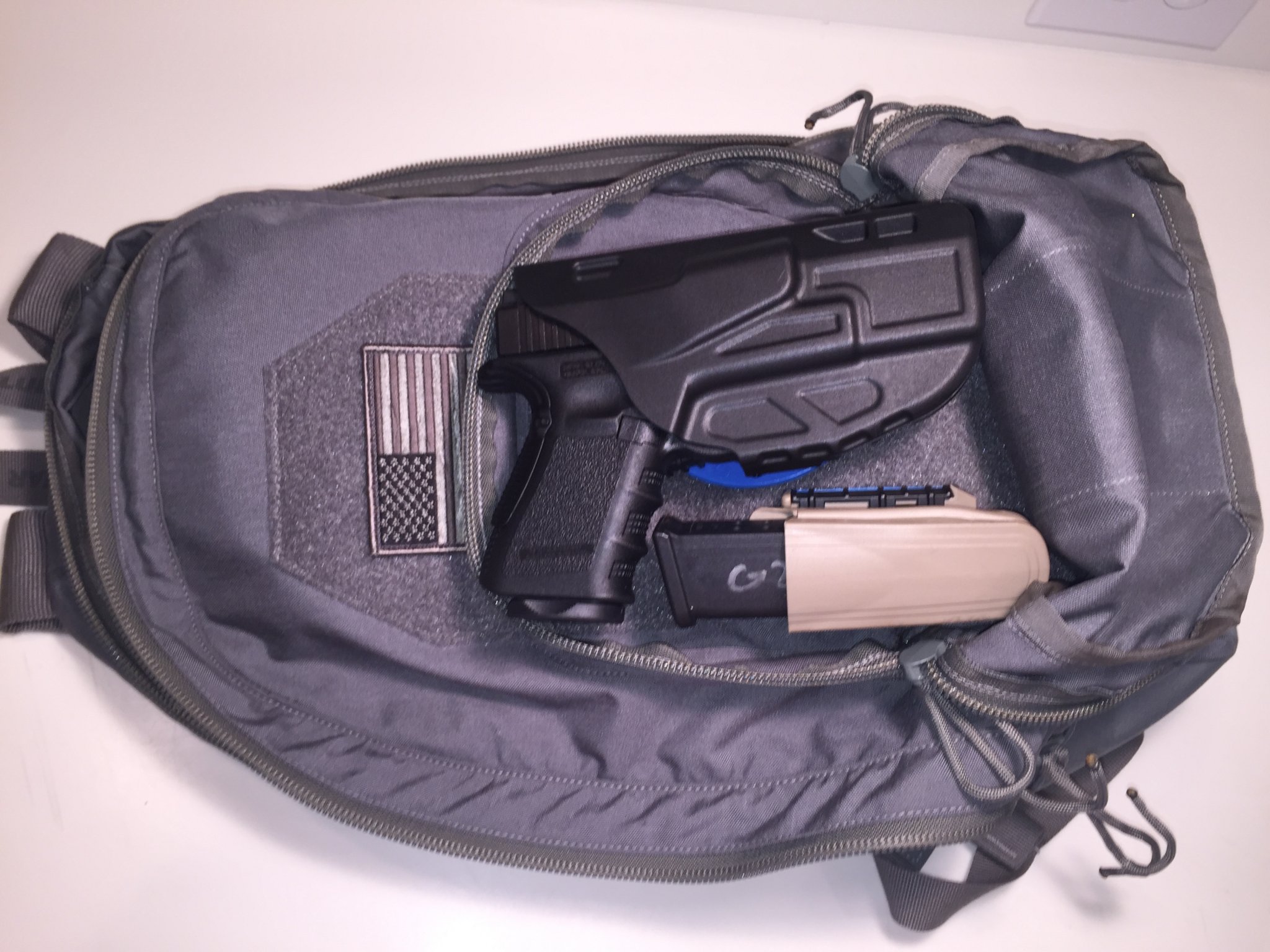

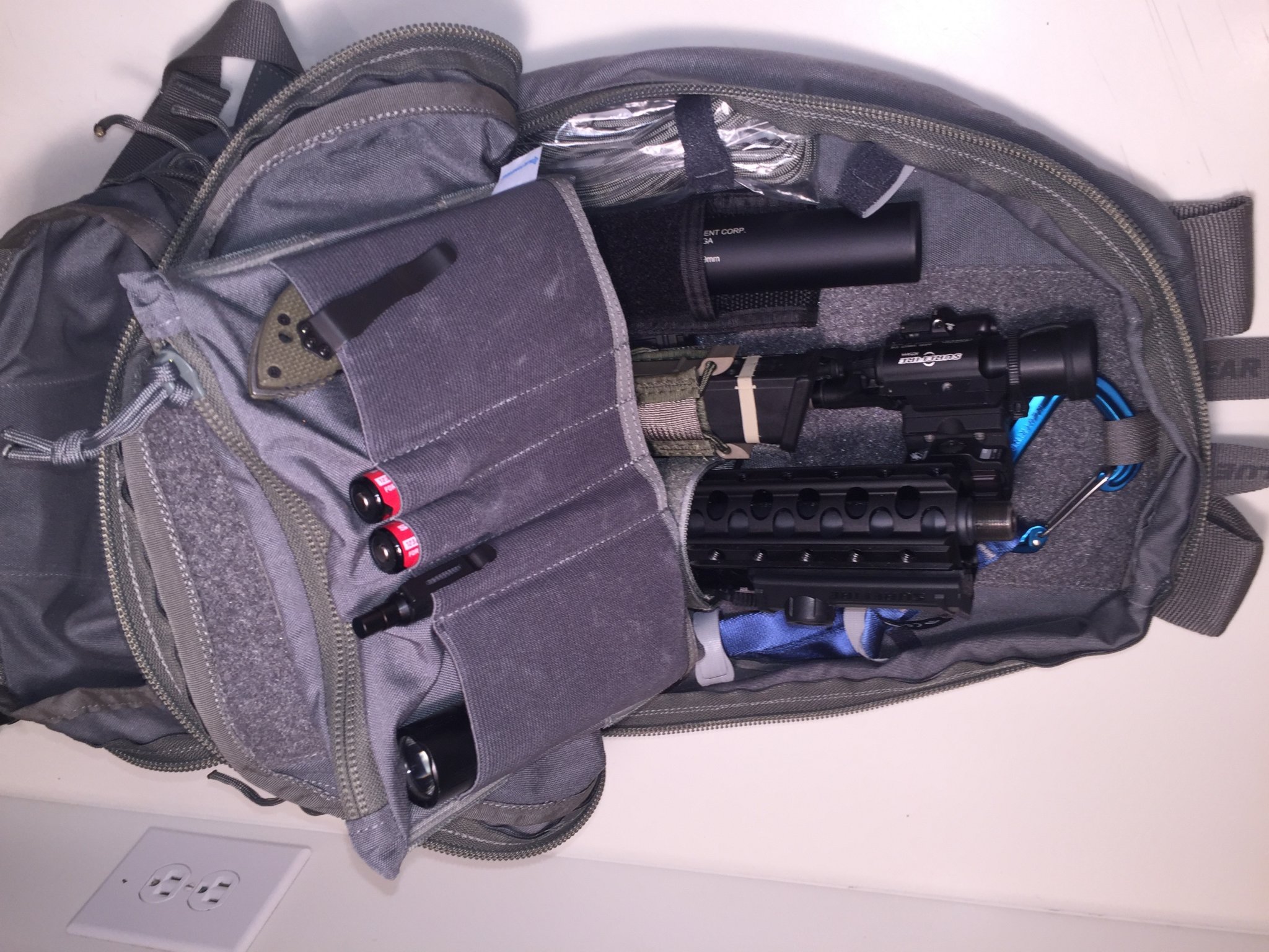

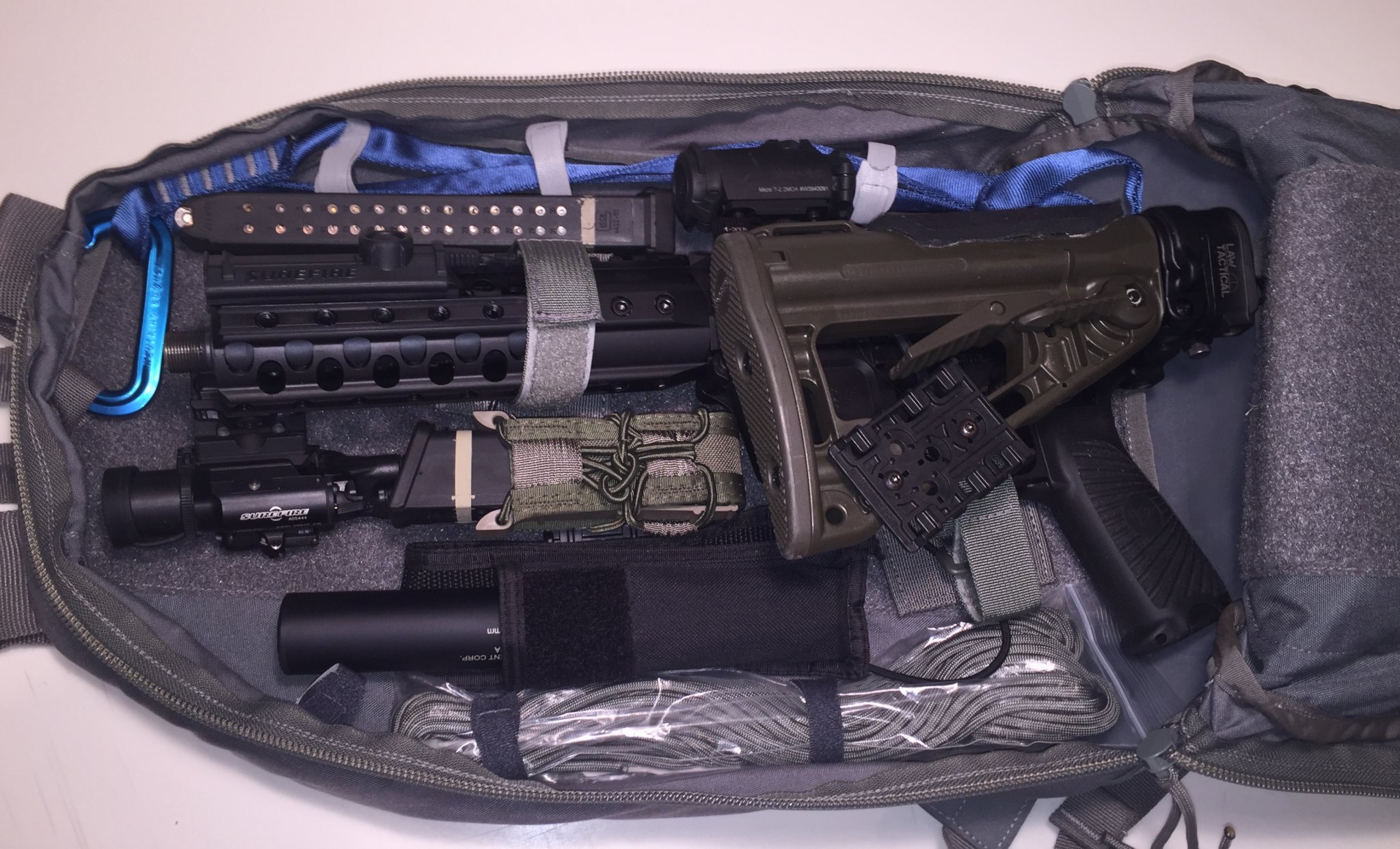

The Wilson is handy with the Law Tactical Gen3 folding stock as it fits in a small pack (Blue Force Jedburg shown) and
I can use the G19 / G17 or a 9 mm conversion barrel in my G23 for magazine commonality for the load out.
