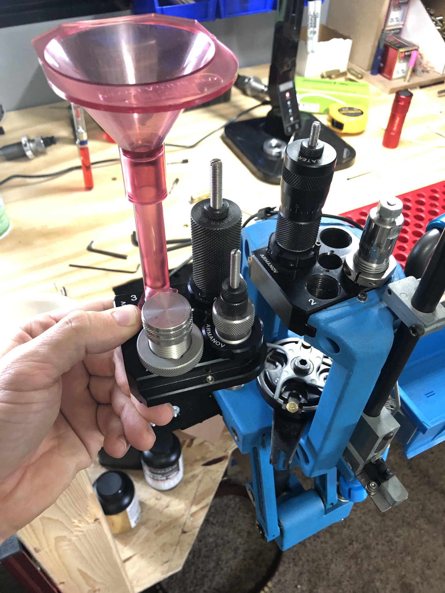

I'm gonna throw another vote in for the Dillon 550. Its all I use now for precision loads, albeit thats only 3 calibers currently. I also load bulk 223, 308, 9mm, and .357/38 on it.

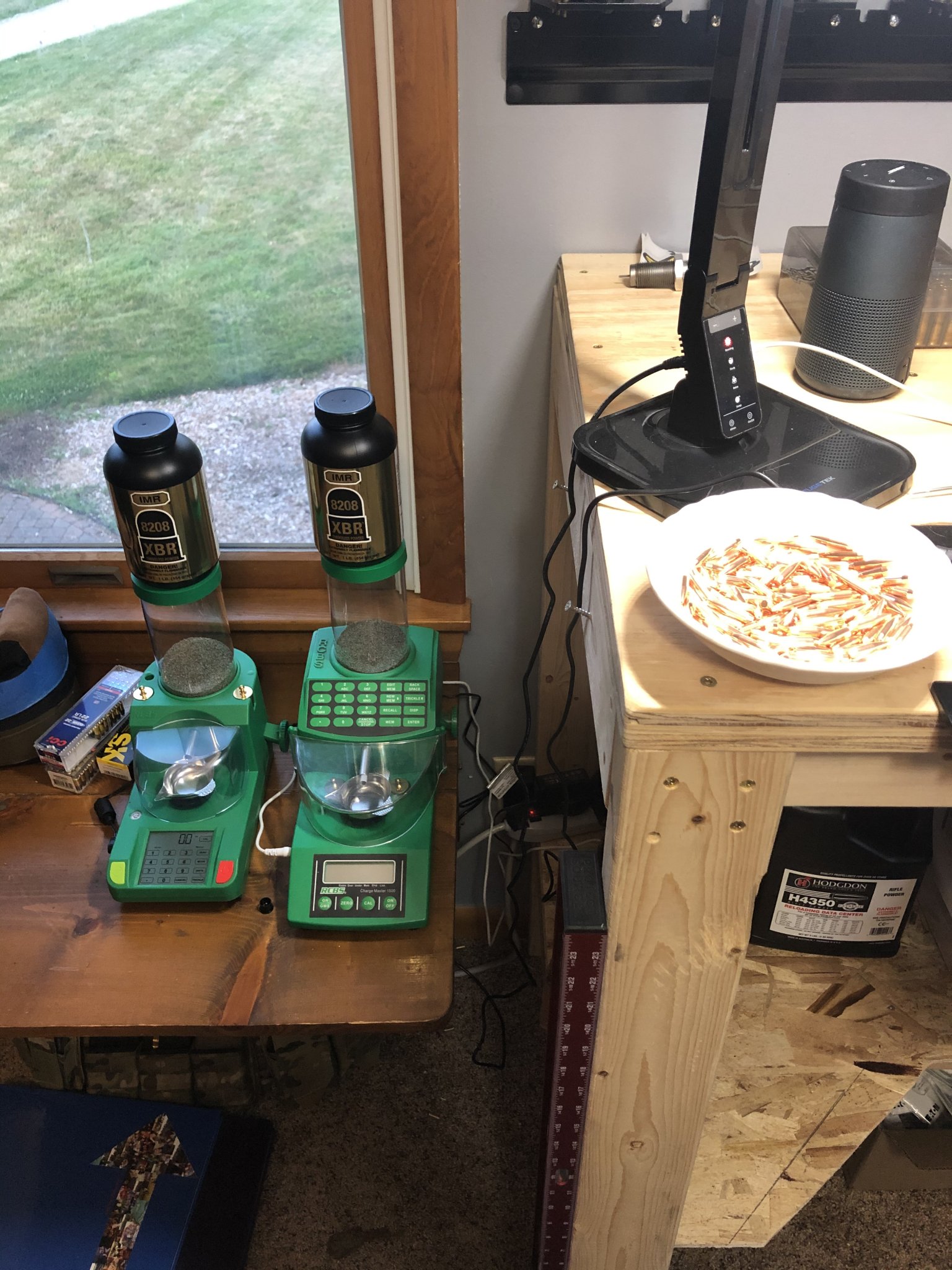

I went the route of 2 chargemasters set up on a side table. Together, I rarely have to wait. Occasionally my old chargemaster 1500 decides to not trickle a bit, but I'm currently setting up a little cheap trickler for when that happens.
This last batch of 200rds of 6.5cm I did all in one swoop. Threw my fired cases in a dry tumbler for an hour or so and then go to town:
-Lube 50 cases at a time
-Station 1 - deprime/size/prime (sized with a honed Forster FL die - no expander ball)
-Station 2 - Turning Mandrel - sets neck tension to 2.5 thou (checked with pin gauges)
-Station 3 - Manual dump powder from the 2 chargemasters
-Station 4 - Seat bullets
-Wipe cases off with towel
I use the Armanov locking/clamping tool heads w/ floated sizing and seating die. We'll see how good these 200rds perform compared to the last 350rds I did with a 2 tool head setup.
