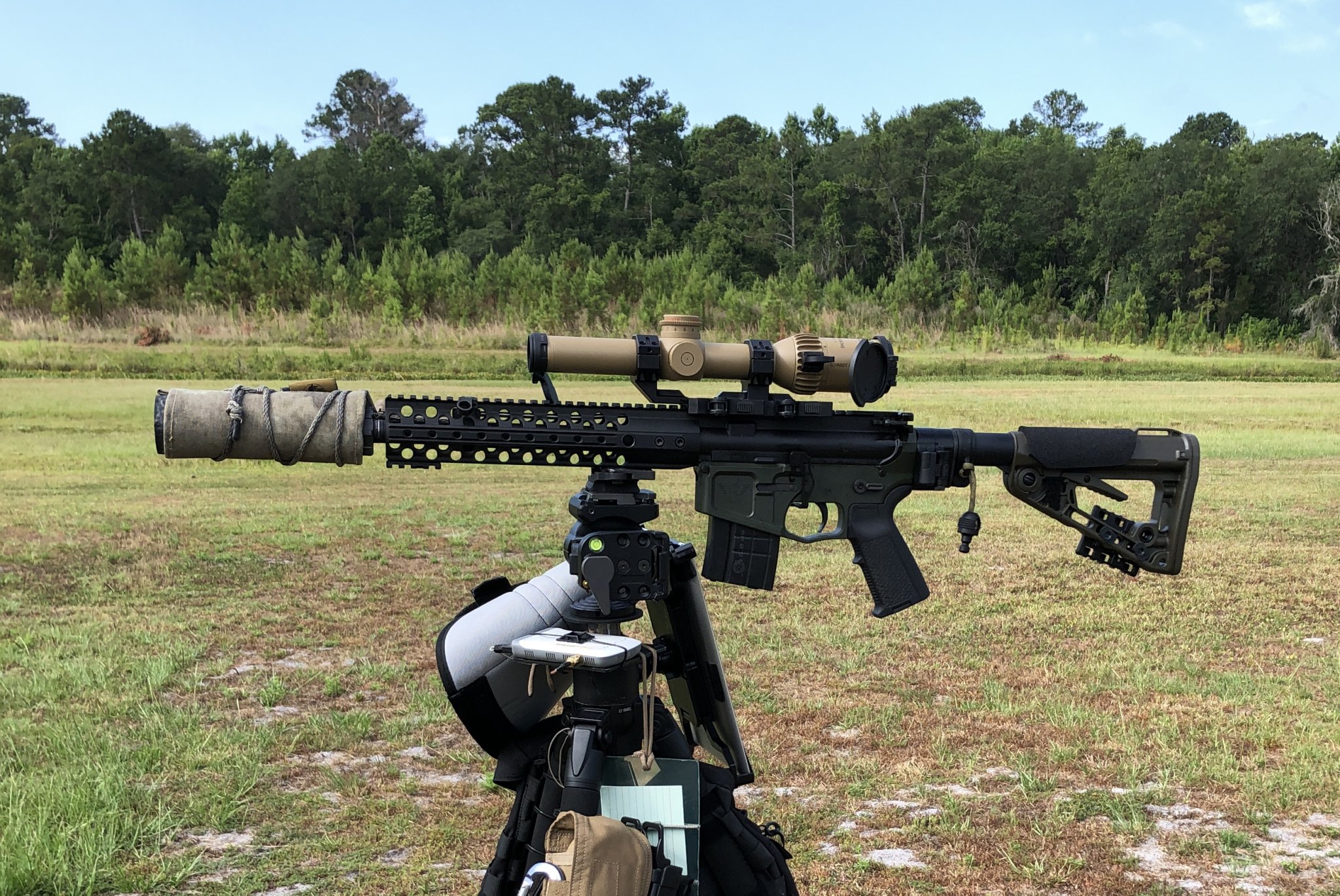

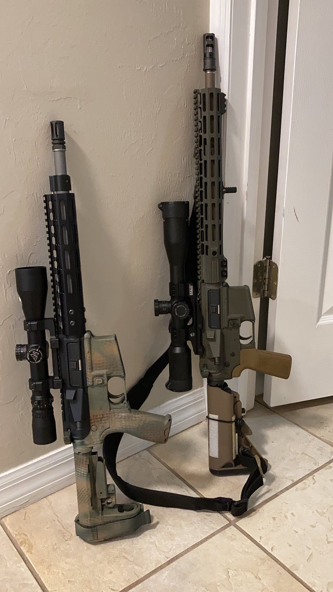

This is a pic from when I was experimenting with a 12.5" 6.5G upper vs my tried and true 16" 5.56 match rifle.
The 12.5" 6.5 option works well as a do all option. Low recoil. Handy. Decent terminal effects. Confidence on targets out to 800yds.
There's not a lot to complain about.

Looks great. was thinking 16" barrell, but will go shorter if accuracy won't be affected too much. Around how much does it weigh?
Guessing you build it yourself?

Accuracy is not affected. The thing shoots excellent.
It's a FCD upper and HG with Noveske barrel.
I'll weight it this week if I get a chance.

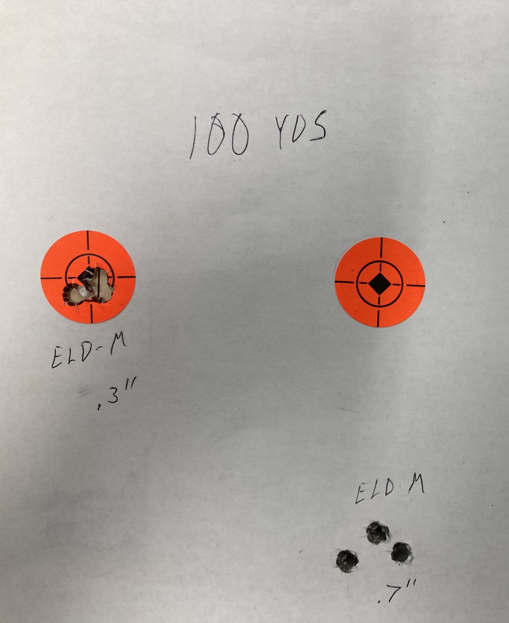

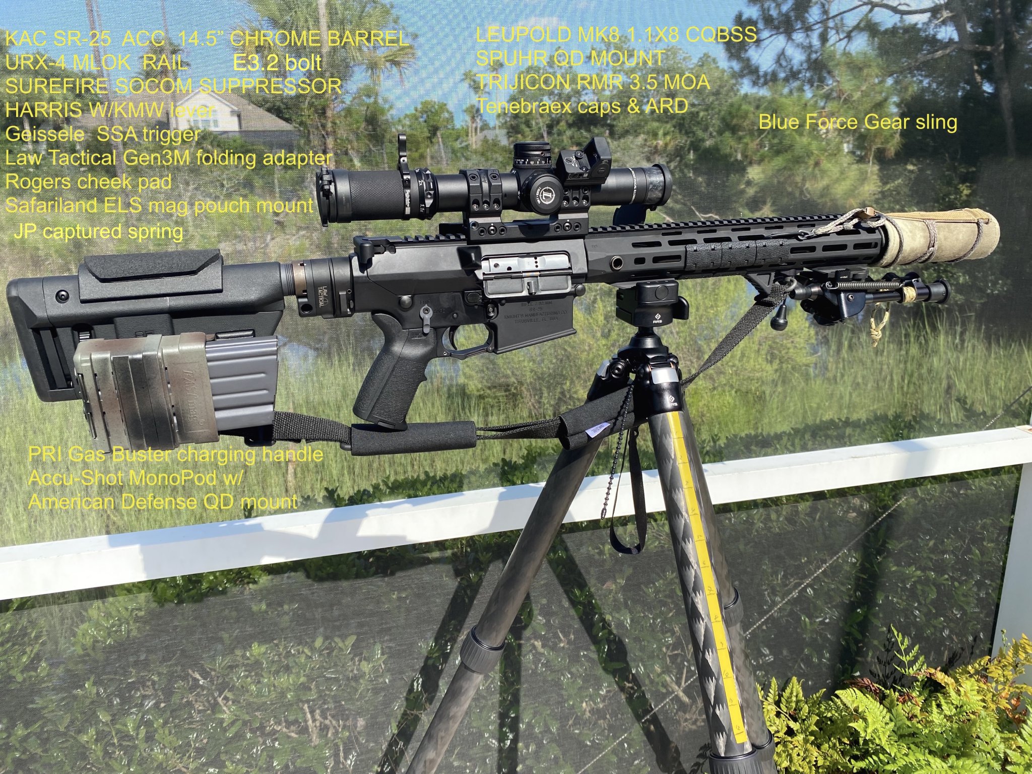

My first choice would be an ultra light AR 10 in 308. Mine weighs 6 lbs without optic, has a 16" fluted barrel, capable of 1/2" 5 shot groups with 168 ELDM at 2756 Ave fps, or 150 /155 gr at 2815 to 2880 fps.
Light, short, easy to maneuver, and lighter than most AR 15s with 16" barrels.
Good muzzle brake it has light recoil. Capable of taking any big game in the lower 48.
2nd choice would be 6 mm ARC for deer and coyotes.
But my AR 15, 6 mm ARC is 2 lbs 12 oz heaver than the AR 10, with its 18" barrel.
Even my 16" 300 blk AR 15 is 13 oz heavier than my ultra light AR 10.
Plus the 308 has better trajectory, lots more energy, and much better potential in killing power, and a huge variety of components, ammo, and really cheap brass, so you don't care if ya lose it in the field, and very long barrel life...308.

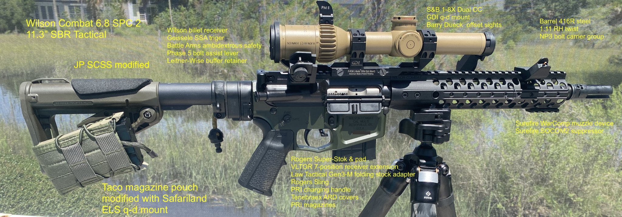

6.8 spc works very well as a hog slayer.
I'm going to second this suggestion. You get a rifle that will shoot .277" bullets into sub MOA groups fairly easily, and was designed for the ranges that you have included. Mine is not all that light, but it wasn't built to be. The case is bigger than the .223 case, but not as big as the 6.5 Grendel or 6mmARC, which have some issues with damaging bolt lugs in AR rifles. Recoil is much less than a .308, but more than the .223.
If you think that you'll be doing more of the 500 yard shooting, then there are 6mm offerings based on this same case, and I'd lean that way for more dedicated longer distance, but if the 500 yard shots are the exception, then the 6.8SPC is right in your wheelhouse.
Reactions: Kangbeef and 346ci

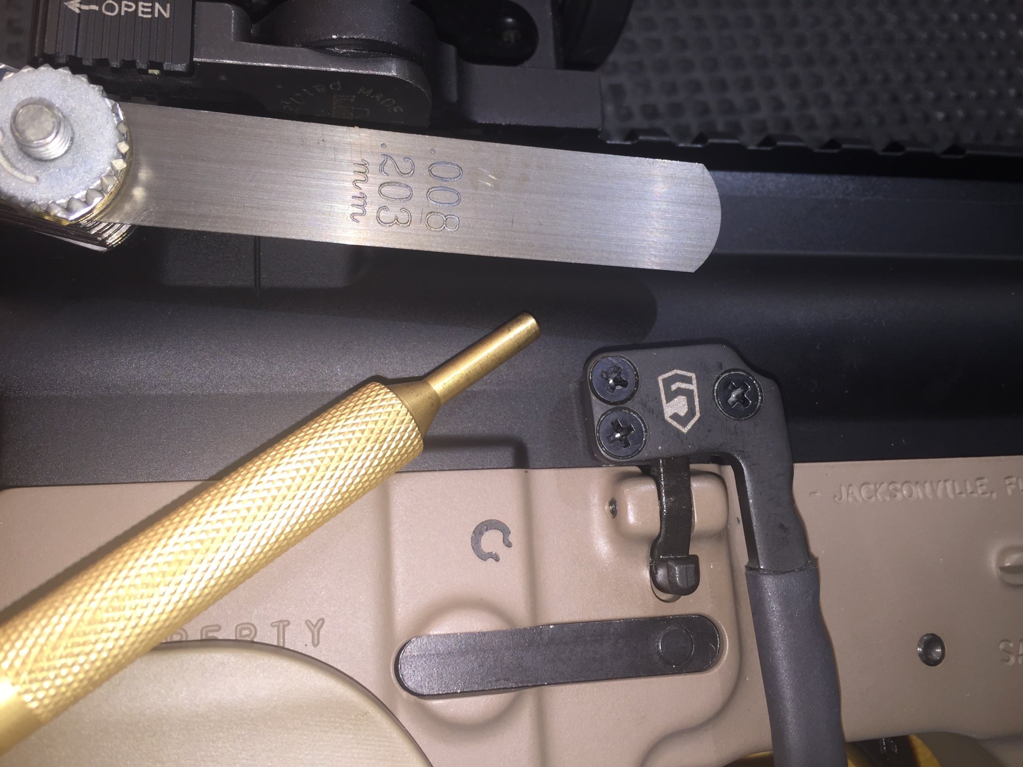

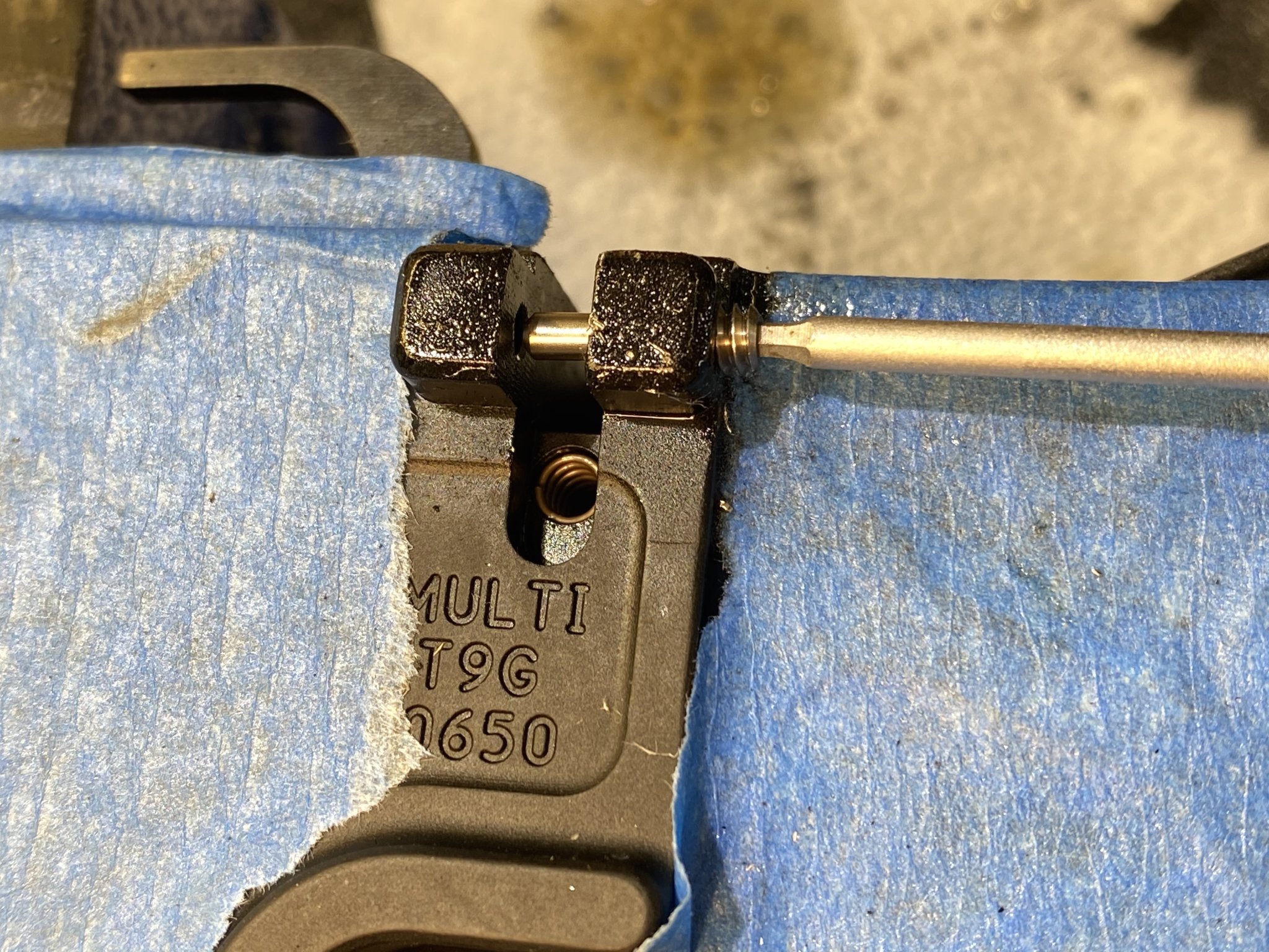

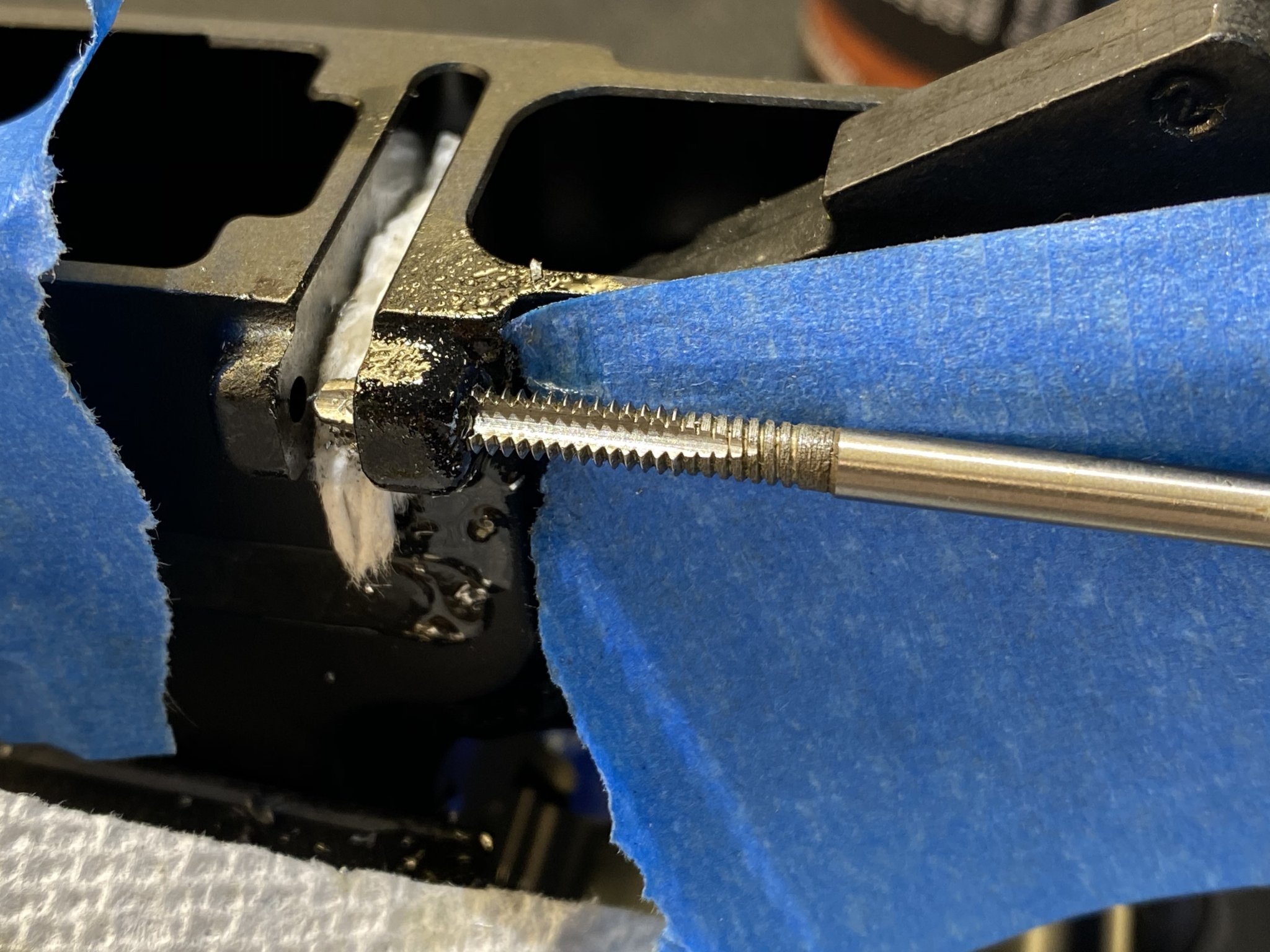

What bolt release is that I see? It doesn't look like the BAD Lever.

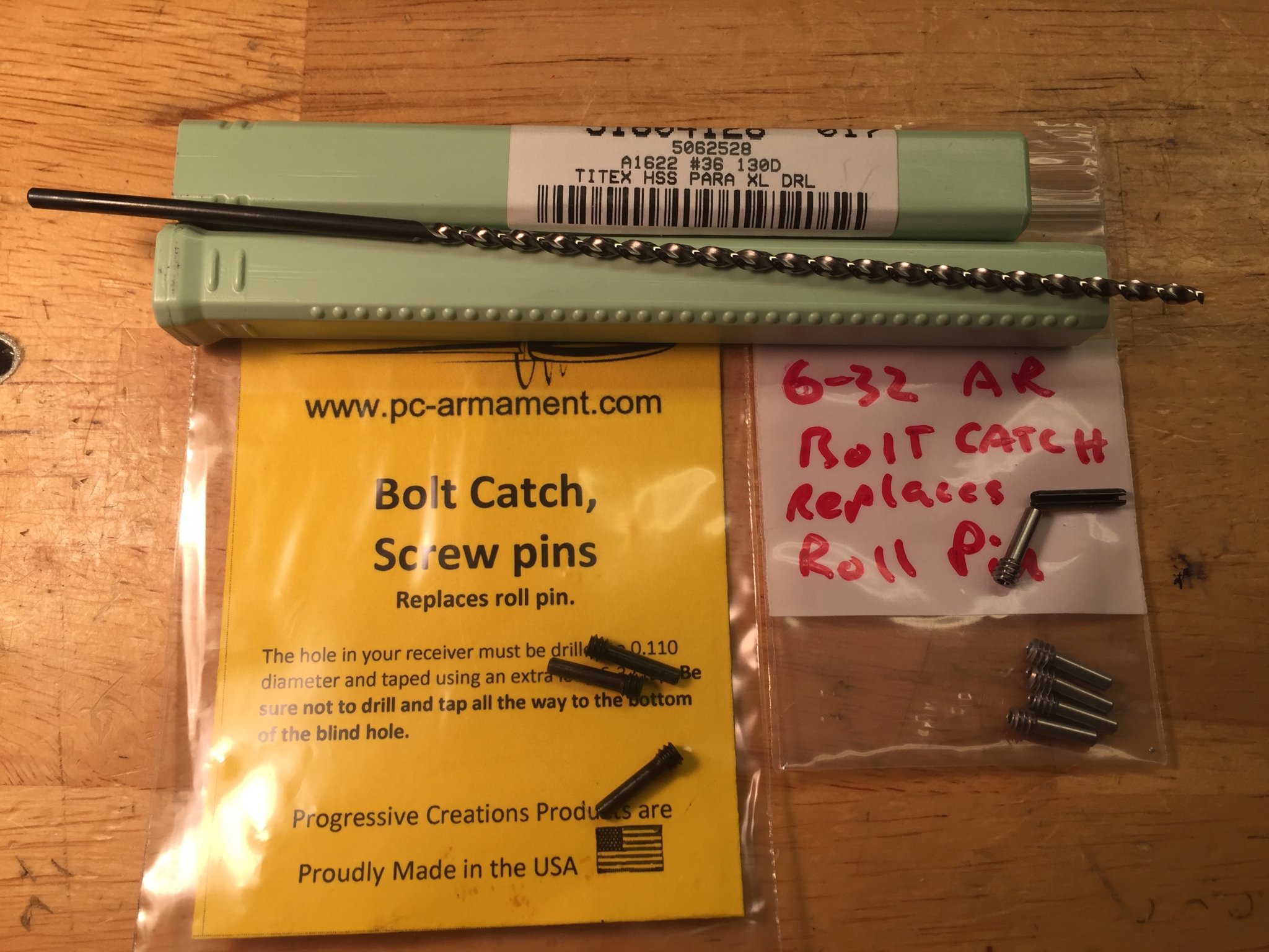

Phase 5 Tactical bolt release. I have a number of them installed.
Don't recall any difficulties with installation. I do change any bolt retaining roll pin with screw-in style axles to retain the bolt release.
And apply marine grade shrink tubing about the lever to prevent marring the finish of the gun art.

Thanks for that detailed response. Looks like a rock-solid installation.
I like your use of the shrink tubing too, great thinking!
