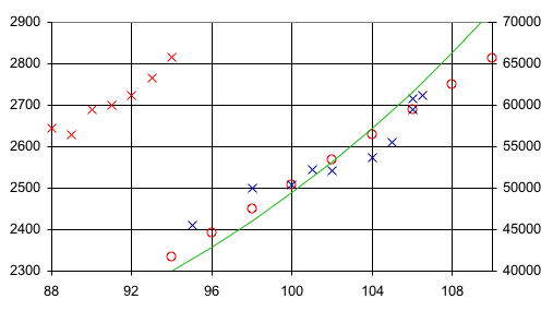

The following graph was my experience with Retumbo and WC860 in a .338 Edge (.338/.300 RUM) with 300gr projectiles (SMKs and Bergers) in a 25" barrel.
Red X is measured Retumbo speed
Blue X is measured WC860 speed
Red circles are Quickload-predicted speed with US869
Green line is Quickload pressure (right hand scale) with US869.
Retumbo gave sub-MOA groups at 200yds over a range of velocities through a factory Remington barrel (rechambered). I never ran the pressure up to max but the Retumbo velocities were very consistent. Bullets seated pretty close to the lands. Bergers were single-fed as their OAL exceeds magazine length. SMKs will fit the R700 mag box seated near the lands.

Thanks for the info. Looks like you had a node at 91/92 grns Retumbo. I've looked at Berger's info and was hoping for people's experience with good ES & SD at slightly higher velocities.
Don't trust my graph. The data's nearly 8 years old and probably a single shot for reference, not multi-shot averages. I don't remember my procedure and my notes were less complete back then. That said "nodes" are likely to be fairly broad given the case capacity. An entire grain of powder is only about 1% of the powder charge.
