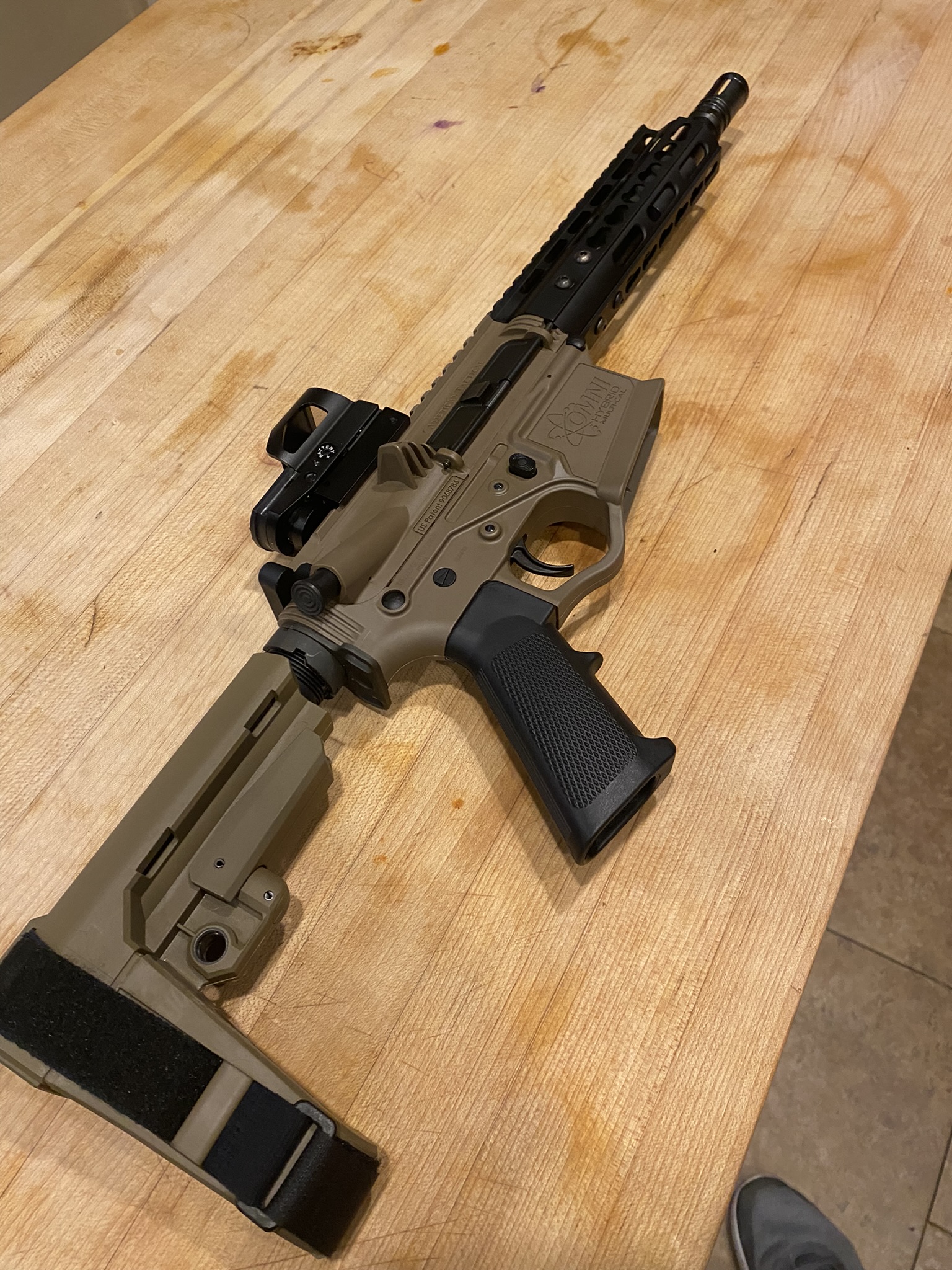

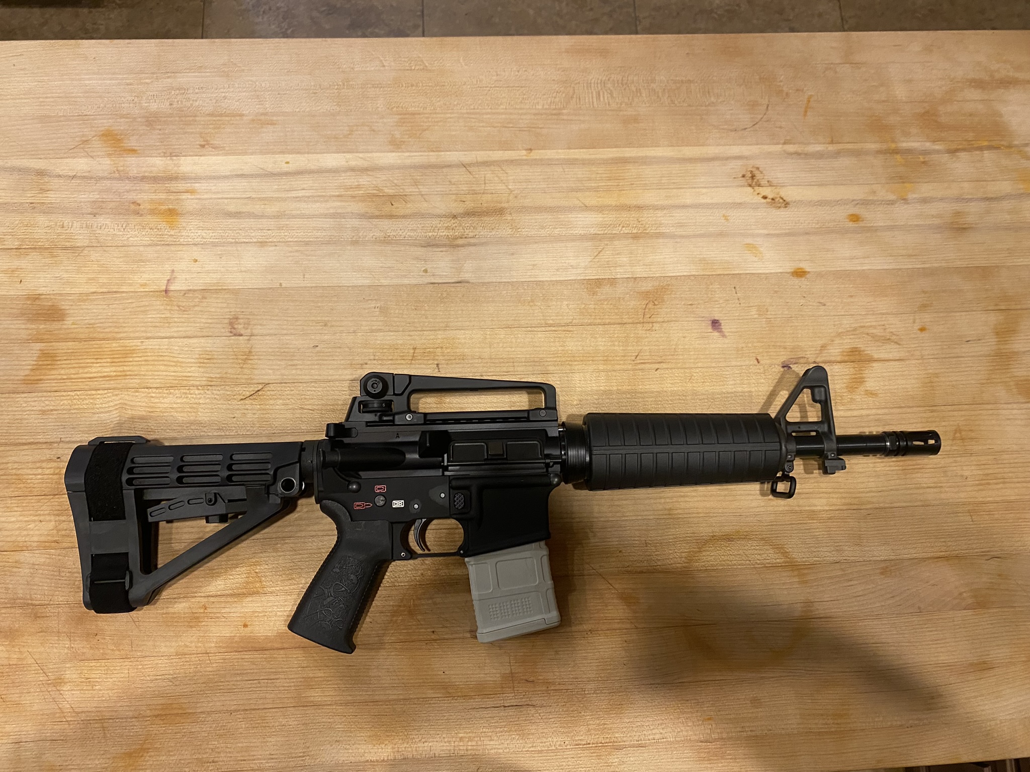

Dont get me wrong im a fan of 18” plus barrels and like your choice just not for a home defence situation. That said for home use i zero at 7 yards,, and a holographic or the simple iron sites as in pics, and The reason being from my former years in law-enforcement, he average police shooting occurs at 7 yards or less so unless you’re indoor surroundings exceed 21 feet in any direction a 25 yard or 75 foot zero would be far too excessive. Any type of rifle in the home is essentially replacing a pistol and so should be treated as such.
