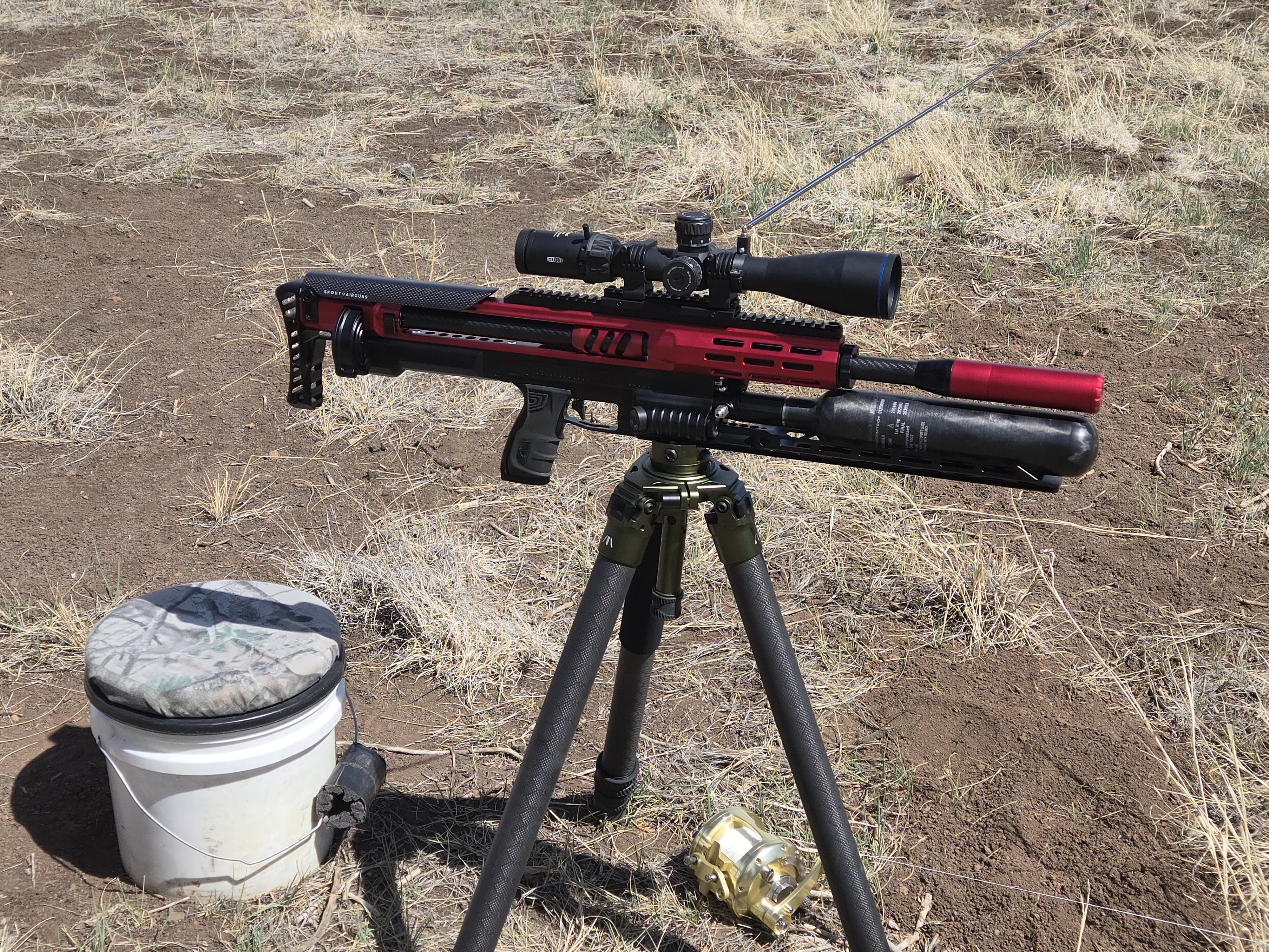

I love shooting pcps and slugs at longer distances. Some of mine are very good at ELR distances, good enough to be much like a 22rf, but without spending the ludicrous price the higher end 22rf ammo costs nowadays.
Just yesterday I got 1st round hits on many steel plates starting from 20Y all the way out to 275Y. In fact I rarely missed in pretty intense winds of 10-15 mph that was being pushed in front of the snow storm that came in at the very end of my session.
It amazes me this can be done so reliably with my 49 fpe 22 cal Skout EVO air rifle sending 32.3gr slugs at 829 fps! I'm actually not sure I could have repeated this even with my Anschutz 22rf match rifle.
That's fine if ELR using air rifles isn't your thing, and you can't or don't have a desire to do it, but I definitely understand why I do it!
