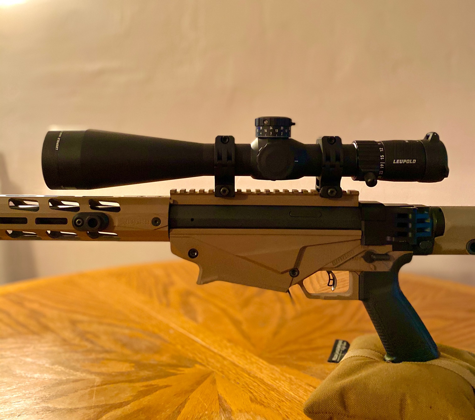

This is what a set of ARC 35mm rings with a 1.26" height looks like on my RPR 6.5 CR with a 7-35x56 Mk5HD. Factory 20MOA rail. I had this same scope in a set of ARC rings with 1.10 height and still was room to run scope cap but they were too low for my Magpul PRS stock. Head all layed over..... I know you're going to have a 30 MOA rail but I still think the 1.26 height ARC rings would work great. Great rings.
Reactions: Cowboss
