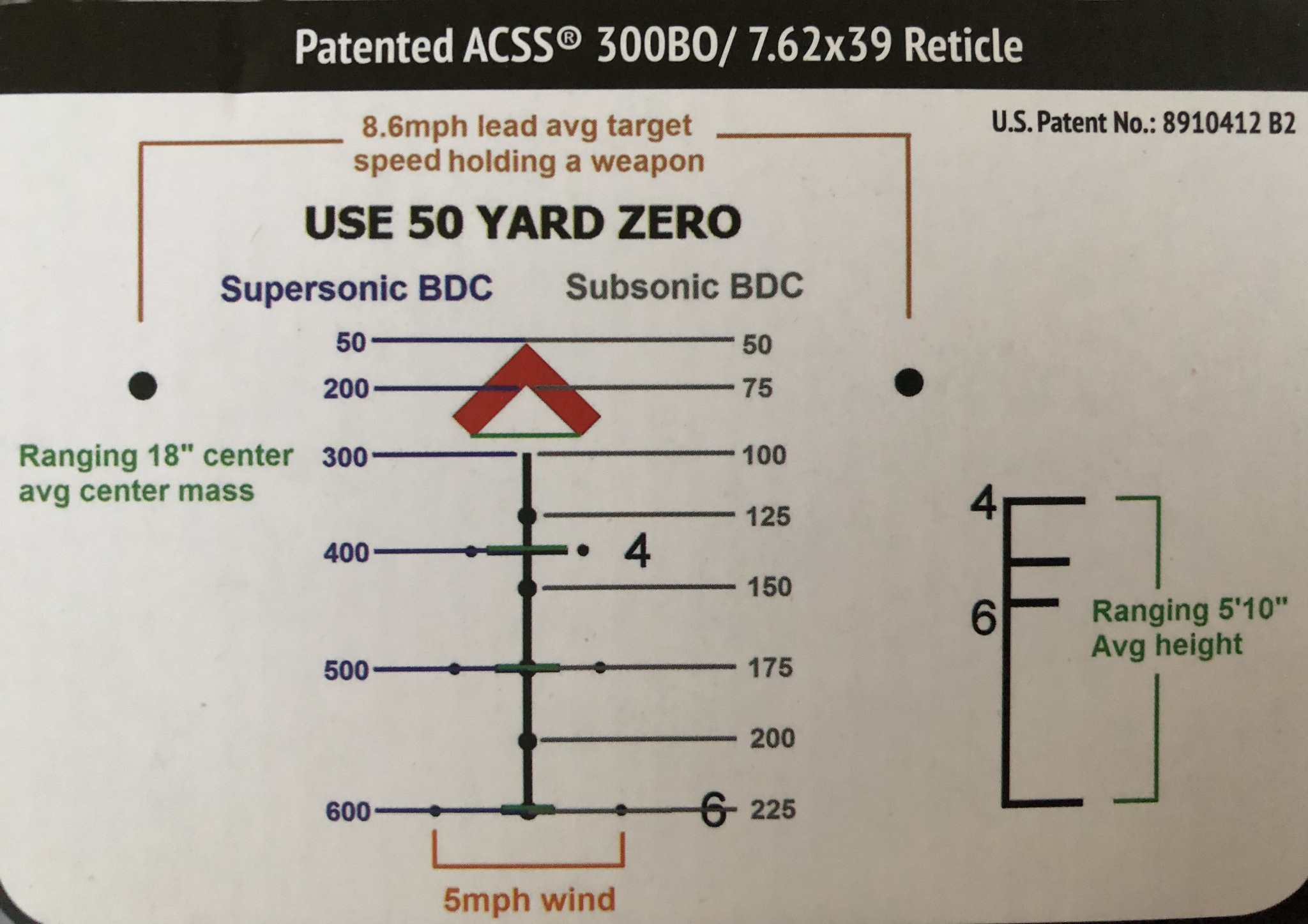

I think that you may be a little confused on how to use the 300BO reticle.
Subs and Supers are zeroed at 50m together, but from there the BDC changes drastically.
Take a look at the below reference card. Your results at 100m sounds pretty spot on.
If you can get subs and supers to shoot to the same POA/POI at 50yds I’m all ears!!
I’m zeroed at 50m with supers. I don’t shoot subs, but I suspect that if I loaded up some subs and shot them they would not hit at the same point of impact as the supers do. Likely lower.
I base this on 2 ASSumptions. First, subs are generally twice the weight traveling at less than half the speed of supers. And second, @Dutch260 mentioned earlier in the thread that his supers impacted 12” higher than his subs.
So if there’s some trick to get subs and supers to shoot to the same point of impact at 50m I’m all ears!
Exactly @Luvman which was my problem. I just zeroed the subs @50 and hoped/thought the supers would be about the same POI @50 as well. If not then there was no point in splitting the difference as my primary goal was to have the subs dead nuts and then the supers as a usable backup if I wanted some more ooomph.
So after my initial zero with subs @50 I stepped out to 100 yards and used the top of the post on that reticle as designed and it was on the money regarding the POA & POI. Had some decent wind gusts too but was still at about a 1" group so I was plenty happy with that for just thumping hog ears. But then when I switched up to my supers and used the top of the Chevron for 100 yards everything went to shit. Was hitting 12" high. Did that for two different brands of ammo (Sig Sauger 120 Coppers & Barnes 120 TAC-TX).
Could have been that the ammo but with that big of a difference it seemed obvious that the reticle wouldn't effectively compensate for both supers and subs with a common zero.
I don’t think ANY reticle can compensate for loads with that much difference in weight and velocity.
There’s going to have to be a zero shift in the knobs to accomplish your goal.
a LPVO with exposed knobs and repeatable adjusts should do this. You’ll just have to dope and log the offset and drops for the different loads. This is another example of BDC reticles limitations. And is another area where exposed turrets with matching reticles shine. MIL/MIL of course but that’s a different shit show;)
Propriatary / caliber drop reticles are a waste.
Every fps change, bc and shape, weight.
Just spend money on a decent scope with external turrets.
On an other note the drops are seperate i.e.
If you set a 50 zero with a sub then you can use the drop reticle for that side.
Your super round will not magically now line up at 50 as well as has been seen
with several of the bdc contraptions I have used and been disapointed in.
The way they work is to be set for sub OR super for them to subtend.
That has been with 3 different brands.
Imho
