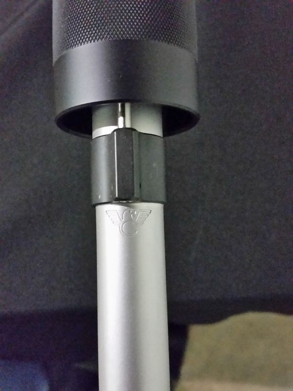

I went slightly longer with the 20" SS barrel from Wilson Combat 1:8 twist. On a bad day a 5 shot group at 100 yards will fit under a quarter.
