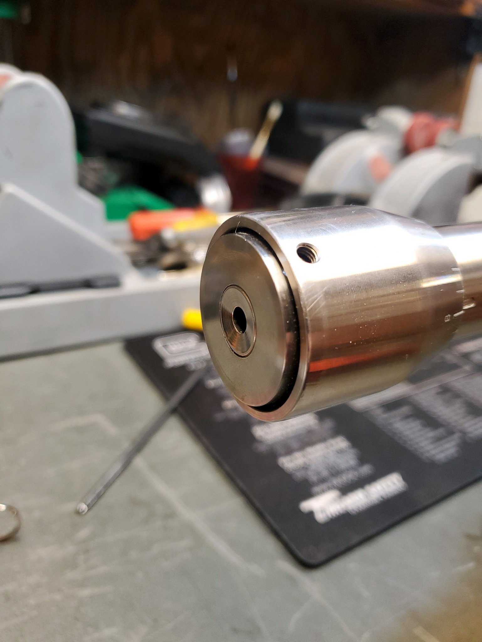

Guys I shoot 22lr fclass. My rifle is a Russian vostok cm2 that had the barrel cut to 20" and recrowned. The best I could get was 1/2" groups which is horrible, when the x is the size of the bullet at 50yds. I bought a harrel tuner and running rws r50 ,which shot the 1/2" group, now will shoot them in the same hole if I judge wind correctly. ROUTINELY shoot 1570s or higher with this combination. Have shot many 200s with x count at 50yds. Tuners 100% do work, but I've heard a lighter weight tuner works better.
So much misinformation on this forum concerning tuners I very seldom respond anymore but I have nothing better to do tonight so here goes. The amount of weight needed to tune a barrel is determined by barrel length and diameter . The blank statement that a lighter tuner works better is pure BS! Barrels 20in or less don't respond well if at all to tuners. I have never seen a seen a 20 inch barrel respond to a harrels. Tuners help eliminate vertical and have very little effect on horizontal spread. I have never seen a Harrels take a 1/2 in of vertical out of a barrel at 50 yds. Not saying it's impossible. Just saying thats been my experience with close to 10 yrs of trying to tune remfire barrels!
Oh no I'm offended now, lol. As I said I hear that. From other shooters. AND, the tuner will take out 1/2" and turn it into way way less. And the theory of the lighter tuner working better is due to the harmonics changing in smaller increments for a given thread pitch the tuner encases. But everyone is the most knowledgeable here and a better shooter than anyone else and knows my rifle more than me and may also be full of bs, lol. If you are near me I invite you/anyone to come shoot it at any point and see first hand. Here it is

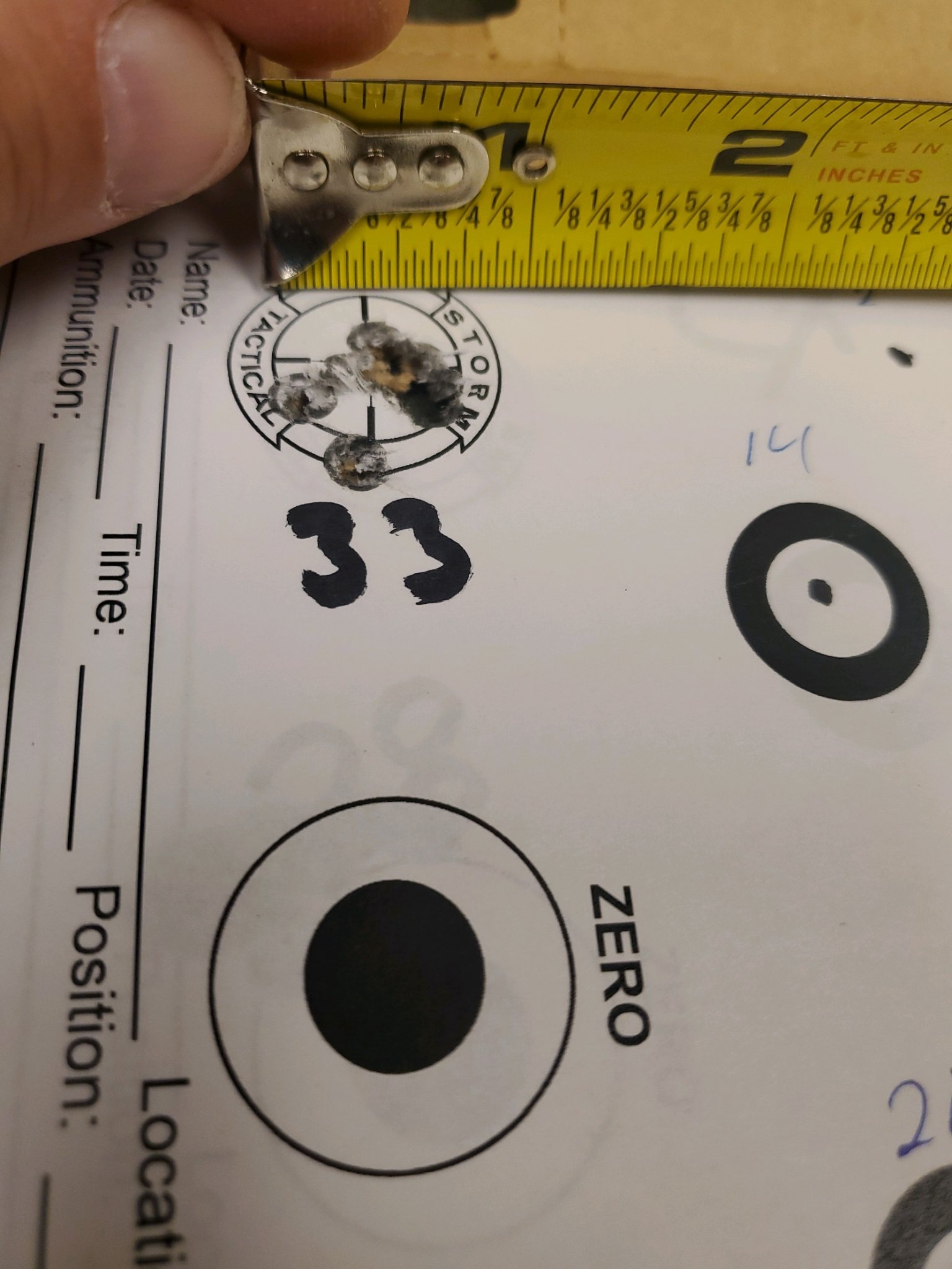

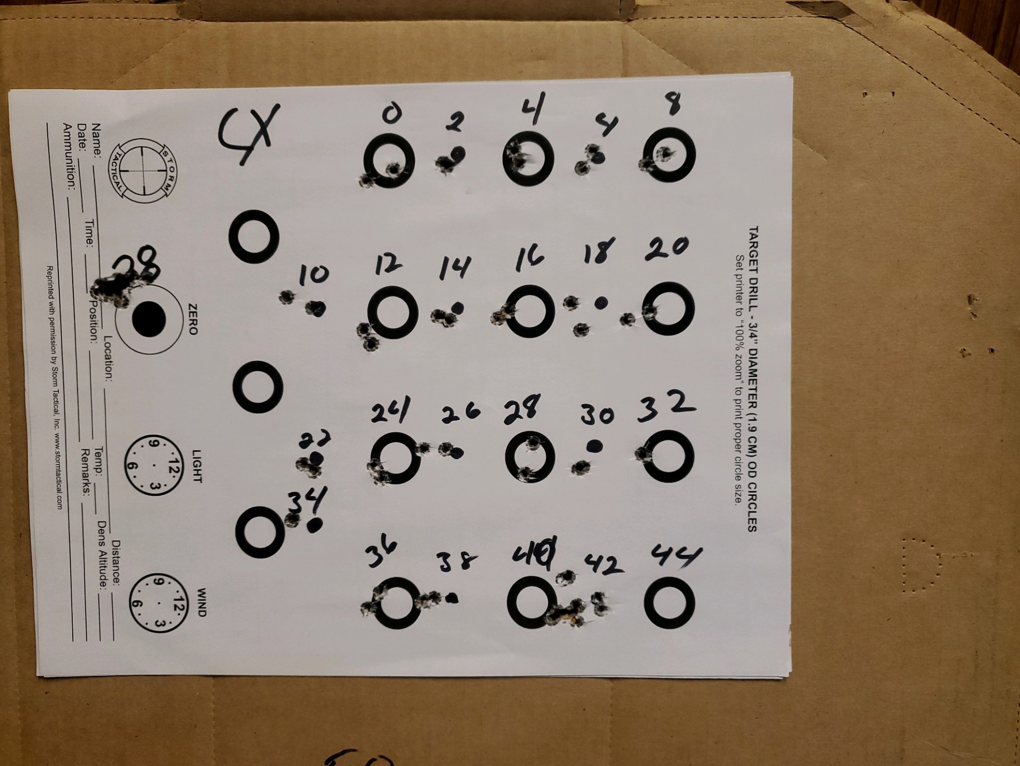

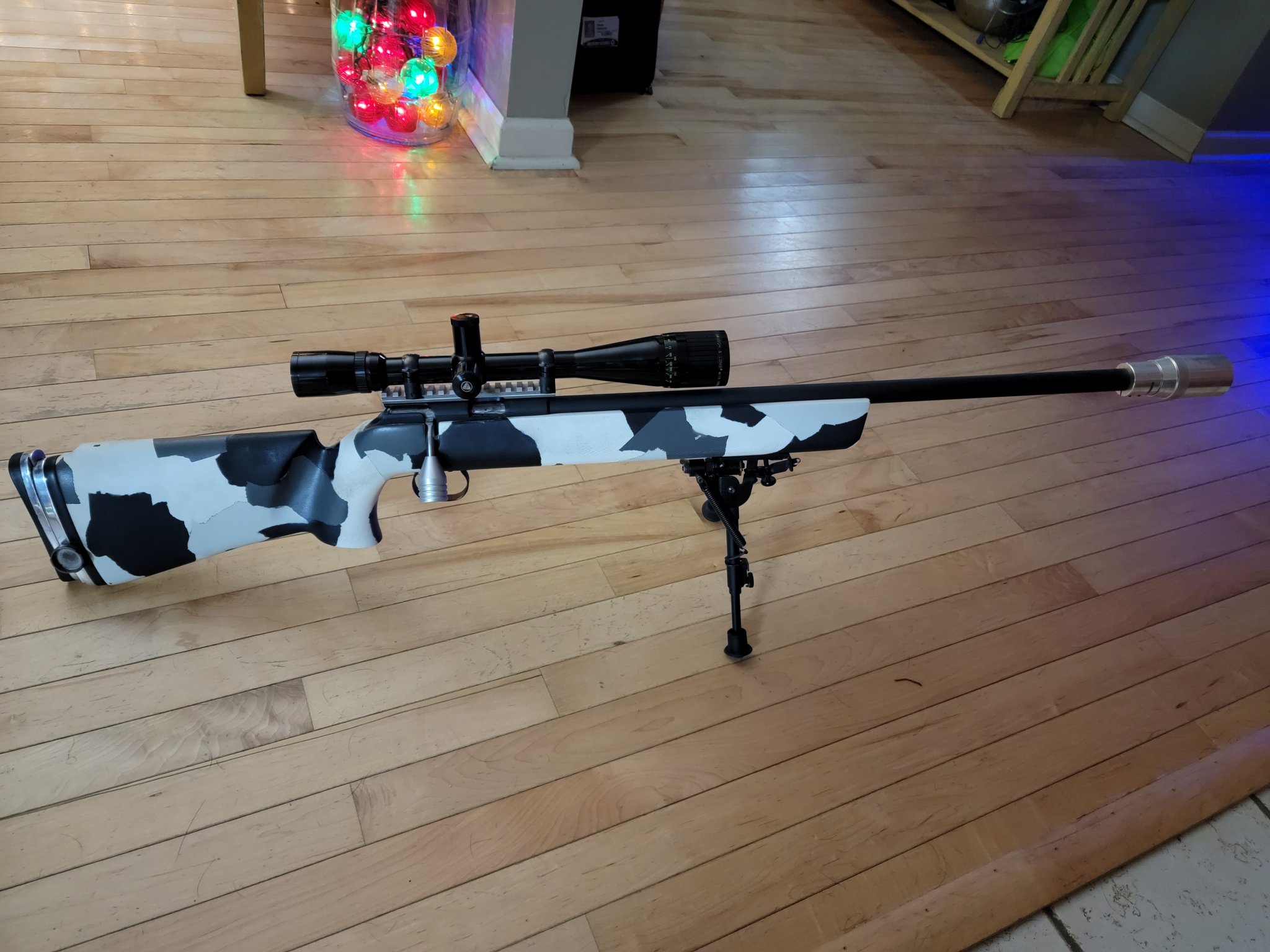

This was my experience with the ATS tuner, it's a rimx with a 26inch, 12 twist, Hogleg of a barrel with a anshultz'ish chamber. Follow trough riflewerks did the threading and chambering.
The left group of 20 marked 28 is eley from the first testing and ran out of that ammo.
So the rest is center x. I cleaned the barrel of all carbon and lead and anything else before I shot 25 center x into nowhere to lube up.. Then I set the tuner to zero and shot two per dot move 2 marks then 2 shots then 2 marks and so on until. I went with 33 on the tuner as it where the biggest nod. It also tells me the weight seem better a little behind the crown.
Rifle
Forgot to add this one

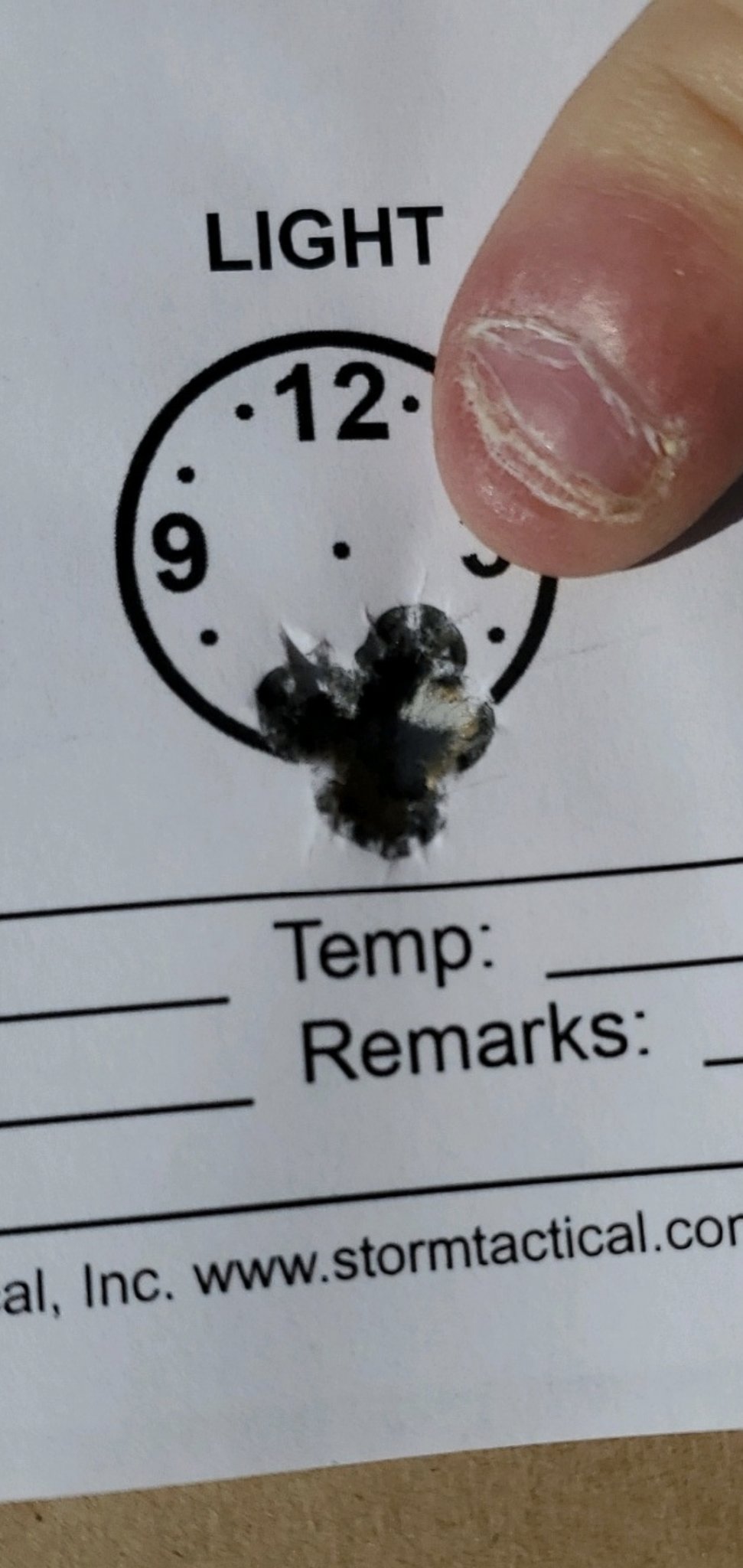

The first round of center X. I had 3 bricks same lot and all shot great on this setting 33
Now this was not touching anything and doing 20 rounds of center X in a different lot number I'm using now. So went up 1/10th and started practicing out to 206 and all went great.
Reactions: Farmerboy78
Now compare 18 to 22 and then 32, looks like a 1/2" group shrank to 1 hole, just as I described and was told it isn't possible.
Based on the information you provided I'm not convinced your tuner has actually done anything other than move your point of aim around. I don't see any control groups. That is groups shot without the tuner on the barrel with the same ammo same day same distance same conditions. Without a control group, how do you know the tuner is actually improving accuracy? Do you consider 2 shots a true representation of a guns accuracy? You need at least 5 shot groups or more to tell anything about accuracy. Did you go back and check setting 32 by shooting some 5 or10 shot groups to see if that tune was repeatable. If that 20 shot group at setting 33 was shot a 50yds your barrel is not tuned and you haven't turned 1/2 groups to one hole.
