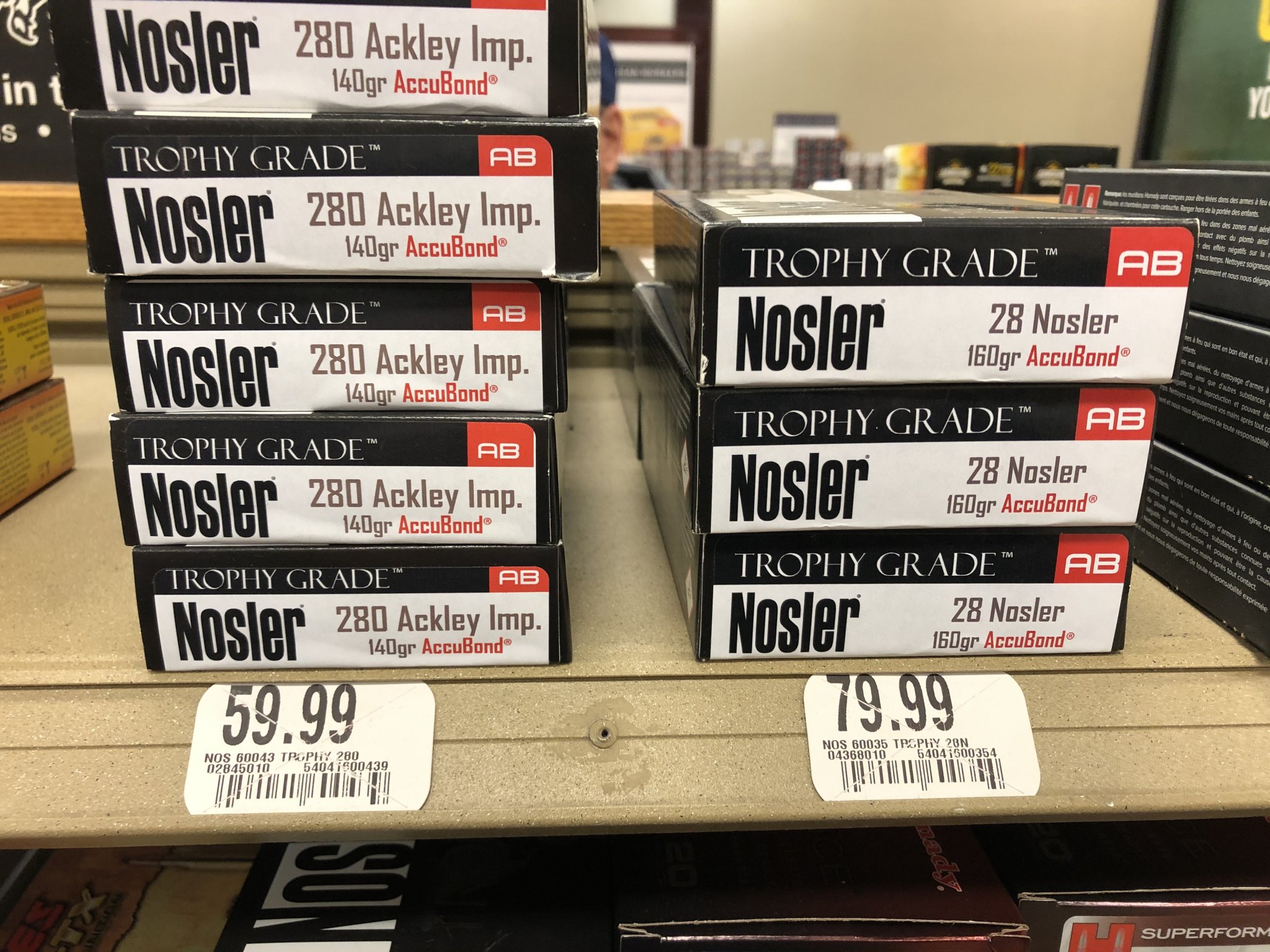

I seen quite a few people say they don’t save money. Maybe I’m in the minority but I definitely save money doing it. Good factory ammo is $1.50 each, I’m shooting it for .55 or so

What is the formula used for saving money? I notice 280 ackley brass, which is what I would be reloading is about $1.38ea (cheapest I've seen so far) and I haven't even looked a t bullets. Is it because brass can be used 6-8+ time before it is too far gone to use and you calculate price off that?
Brass expense is almost negligible. @Steel head has 30+ firings on some of his 260 brass. I’ve got 14 or so on mine and started getting split necks. Pretty sure I caused that by getting the brass too hot while annealing.
I’d count on minimum 10 reloads on the brass, add in your powder, primer, bullet cost.
All my reloading equipment paid itself off in 750 rounds or so comparing to factory ammo cost.

Interesting. I'll probably buy a piece at a time here and there. Still saving for my bolt action I'm building. I have everything ordered but the action which is the most expensive piece. My reloading adventures won't be until later this year/early next year. Still an issue of finding space in my house to dedicate to reloading as well.

That sounds like it could be done down the road. I watched a video of a guy form firing 280 rem to 280 ackley. Is there any damage done to the rifle when doing that? Some of the comments mentioned rifle damage when form firing. Too new in the reloading/precision rifle arena to know myself.

I see the 280 AI rounds at cabelas the other day, Nosler trophy grade 140 grain, $59.99 for 20 rounds.
