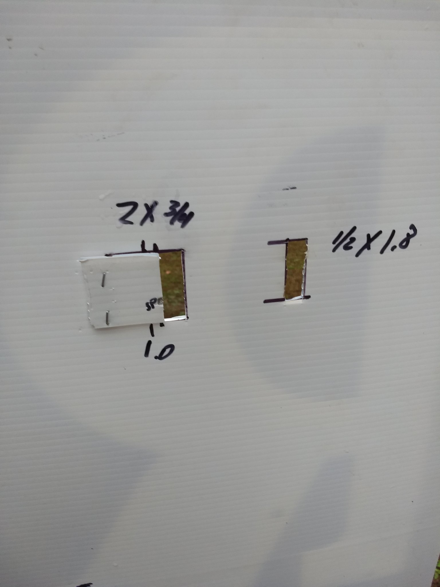

Been working on a new skill to me of Loophole shooting... Worked out a big part of the math and it is interesing how small a hole you can work through... Smallest hole so far has been 1/2 inch wide by 1.5 inches tall to 300 yards....
Reactions: Alpine 338
Been working on a new skill of Loophole shooting... Worked out a big part of the math and it is interesing how small a hole you can work through... Smallest hole so far has been 1/2 inch wide by 1.5 inches tall to 300 yards....
What cal/bullet speed are you shooting an what is your mechanical offset? The reason I ask is I'm throwing a 190smk at 3150 with a offset of 2.02" an it takes me 2.25 of vert opening to not show any dusting (if block or concrete) an hit a target at 300yds from 3 yds back. Wood w/no insulation I can get away with 2.0 at same/same. Farther back a little less but not much,...
My Scope height is 1.95 inches... Running about 2800 fps in my 308... with your offset of 2.02 my calculator shows that if you back up to 8 yards muzzle to barricade you should be able to get through a 1.66 inch high hole minimum...
Getting threw the hole is not the only issue, you need to be aware of. I have L/H data for all sticks an have seen the slow mo video shots from the other side. Not being able to detect the shot, is more important than the size of the hole you using, an remember in nature nothing is square or round.
Yes I understand that part... but crawl walk run... Its a interesting excercise and confidence builder... Are you refering to suppressing the shot to hide the shot? or to use a natural hole/ building feature to work out of like a crack/break/design feature?
I got the suppressed part covered. Perhaps I will do another sheet with jagged holes to try next. I do find with the holes fixed it becomes an exercise to get in the proper position and get stable. Using props and multiple bags, it can get interesting.
