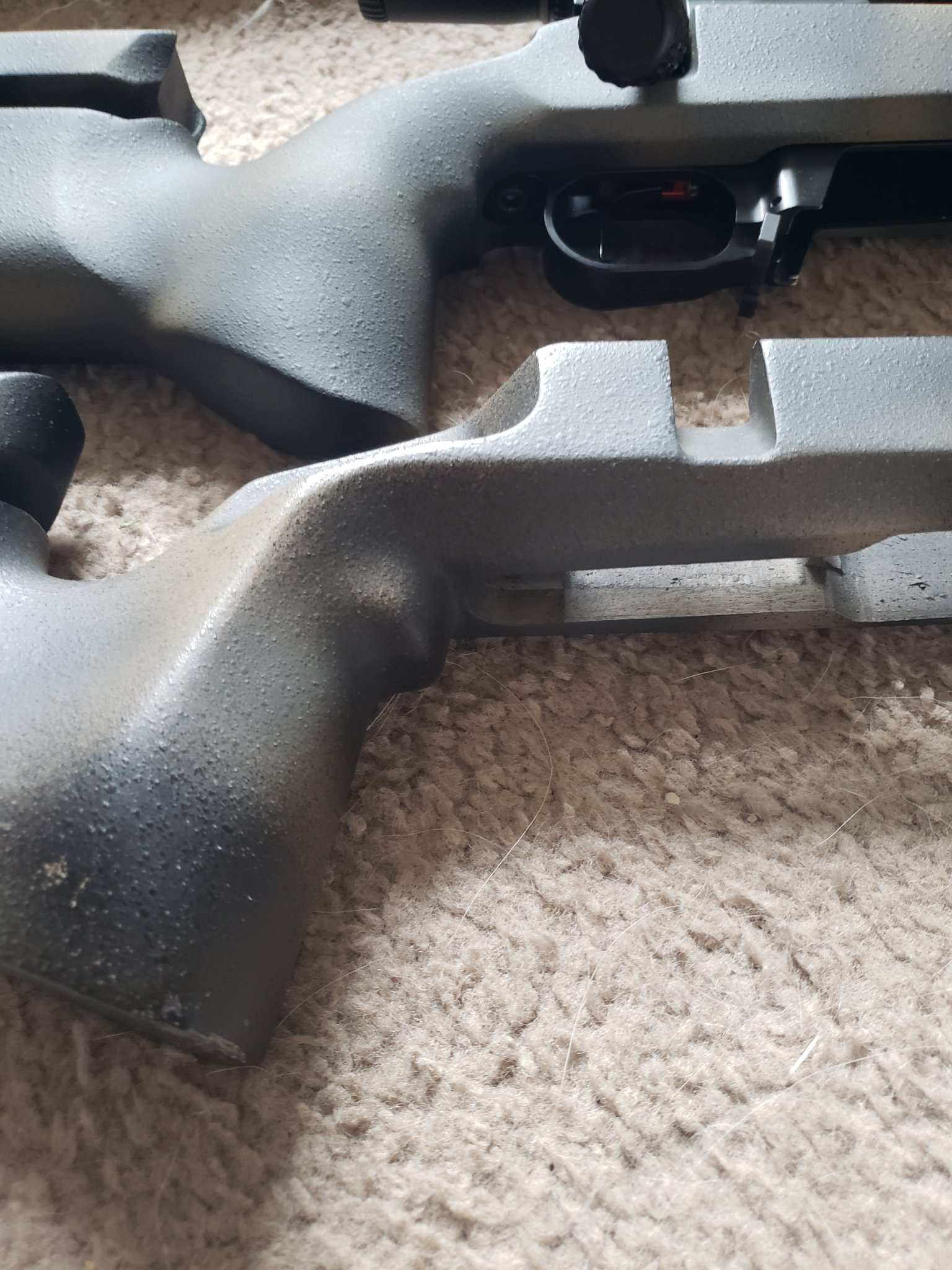

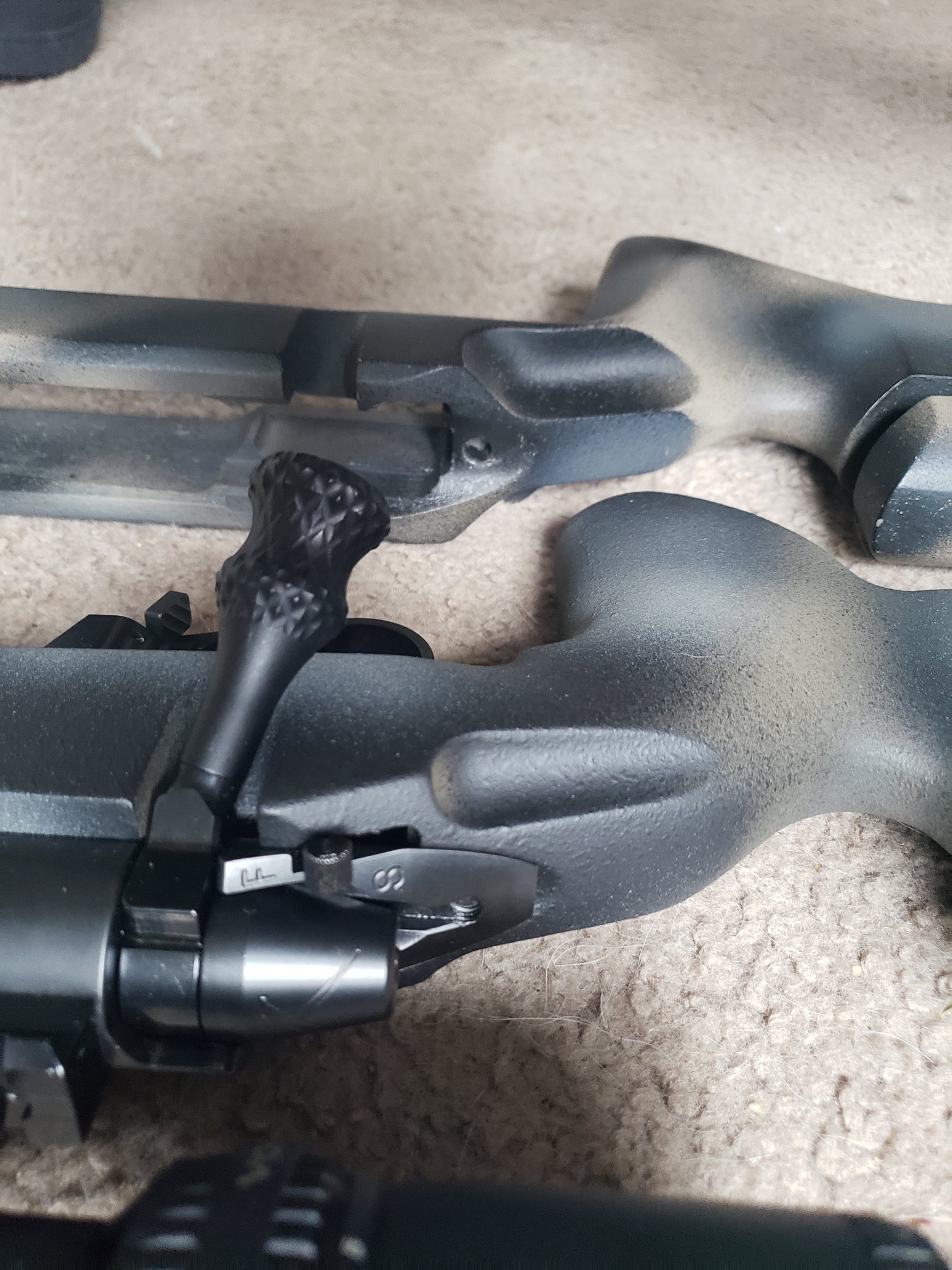

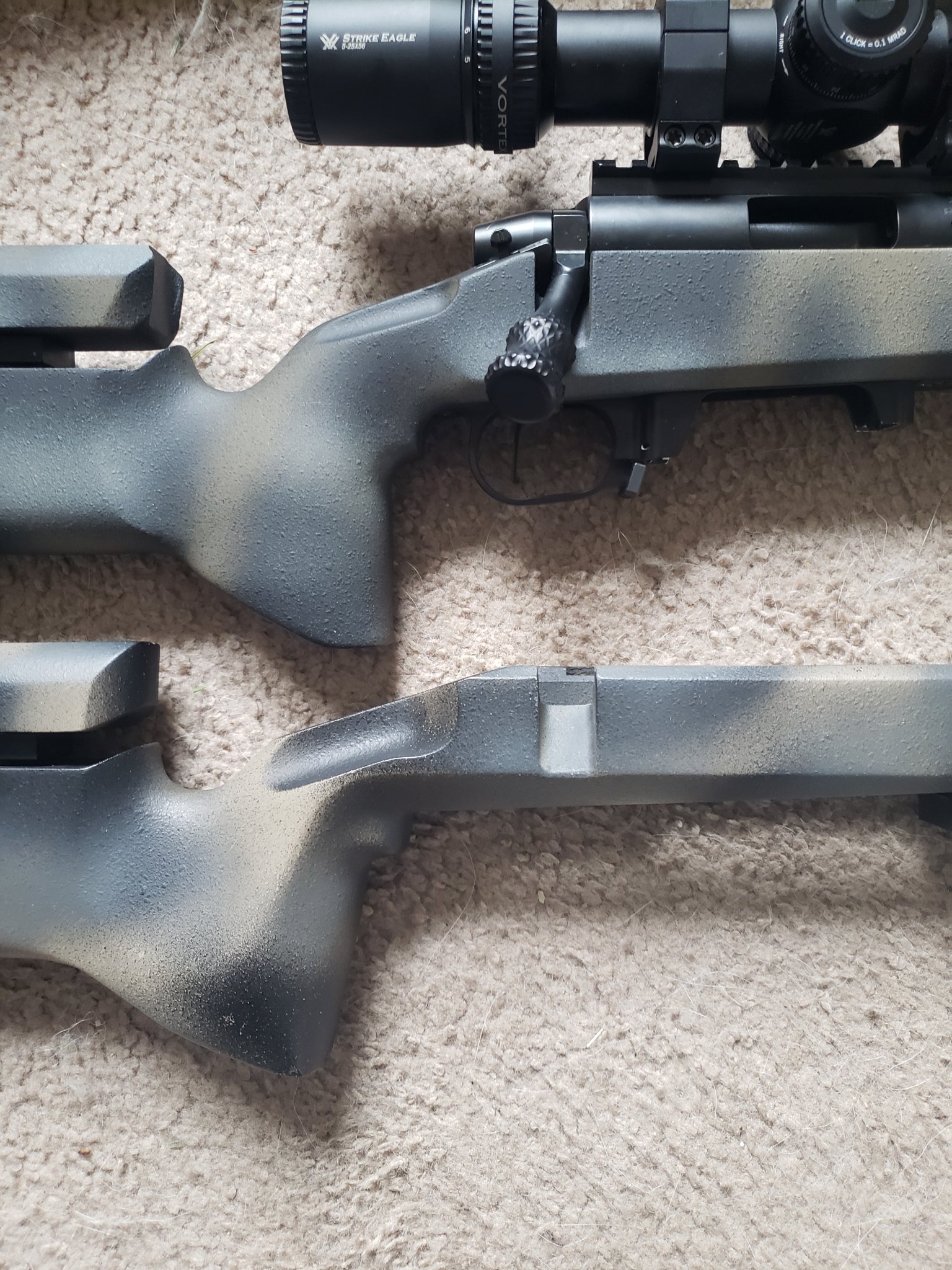

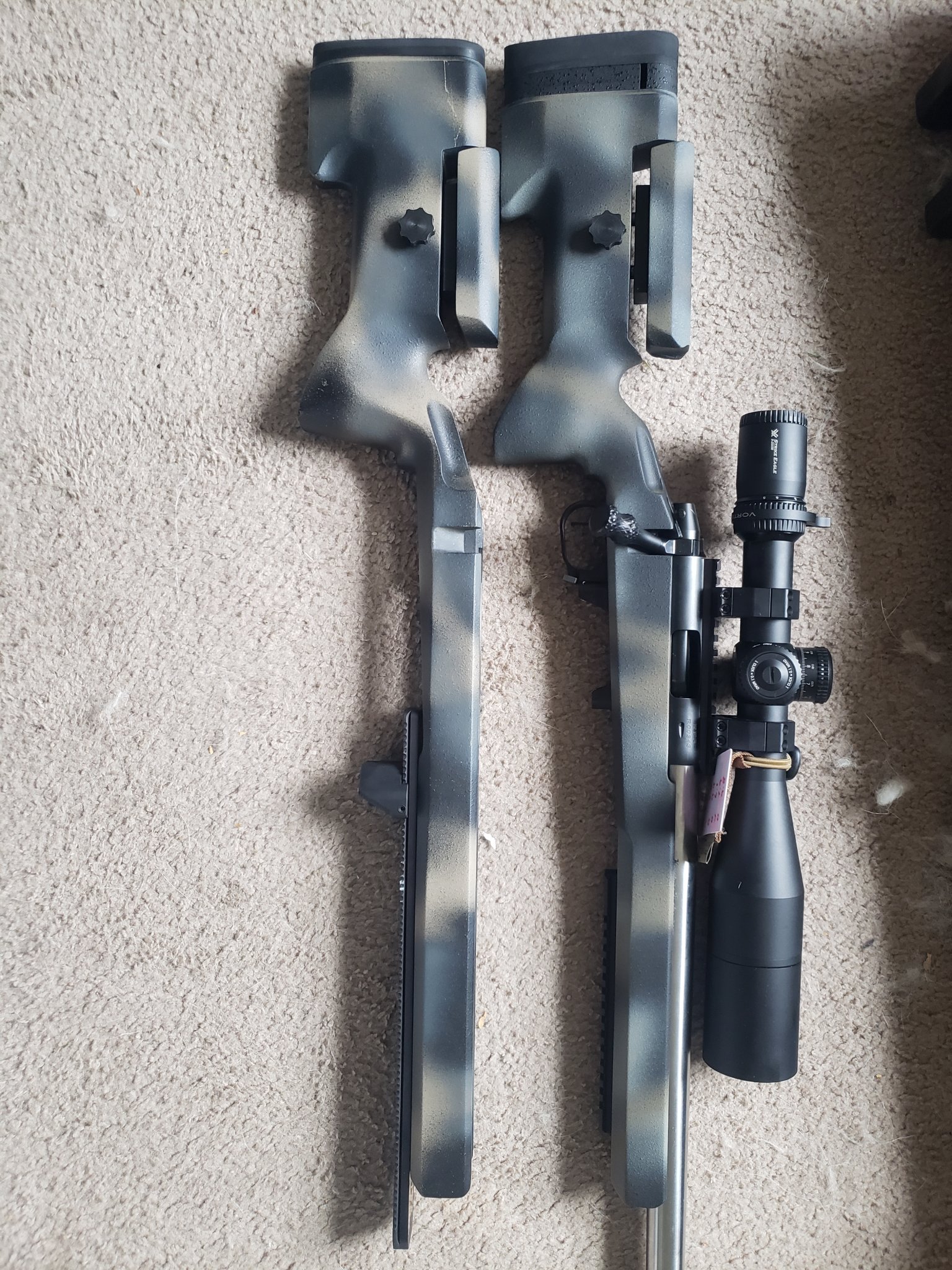

I threw up a couple photos to ask a question - how important is the distance from grip to trigger? One photo is the old “LOP from the crook of your arm” visualized (and about in line with the first knuckle on my trigger finger). The other photo shows how the relationship between the grip and the trigger “stretches” my finger when I’m actually on the rifle. I’d honestly never considered it - might just be a technique issue, too. My trigger finger posture was pretty uniform across three different stocks (the Game Scout you see, a KRG Bravo and a Tikka w/ vert grip bolt on) of substantially different length. If I weren’t having McMillan do another stock for me, I don’t think I’d even ask. I know some chassis let you adjust this and it strikes me that the optimal grip/trigger distance would differ person to person...but also that a LOT of very fine shooters have put the work in with whatever the industry standard is.

I ran into the same issue with my A3 and Game Warden Stocks. This article helped me with some new fundamentals. Hope this helps!
Reactions: LG65CM and DJL2
Yeah, that McMillan is a T-Rex like 12.5 inch LOP and I love it. It might not be cool to shoot prone unsupported, or bladed over support with a hand on the forend of the rifle, but that’s what I got it to do (or shoot offhand in a pinch) and it is excellent for that. I figure it’s a lot easier to add length to a stock than take it away if it comes to that.
I appreciate the reference. It jives with what Frank wrote on the topic and which got me thinking about it. Simply put, with the second joint of my trigger finger at 90 degrees I can’t reach the trigger (or can I?). That’s what I was trying to show in the photos - granted, the one photo is rough looking because I have never attempted to do this deliberately. With a typical grip, I need a 45 degree bend in my second joint to reach the trigger. As near as I can tell, that’s totally independent from LOP.
I can play with my grip position and mocking something up on it to see what it would take to get my second joint to 90 degrees. The point of departure is that I DO pull the rifle into my shoulder. Some of that comes down to not giving my .30-06 or 7mm RM a head start because letting either of those do what they want in a <10lb package isn’t comfortable or consistent.

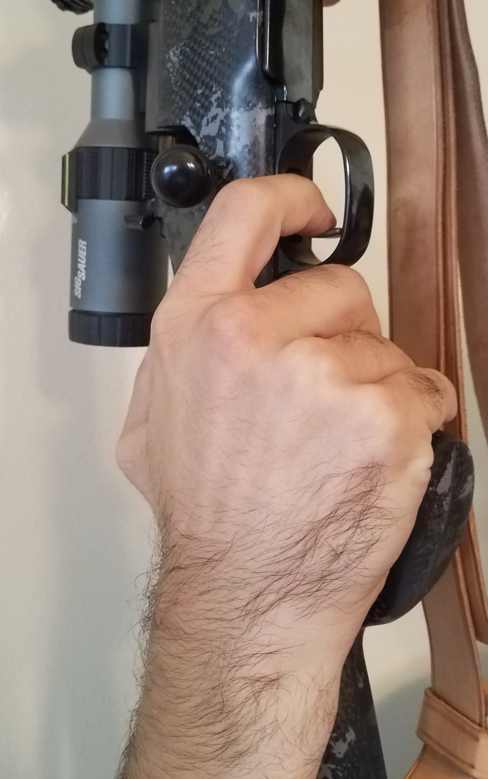

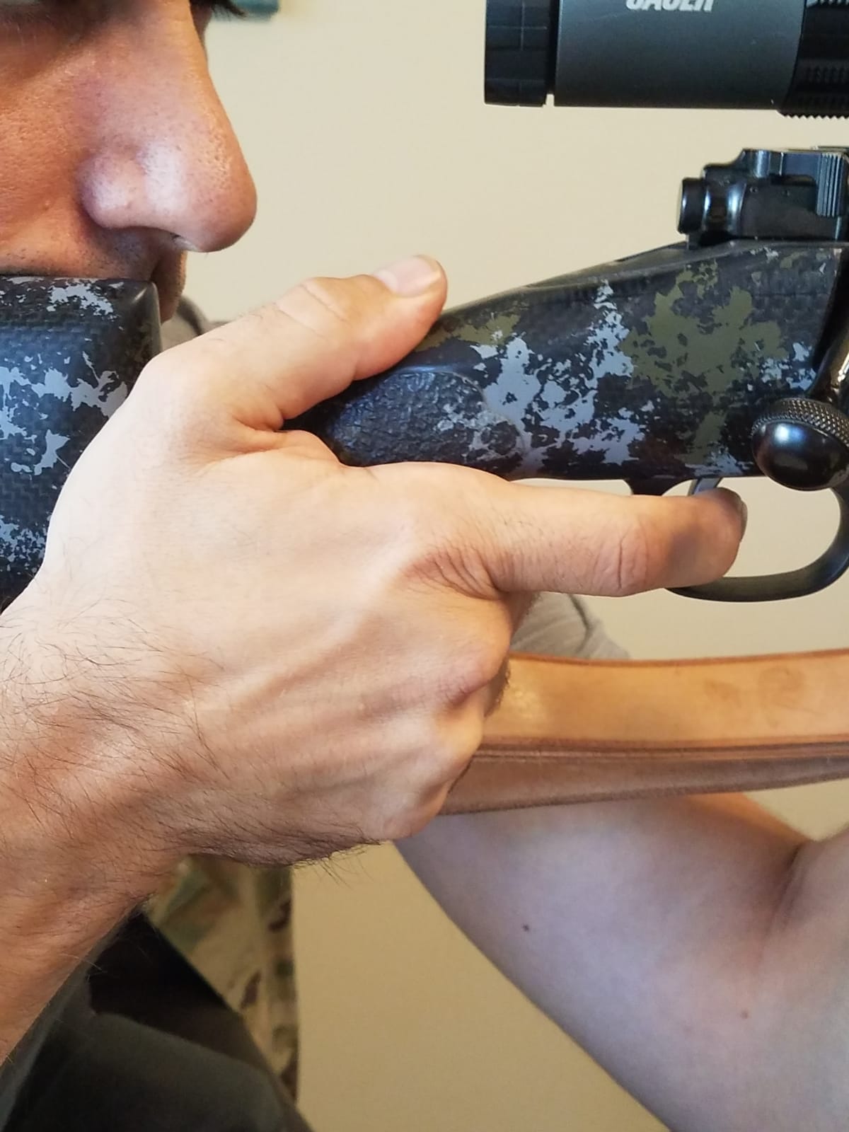

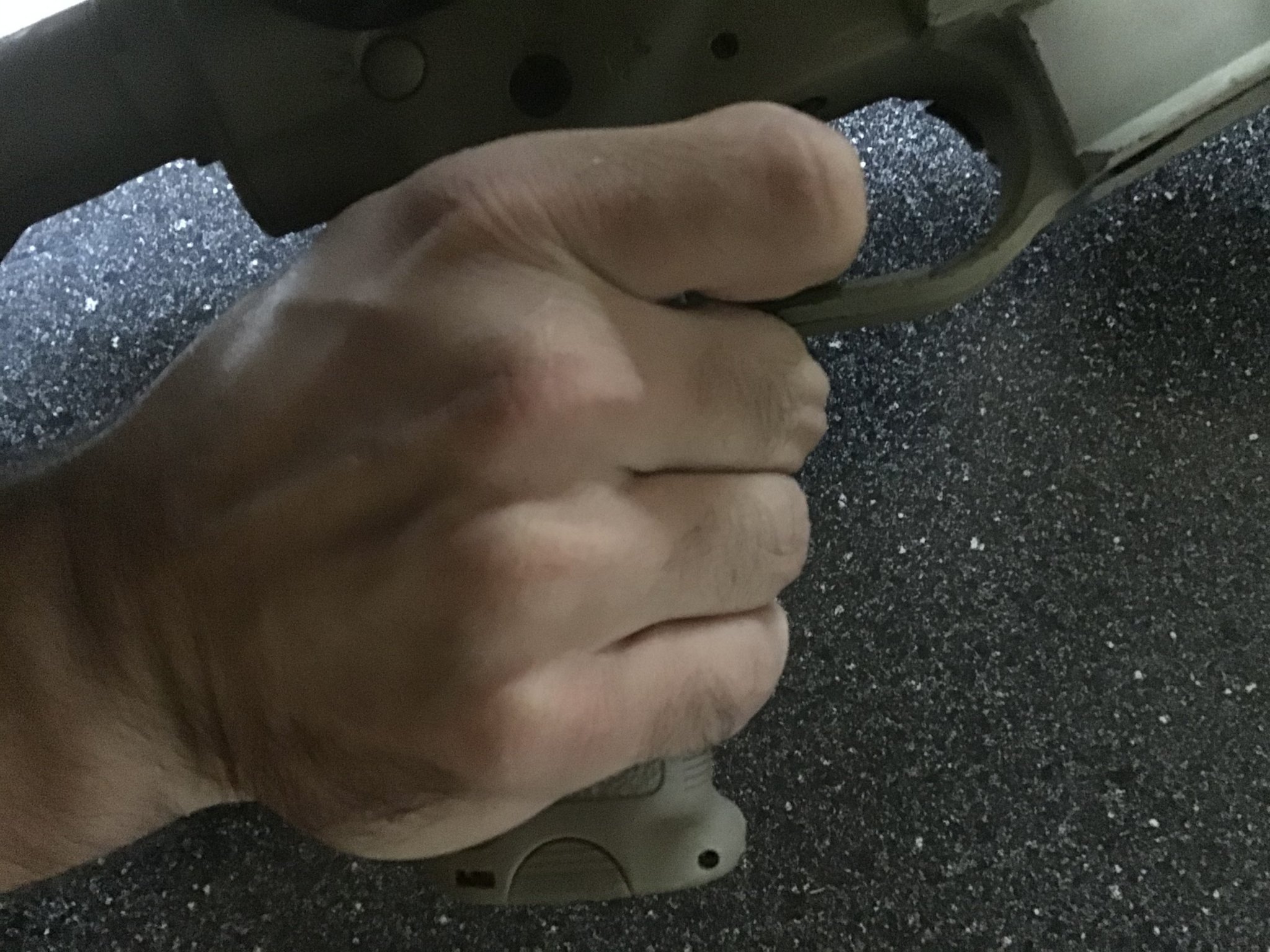

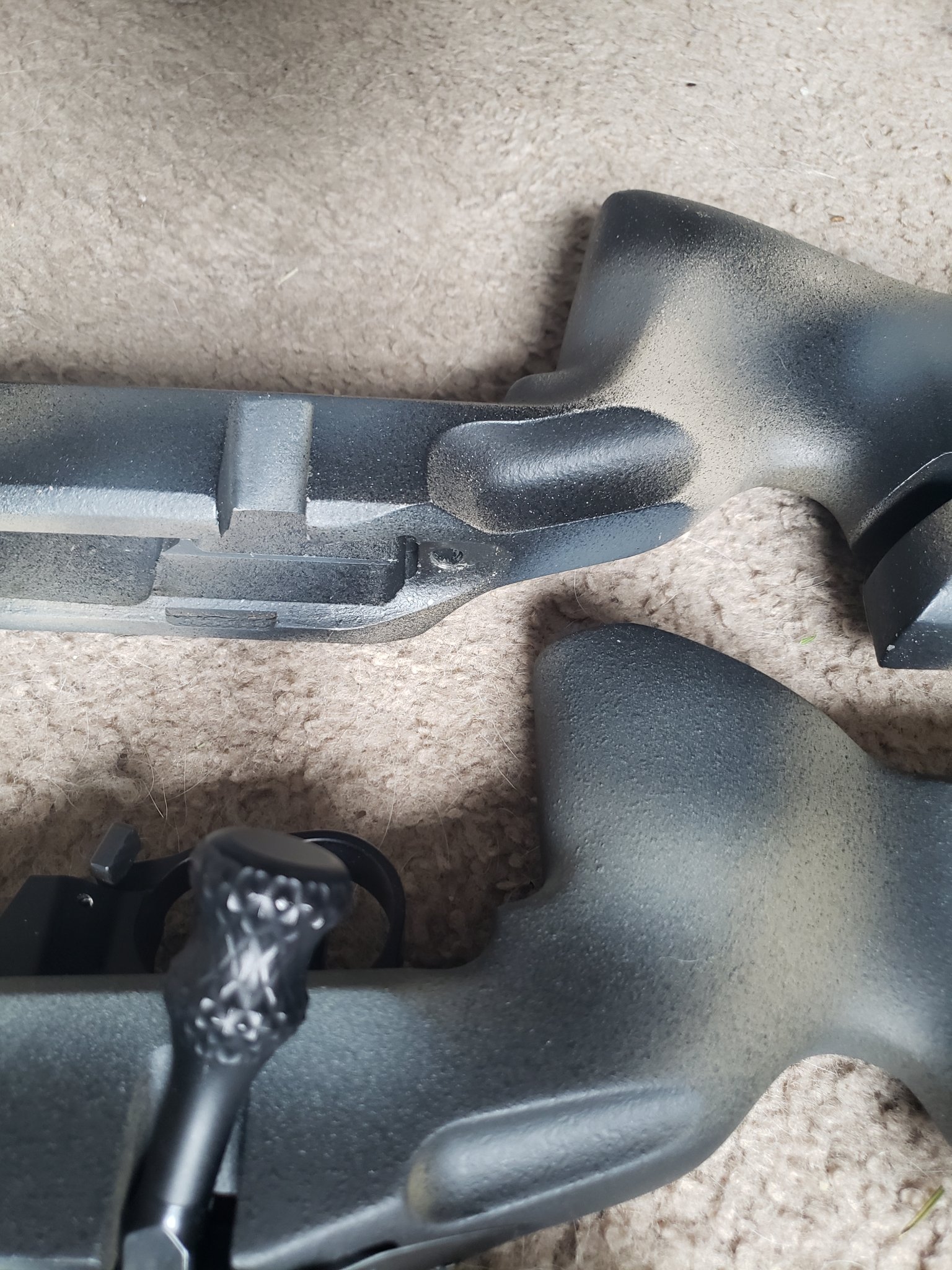

This masterpiece of photography shows a grip I CAN get my second digit to 90 deg on. That’s my 6.8 AR w/ BCM Mod0 Gunfighter Grip (I.e. the smallest one they make, and a necessity for manipulating selector from semi to safe). There is some weirdness because I had to take the photo myself...but, should be a decent representation.

I firmly believe length of pull is less important in bolt guns than grip fitment. We set these things up with the old crook of the arm and 90deg finger method but if the grip doesn’t fit your hand all that goes out the window. I would hope to see more companies come out with adjustable grips. I think length of pull is far more importing shotguns for wing shooting and clays.
I’d never heard of working the trigger at 90 deg until recently when I started reading, trying to suck less after I realized my trigger manipulation was creating horizontal deviation in my groups. It seems like some dudes that know WTF they are talking about think it’s pretty important...and, yet, it’s basically impossible on most any rifle I’ve ever handled. The reach from the grip to the trigger is just too far.
I’ll shoot a note to Josh at McMillan and see if they can change that up. Stands to reason a guy built like a Dachshund doesn’t have the fingers to match an industry standard reach to the trigger any more than they fit the LOP.

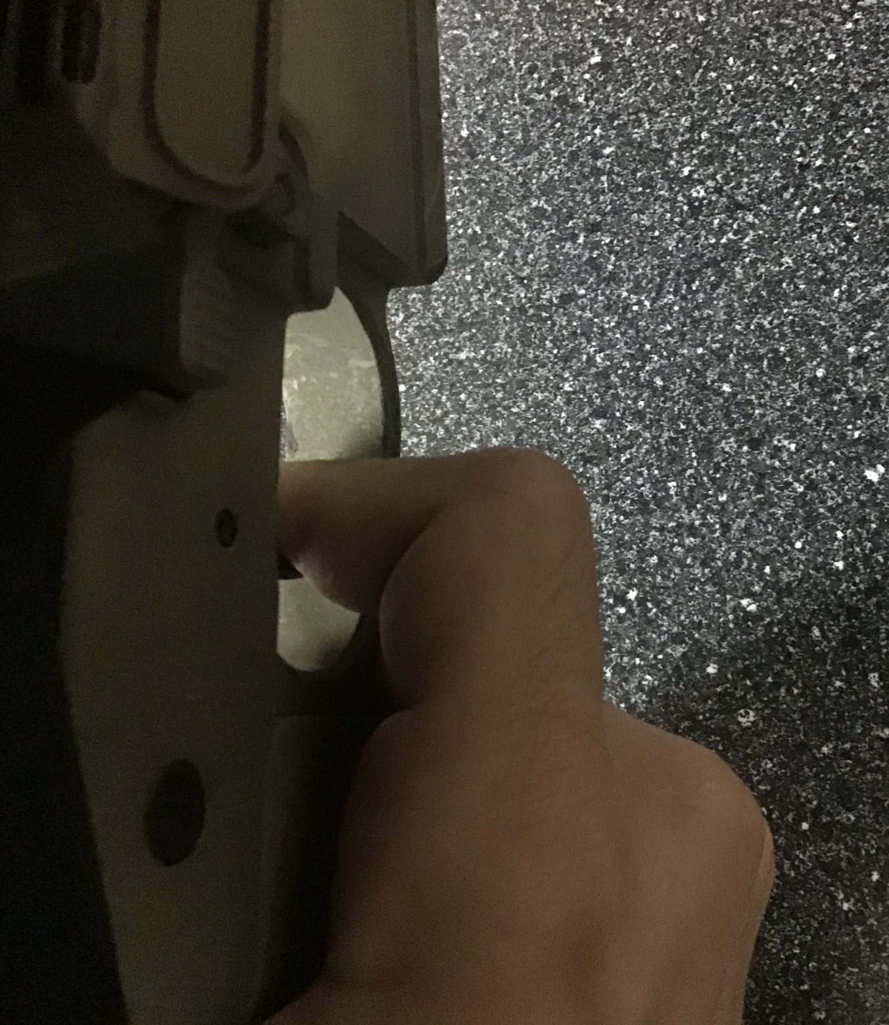

Maybe my hands are weird...with my trigger finger at 90 deg from the first knuckle I can line up the pad with either the outside/top tip of my middle finger’s first knuckle or the inside/bottom of the 2nd pad. I’m starting to feel kind of dumb...

Look at the Z-10, it’s got the flat bottom and is pretty slick

Z1 top
Z10 bottom
