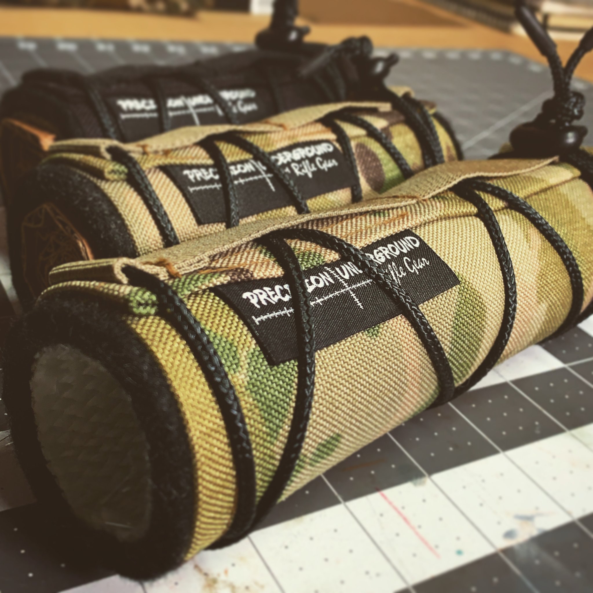

This is an interesting concept. I as thinking of bringing a fan to keep the barrel cool or even get a barrel chiller. I have been working on mapping the “cold bore” shot; this could be part of the issue. The 1st question Lowlight asked was if there was a surppessor on the barrel ( trying to rule out mirage from the can).
I will give it a shot!
Thanks!
Your best way to distinguish between eye fatigue or if you are seeing mirage from barrel/suppressor heat would be to do a long session of dry fire --focused shooting without firing a single bullet.

It sounds exactly like mirage. Especially since you’re indoors. We can help you with that!
