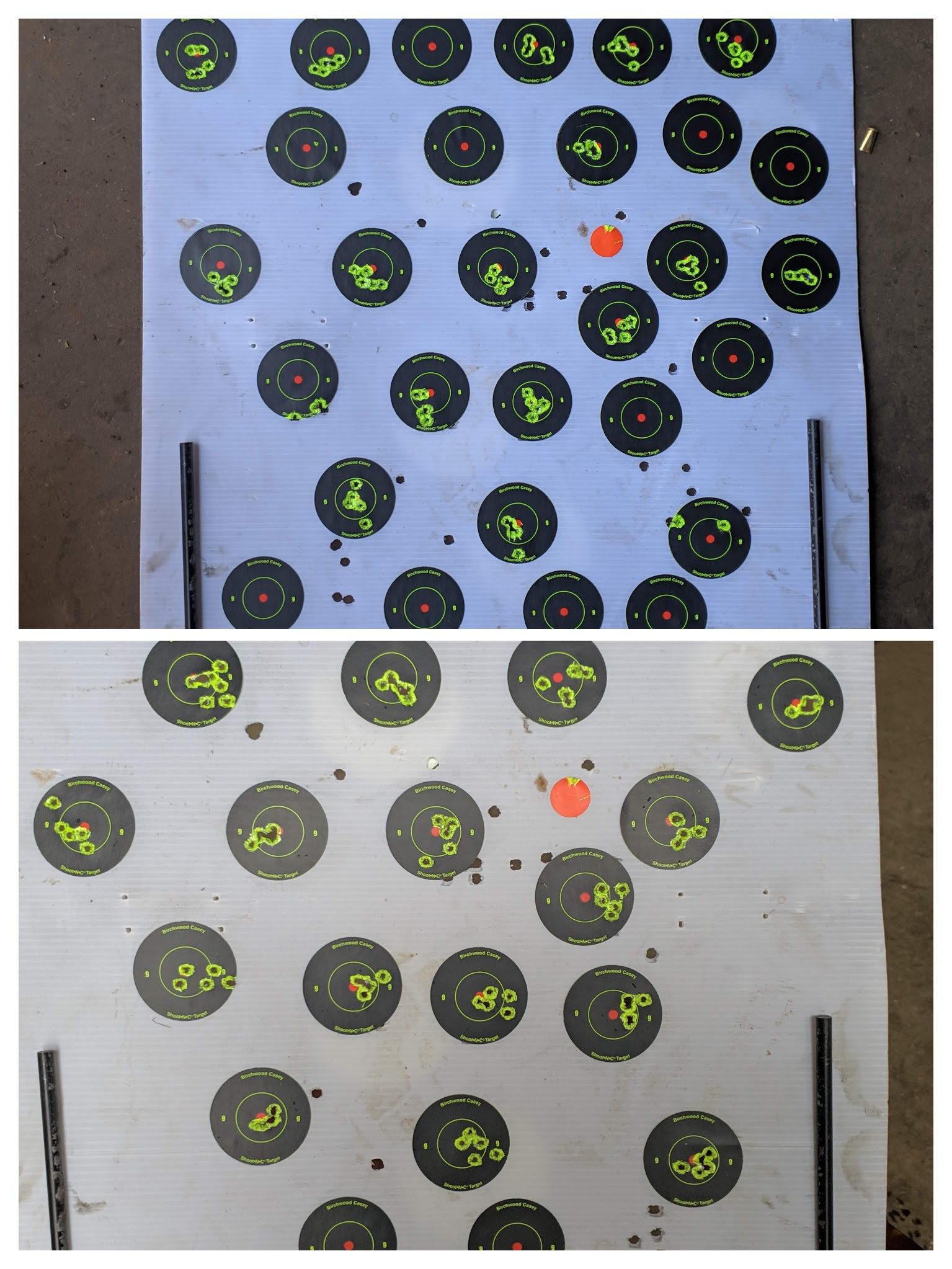

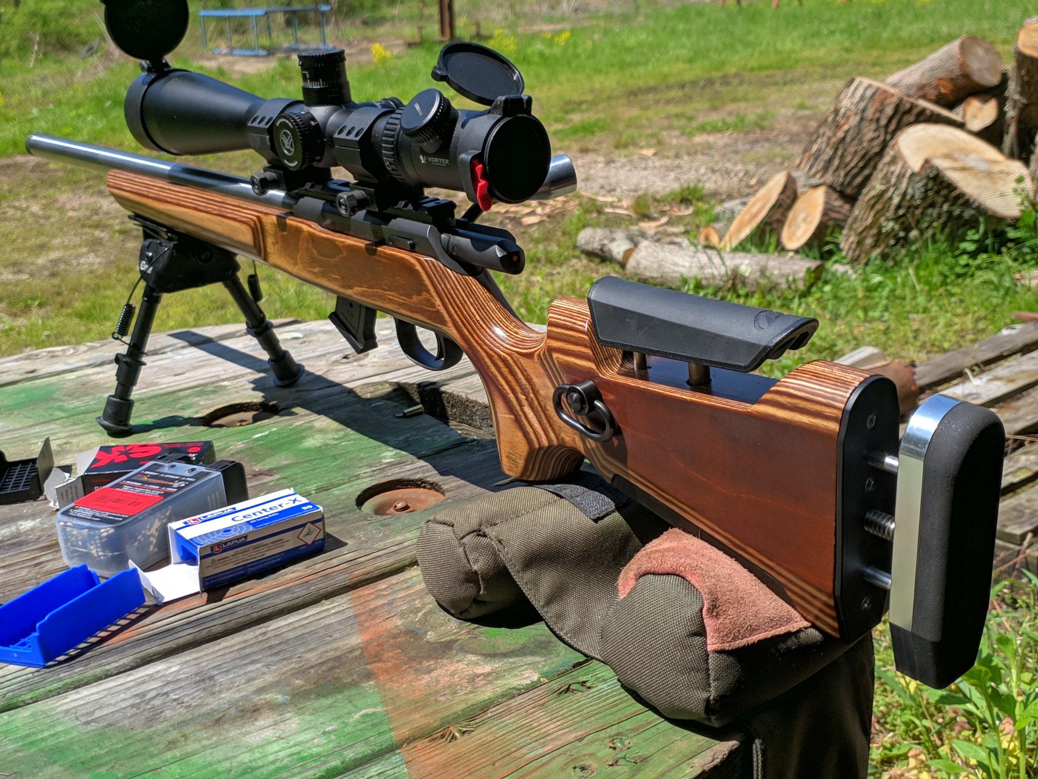

I realize this is a resurrected topic from January that has seen some recent action, but figured I'd drop in my 0.2c worth. I purchased an AT-ONE 457 a month ago and in the good graces of a simulated bank account, decided to try a LW drop in. I tested one day across 3 ammo types and none of them shot bad at all. The best was Center X though, producing several same hole and cloverleaf groups at 50. Fast forward a couple weeks and went to a .22 PRS match and shot remarkably well, this coming from someone that has shot more in the last couple months than I have in. 13+ years (thanks Ex wife).
The top picture is the LW barrel, bottom is factory. Not a HUGE change, but that upper right corner of Center X was quite good.
Edit:
The top row is SK Long Range (yellow box)
The center left and below is SK Rifle Match (red box)
The second row right side and the two under it were 3 groups of Center X
Several of the shots are getting back on paper after the swap, I don't have a boresight.
Edit:
