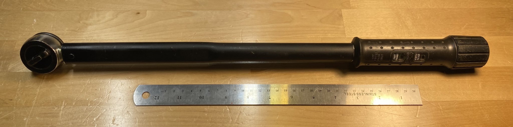

Another vote for the FAT wrench I also have a conventional 1/4" drive torgue wrench that serves the same uses.
When properly stored and cared for the FAT wrench will do pretty much everything you're looking for.
Just don't store it cranked down to its upper settings or below it's lowest setting and they are very servicable.

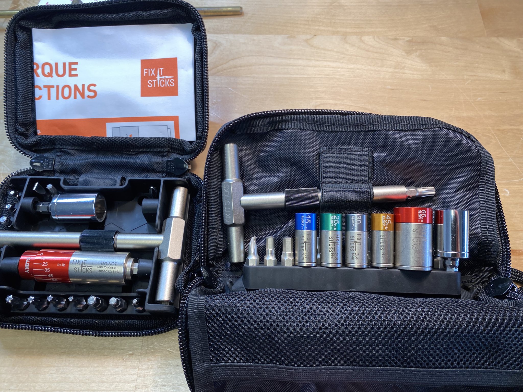

Had a borka, did not like the finickyness of how to manipulate it (inconsistent values depending on hold and angle), sold it.
Also currently have:
Fix it kit individual limiters set (settled on this as the winner a few years ago)
Fix it kit all in one set
Wheeler FAT torque wrench
Snap On ( shop certified) 1/4” torque click wrench.
Williams ( shop certified) 1/4” torque beam wrench
The kit I use the most is the fix it sticks individual limiters set with an additional 30”lb limiter and a long 3/16” ball end allen bit (used for chassis bolts). I use it almost exclusively at the range and at home as I don’t have to set up or watch the indicators line up. Just select the proper limiter , bit , and twist until you get three clicks. It does just about everything I need for torquing on optics and guns. That is the only kit I carry in the range bag
I have no problems using any of the others listed above that I own. My employer (aircraft industry) had torque verification calibrated testers for 1/4 1/2 3/4” and all of those were under 4% variation. That was a pleasant surprise that the wheeler fat wrench was that close and repeatable.
Everybody loves the concept of the all-in-one limiter, but I find it too slow and tedious when doing multiple fasteners, (like on a six screw scope ring set, 12 screws in a torque pattern with rising values eats a lot of time if you have to watch each tightening sequence line up the value marks).

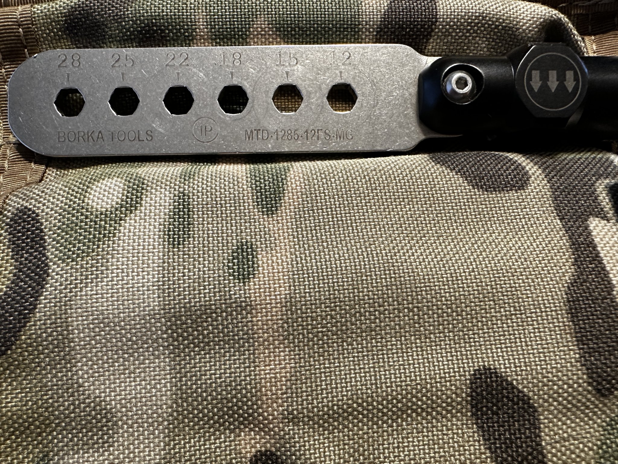

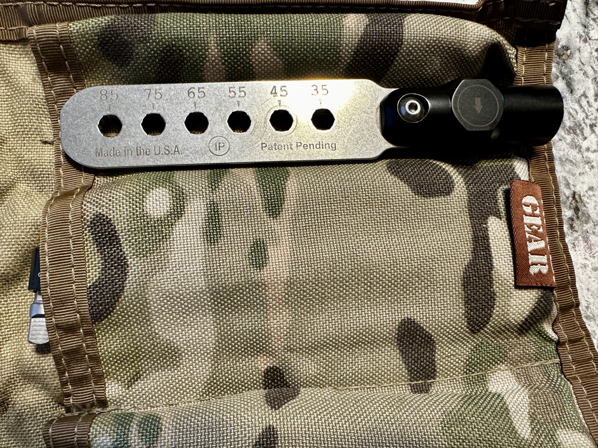

Although I am a very big Borka fan, I would not say it’s impossible. At some point / amount of use the wear of the hinge assembly could take it out of calibration.
Correct. The condition of the spring, ball, preload adjustment screw, the ramp/detent on the lever arm, and lubrication state of all those moving parts can all cause the borka to drift and go out of calibration over time. What the borka has going for it is the preload on the spring is fixed after the initial calibration and user adjustment of the spring compression is not the primary method of torque setting so the spring isn't negatively affected by being accidentally left at the highest setting/compression after use by the end user like a conventional torque driver that increases and decreases the compression on the spring to adjust torque.
I like the borka for a compact field kit but you need to make sure you apply the force to the handle exactly as Boris shows, or you can significantly change the applied torque vs the set torque, especially at lower settings. With an incorrect grip on the handle it's possible to apply 35+ in-lb torque before the handle breaks over even with the wrench set on 15 in-lb, I found this out while testing my borka in the calibration lab at work. The borka is accurate when used exactly as the instructions say but it is very technique sensitive because of the handle design which allows multiple incorrect grip styles and applications of force. Compare this to a screwdriver style torque driver which is extremely forgiving to use because there's only one way to hold it and twist it to apply force.
The technique sensitivity of the borka is why I only use it as a backup now, my primary torque drivers for gun use are 2 mountz EMT series screwdriver style drivers, 1 10-50 in-lb and 1 30-80 in-lb, that covers everything I've needed to do optics mount or action screw related. Mountz has a new 8-80 in-lb driver with digital display that would replace both drivers but I don't like a field tool that needs batteries, because then you really should carry spare batteries and the tools to change said battery.

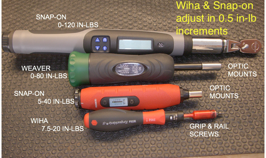

Snap On and Sturtevant Richmond also make very accurate digital 4-80 in-lb screwdriver style torque drivers (S-R is likely the OEM for the Snap On driver as they look exactly the same besides color and label) but they are rather expensive.
Wiha and Wera torque drivers work well and are reasonably priced, but they seem to top out at 50, 55, or or 62 in-lb, which isn't enough for many 2 cross bolt style rings/mounts like nightforce or badger. I wish both of them would make a higher torque range model that covers the 40-80 or 50-100 in-lb range that way 2 drivers would cover pretty much any optic or action screw related fastener on a rifle.
Tohnichi also makes very accurate adjustable torque drivers, but they're more expensive than wiha/wera and again, you'll need 2 to cover the entire range of torque values needed.

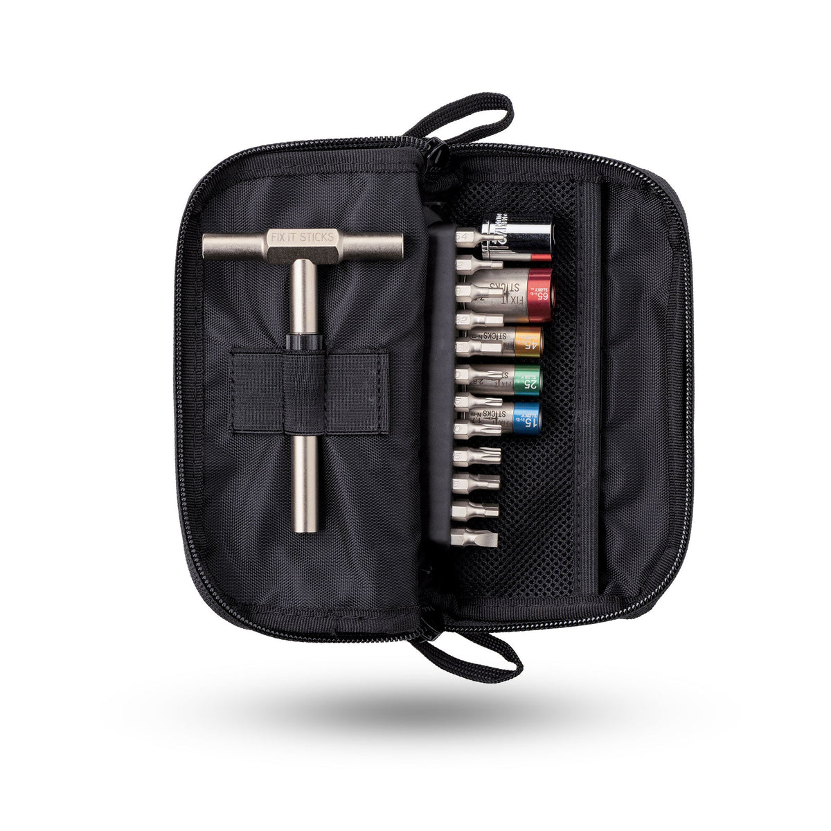

Or buy a fix it sticks set with all the appropriate torque limiters you need, even though the +/- 10% accuracy isn't as good as some of the other adjustable torque drivers. +/- 10% will probably not result in a slipping scope or stripped fasteners.
I have a Wiha set with numerous bits, etc.
I also have a FixIt Sticks optics toolkit with individual torque limiters and a bunch of bits. Nightforce has a similar scope mounting tool kit. (eligible for their military discount too)
