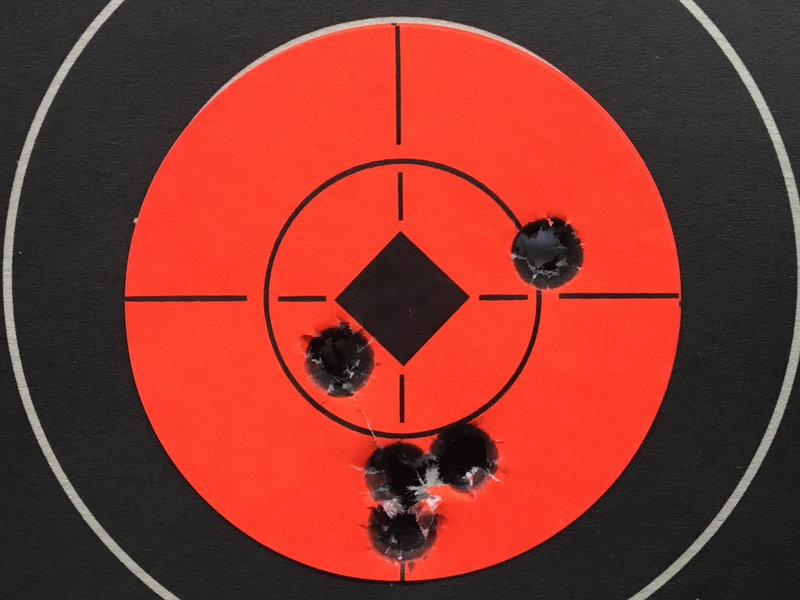

Got to the range again today. Brought a few lots of ELD-M ammo, both rifles, and a chrono. My other rifle is rock solid. Velocity is the same as listed before (2830fps). Regardless of the lot, this new rifle still chronos low. And accuracy has seriously gone down the drain. I've tried cleaning. I've tried leaving the barrel fouled a bit. Doesn't matter. I think part of the problem is heat. When the barrel is ice cold I can get a 3-shot group in the teens. But after 3-5 shots, accuracy seriously disappears and I see weird stringing. Not the case with my other rifle. I can shoot 20-shot strings and it holds true.
These groups are not cherry picked. I can pick up my other rifle and hammer out groups like this no problem:
[IMG2=JSON]{"data-align":"none","data-size":"full","src":"https:\/\/orig04.deviantart.net\/a4d6\/f\/2017\/241\/2\/3\/untitled_by_haftelm-dblr7by.jpg"}[/IMG2]
[IMG2=JSON]{"data-align":"none","data-size":"full","src":"https:\/\/orig07.deviantart.net\/0f07\/f\/2016\/220\/0\/b\/photo_5_by_haftelm-dad68ag.jpg"}[/IMG2]
[IMG2=JSON]{"data-align":"none","data-size":"full","src":"https:\/\/orig01.deviantart.net\/c7b7\/f\/2016\/220\/7\/7\/photo_4_by_haftelm-dad68ak.jpg"}[/IMG2]
This is the new rifle that's yielding low speeds:
. [IMG2=JSON]{"data-align":"none","data-size":"full","src":"https:\/\/orig06.deviantart.net\/193f\/f\/2017\/241\/8\/4\/untitled_by_haftelm-dblr7cz.jpg"}[/IMG2]
[IMG2=JSON]{"data-align":"none","data-size":"full","src":"https:\/\/orig03.deviantart.net\/89e1\/f\/2017\/241\/9\/d\/untitled_by_haftelm-dblr7bw.jpg"}[/IMG2]
[IMG2=JSON]{"data-align":"none","data-size":"full","src":"https:\/\/orig00.deviantart.net\/dc93\/f\/2017\/241\/d\/7\/untitled_by_haftelm-dblr7c3.jpg"}[/IMG2]
[IMG2=JSON]{"data-align":"none","data-size":"full","src":"https:\/\/orig01.deviantart.net\/eae3\/f\/2017\/241\/1\/d\/untitled_by_haftelm-dblr7co.jpg"}[/IMG2]
[IMG2=JSON]{"data-align":"none","data-size":"full","src":"https:\/\/orig05.deviantart.net\/c906\/f\/2017\/241\/4\/0\/untitled_by_haftelm-dblr7cs.jpg"}[/IMG2]
