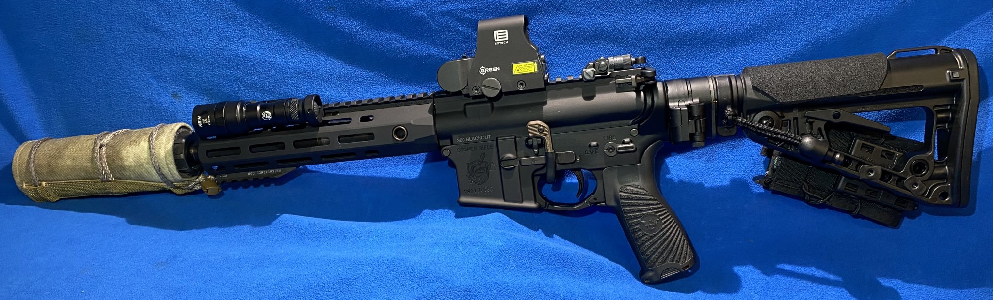

Wilson Combat has made-in-the-USA lower parts kit to which I usually add the Geissele SSA 2 stage trigger. I last installed them into a 9.5 " .300 BO KAC SR15/30 build.
