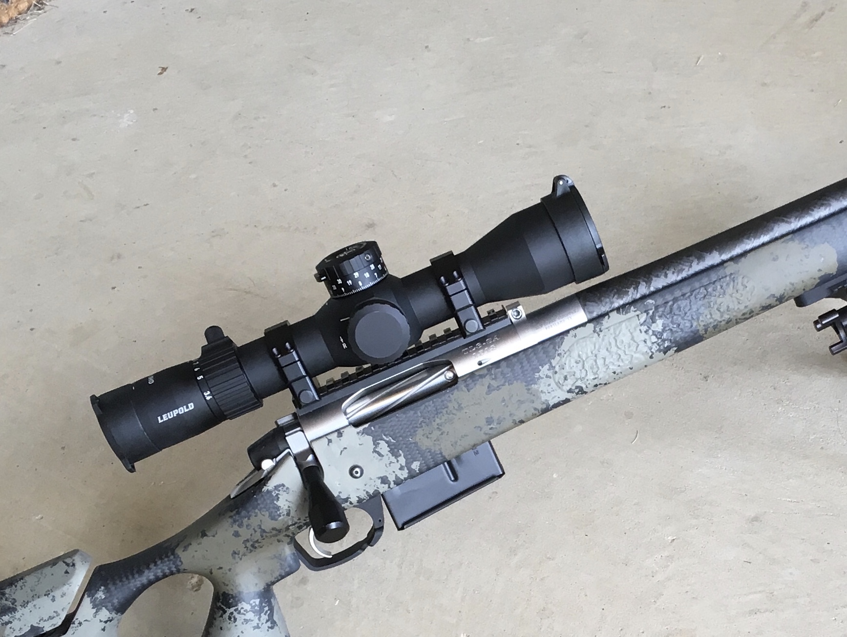

I did the same thing when i got a mk5 , i wanted the lowest rings, and the tps were as low as i could find also, was hoping joplin would do some at apa, his super low rings are awesome, i ended up with the tps for now, heres a reference pic on a 20 moa rail for a visual

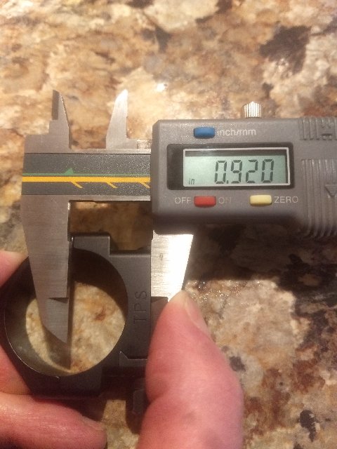

Are the TPS super low 35mms .82 or .95? I sent them an email asking for clarification, the in stock steel alloy rings say "35mm – Super-Low: .950″ (24.1mm)", while the out of stock super low aluminums (yes the 35mm page) says "30mm – Super Low: .820″ (20.8mm). "
So one of those is obviously a typo, and if I look at the 30mm super low I see "30mm – Super Low: .820″ (20.8mm)." - Which this leads me to believe that their 35mm super lows are in fact .95, and that the .92" Seekins and now .885" Hawkins would indeed be lower. As well as the .94 ARCs...
