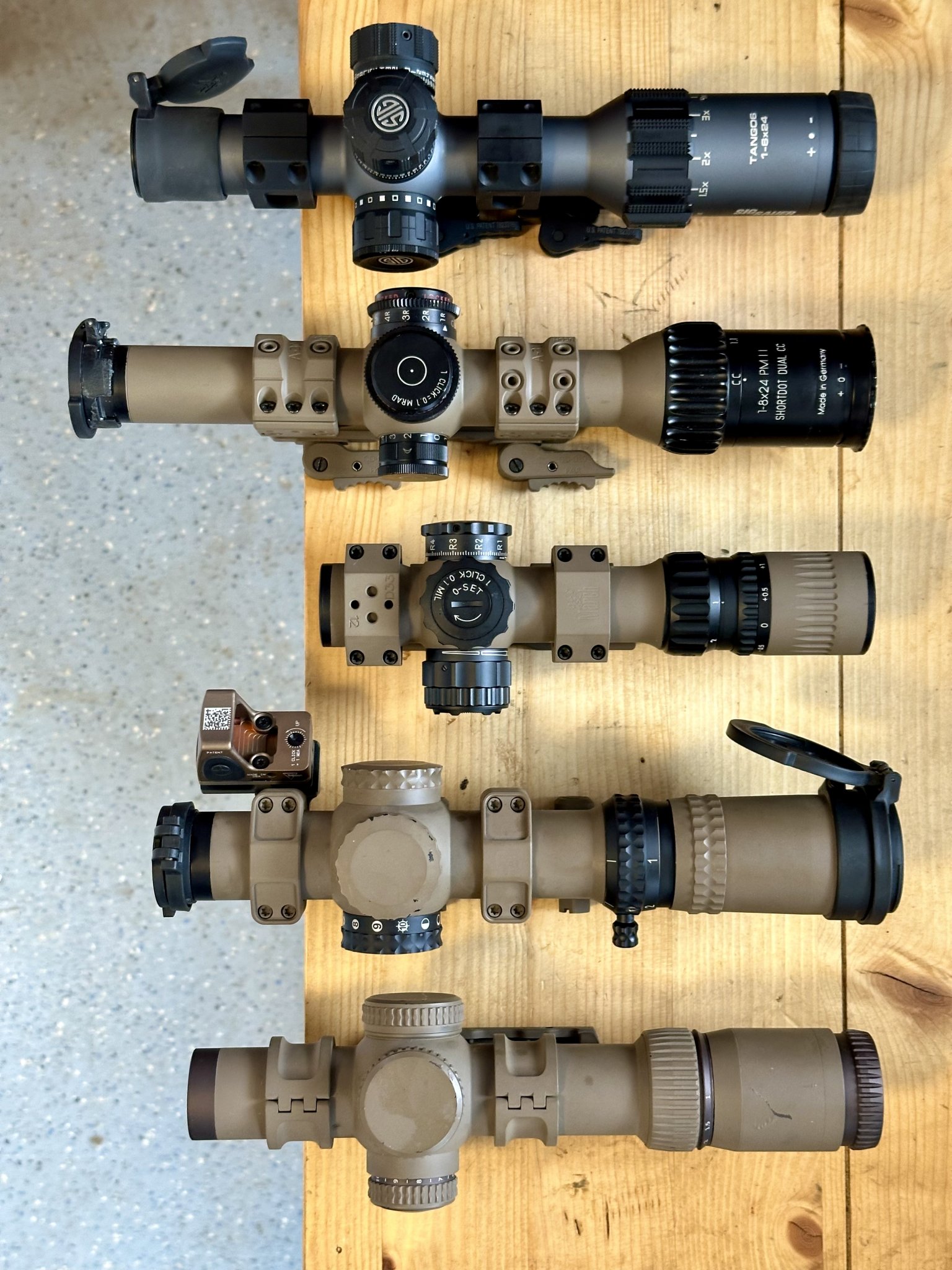

I currently run a atacr 1-8 and a gen 3 razor on two 14.5. Prior to these I ran a sig tango msr 1-8 for some time. The msr was great for a budget optic. Built like a tank and glass was good for the price.
The razor and atacr have better glass and illumination of course. The build quality on these two are pretty outstanding.
I don't skimp on mounts though which I do believe provide more protection than most realize if it has robust and wide rings. The vast majority of my stuff now is either Spuhr ISMS or ARC with a few NF Ultra mounts thrown in.
