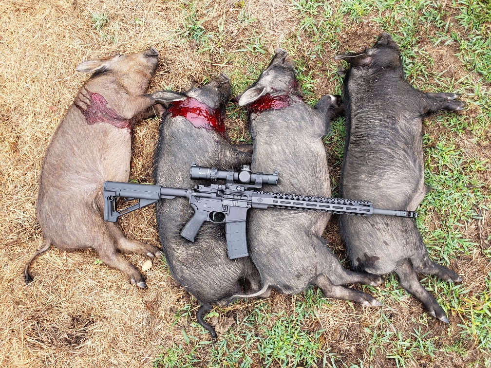

I've also found that shorter throws on a hunting LPVO are advantageous (I'll assume in tactical applications as well...but I've never been issued an LPVO for combat, and I'm retired now so I don't see it happening). For example: Last year I had an entire sounder (group of hogs) consisting of shoats (younger hogs) show up below the house one morning as I was eating breakfast. I grabbed my AR that sits on top of the china cabinet and ran out to engage. I snuck around a tree and got within 35-40 yards of the sounder and took a well-aimed first shot. My optic is a Burris XTR II 1-8x, and I was on 8x. I immediately realized my mistake as a dozen shoats took off for the trees in different directions, and I was trying to pick up runners with way too much magnification. I gave my scope's magnification a crank down without looking and got back on the trigger. I was able to pick up three more runners before they made it to cover about 100 yards away. I later looked, and had adjusted the magnification down to about 3.5x...that was as far as one quick wrist turn would get me.
I think reticle choice is important too, however that is a little more dependent on application in my opinion. Tactical reticles work better in hunting applications than vice versa I've found so far. However, I only own two LPVOs so my experience is not as great as others. But I do carry my guns with them frequently out here on the ranch too, and have killed quite a few moving things with them, so there's that.
I'm certainly not on here to recommend one brand over another. Rather, just to add that sometimes the parameters that we hang ourselves up on when it comes to selection aren't as much of a deal breaker in the field.
"that was as far as one quick wrist turn would get me."
I've noticed that a lot of optics nowadays either come with some sort throw lever or at least have one available on the aftermarket. That should help mitigate how much you can zoom in/out with a quick twist. Nightforce even has multiple spots on the magnification ring that you can place the throw lever per personal preference.

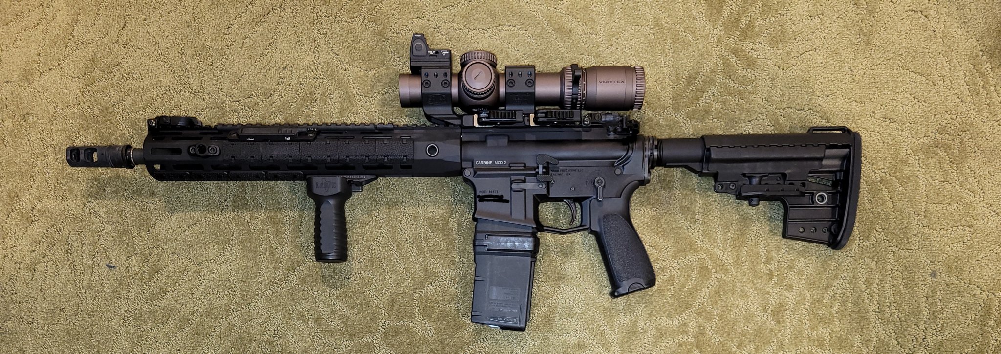

I'm very satisfied so far with the Vortex Gen3 (mrad) . I've been floating it around several of my builds to find its home.
As mentioned many times , there is no "perfect optic". They all have draw backs. IMO, this explains the additional RMR for close activities if needed quickly. The eye box is excellent at 1x and expectedly tighter at 10x. I recommend no higher than a 1.50" mount for a solid/repeatable cheek weld at max magnification. FYI - from my experience on this optic, the mount you choose may cause you to hate it at 10x if you go too high.
