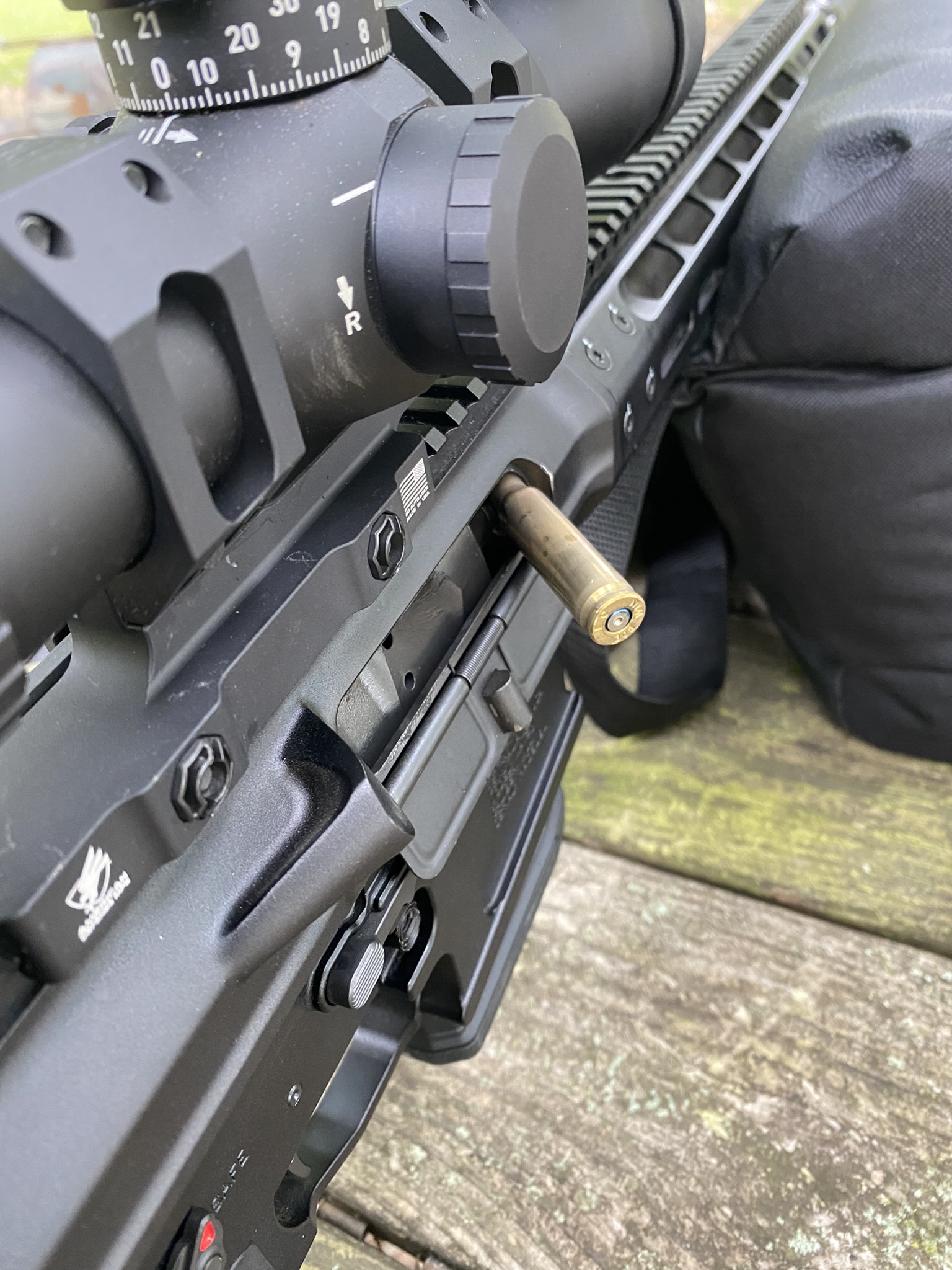

Is there a term for this malfunction? I'm decent with the search bar but coming up with a search term for this has me stumped.
The rifle is a home-assembled LR-308 chambered in 308 and suppressed with a Silencerco Saker. It has a 16” barrel with a rifle-length gas system and adjustable gas block. The buffer system consists of a JP Silent Capture Spring with the lightest spring and a standard carbine tube.
Thanks for your time.
Attach a fuzzy side of adhesive backed Velcro to your empty case deflector .... just to see if it is some how bouncing off it , and back towards the ejection port.
You aren't running a empty case catcher are you ? My 9MM PCC kept bouncing the fired case back into the action, with a case catcher.
And all the other suggestions have valid points.

Thanks for this input. I’ll keep a close eye on the angle the case deflector is sending casings while adjusting the gas. Not running a case catcher. I’m shooting off a bench in the open with nothing near that could bounce the casing back towards the rifle.

Another vote for overgassed. Very overgassed rigs can let the fired case linger in and around the ejection port causing this. A too fast BCG speed fucks with the ejector/ejection.
Oddly enough, your case head looks healthy though. Usually there is ejector smear/gouge.

I’ll get a list together when I get back to the range in a few weeks. It’s been a few years since I assembled it and don’t want to give assumptions in a response.
Thanks for your input.
I’ll keep a close eye on the casings the next time I take it out to adjust the gas.
Thanks!
You answered some of them already, and from what everyone is seeing, I'm fairly sure about the issue but let's get all the info.
Since you are running suppressed we can focus on that. Both volume of gas and pressure is elevated beyond the intended parameters of the original design/set up. Your bolt is being pushed back harder/faster, so that needs to have an appropriate reaction on the other end(recoil system) or it speeds forward (after bouncing maybe) hitting that spent round before it can be sent on its way.
