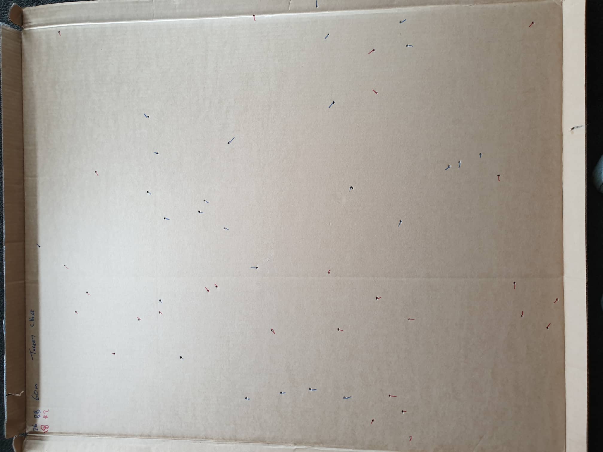

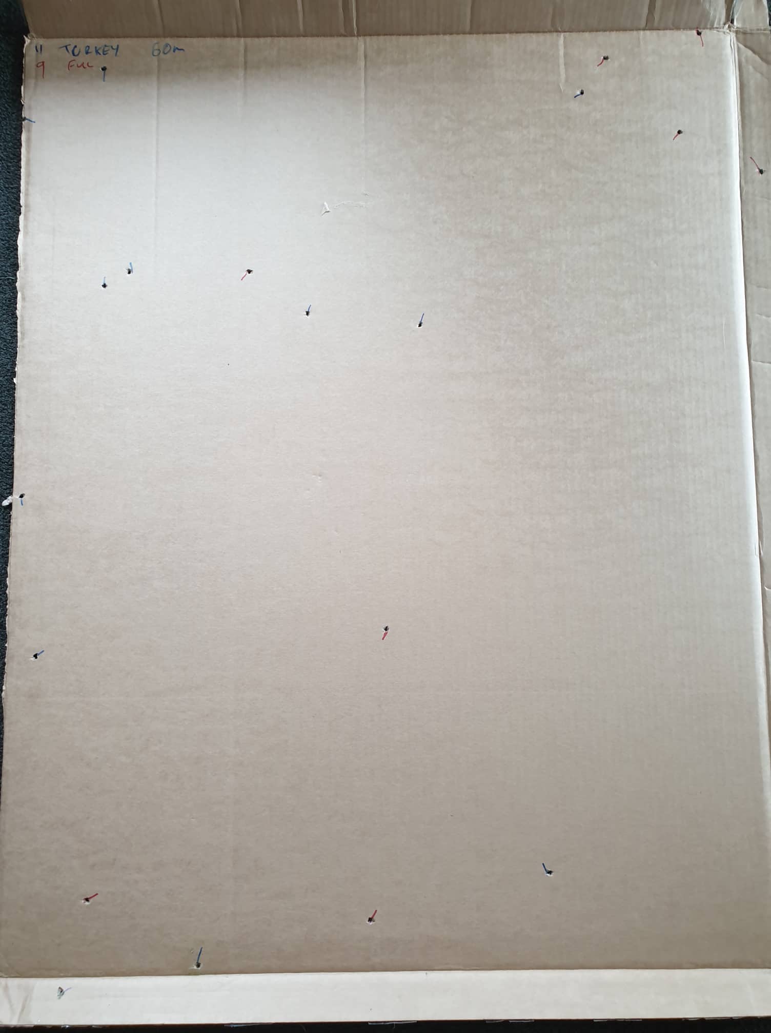

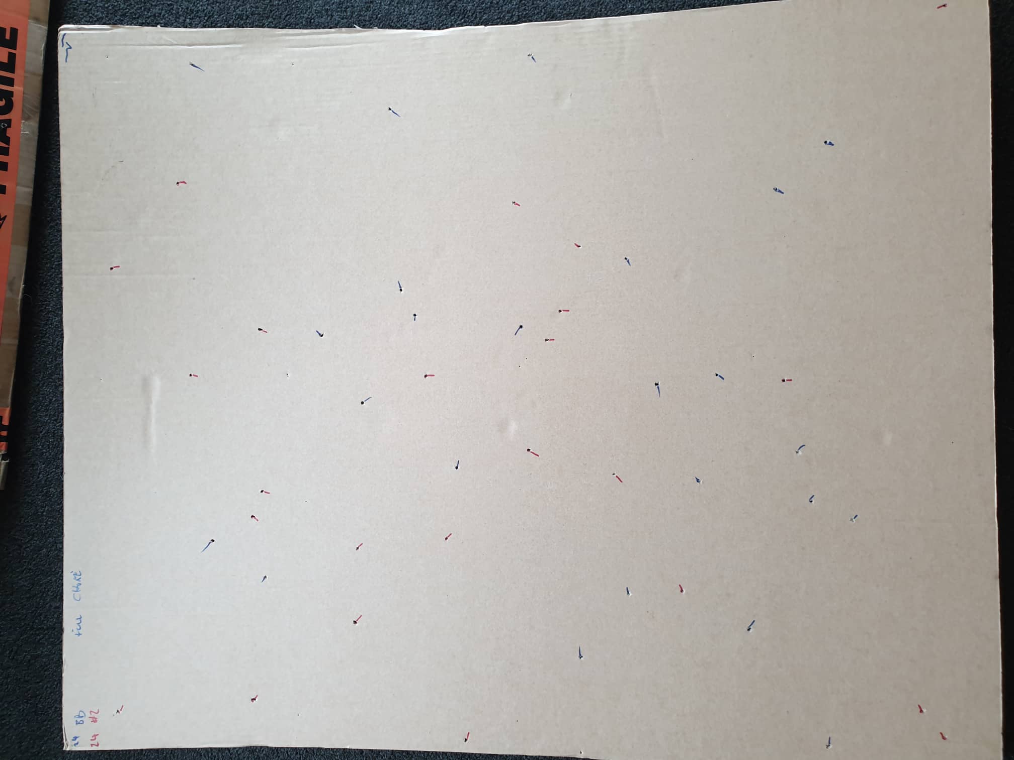

It took forever but I eventually managed to buy a Turkey choke to test, due to not living in the USA my options were limited so ended up buying a .660 choke, this is a bit more choke than I'd have liked but was the best option I had.
I tried patterning both the turkey and my full choke at 60m, with #4 buck 1 1/2oz #2 lead and 1 1/2oz BB lead.
Here are the results at 60meters, I shot both chokes with #4 buck on the same target (indicated with different coloured markers), the full choke with both cartridges on one target and both loads with turkey choke on another target.
Targets are roughly 32" wide 40" high.

I didn't expect great results as the .660 choke is pretty tight for such big pellets, with all cartridges the turkey choke put more pellets on target (less than 10% more) but with a worse pattern.
Maybe the #2 did better in the turkey choke but it's a bit of a toss up.
I have had good luck killing peacocks with both the #2 and BBs but most shots have been fairly close range, based on my results I won't be trying to take any extended range shots anytime soon.
I intended to pick up some #4s and see how they go, but at this stage will likely stick to the full choke.
