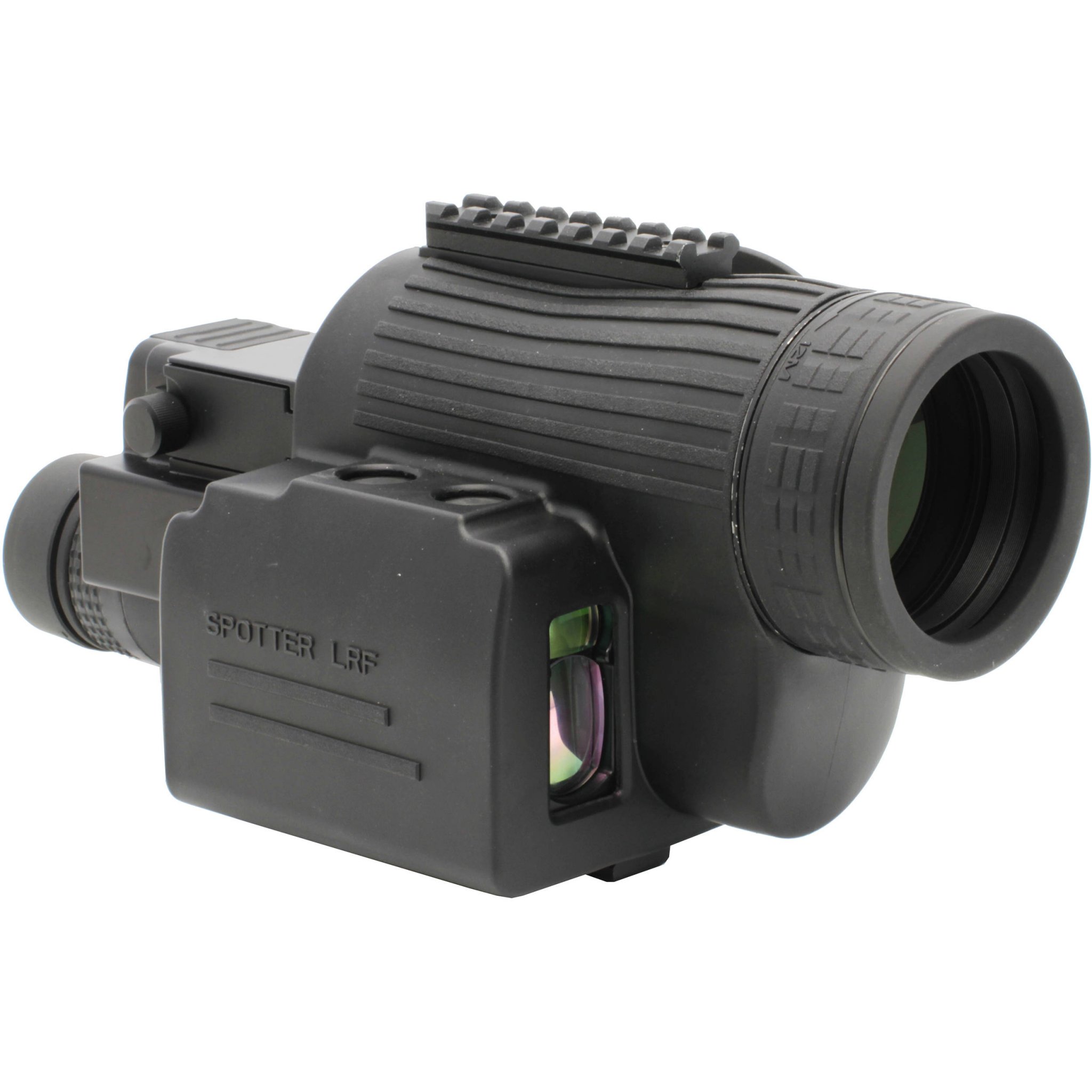

Newcon makes a LRF spotter , which costs $$$ but last time i have seen it on IWA show it looked like some DIY project not someting in serial production

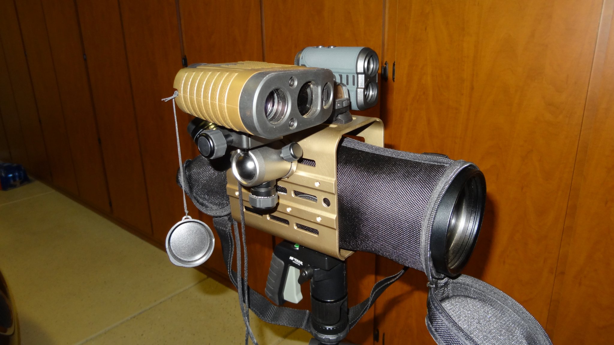

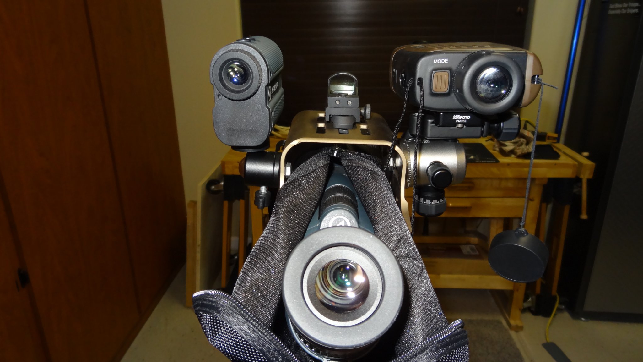

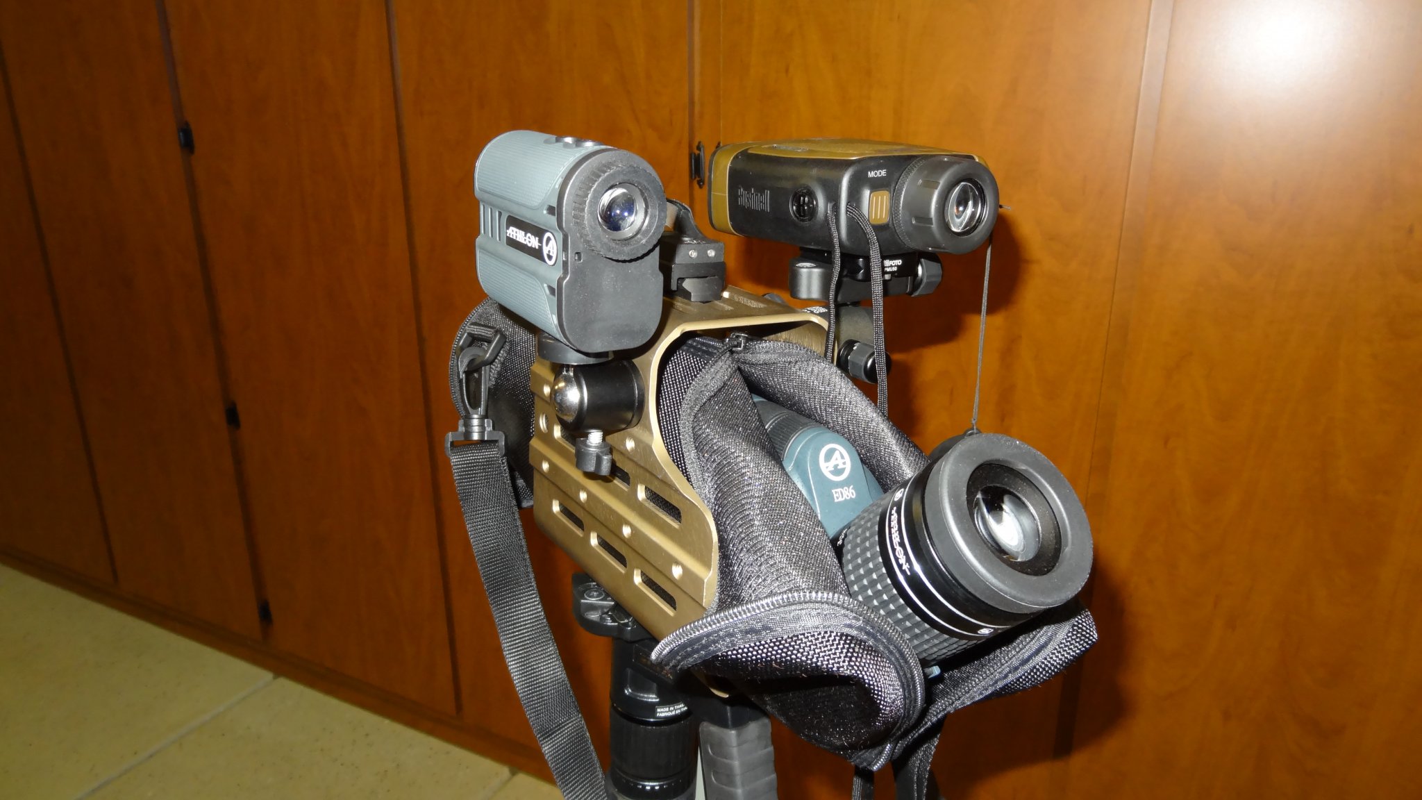

Hi
I have been putting these together for some friends. PM me if interested and I could order another batch of parts. I use a red dot for fast acquisition, RF for range and 60 or 86 mm spotter. All are co-witnessed for fast targeting and follow up spotting calls. Yes, this has 2 Rf on it, I was testing one against the other and vertical v. horizontal mounting. You can mount just about anything together. I set one up with 4 scopes for comparison use. I also have a bar that will hold everything on a horizontal plane if the box is not right for you.
