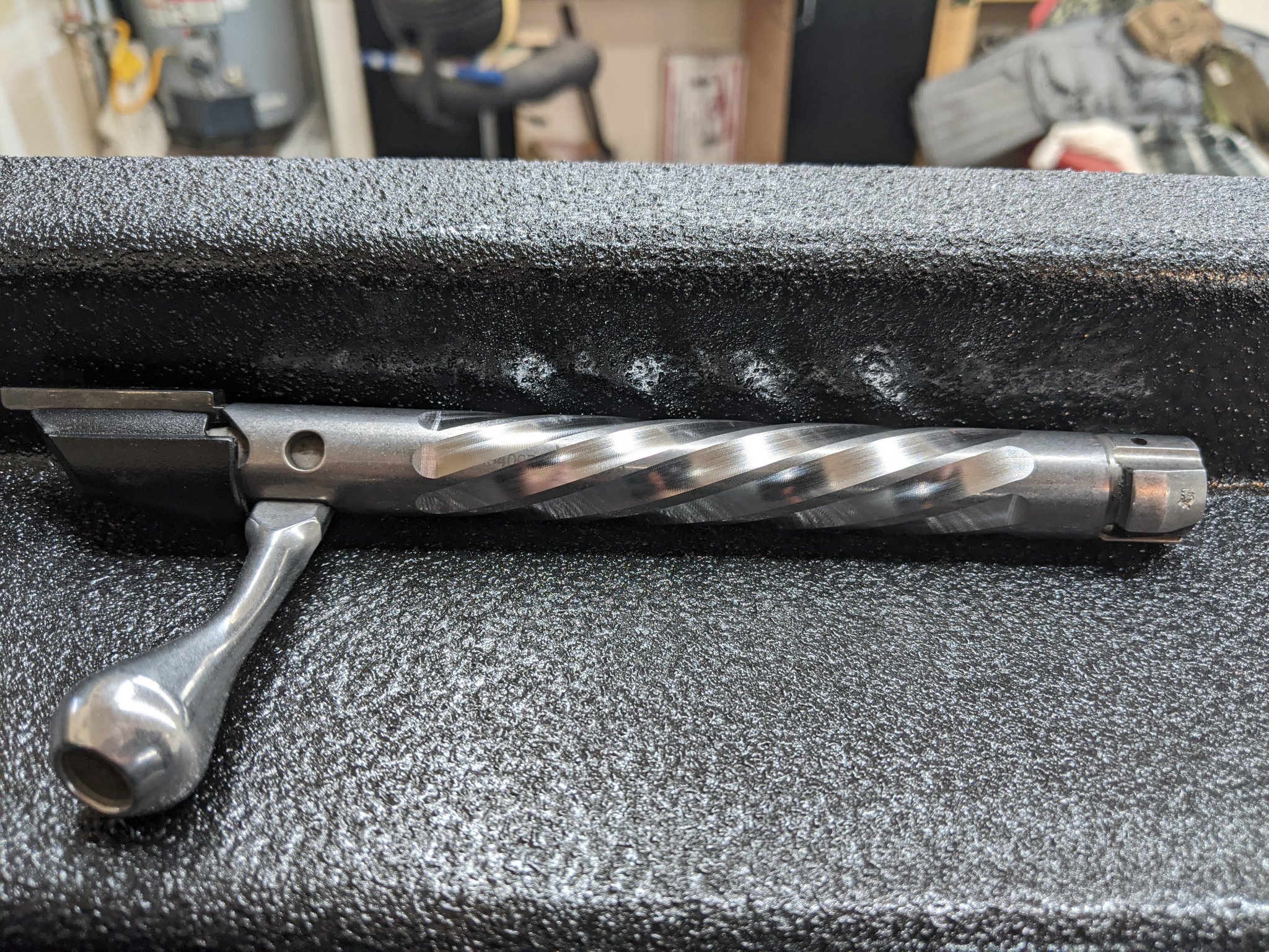

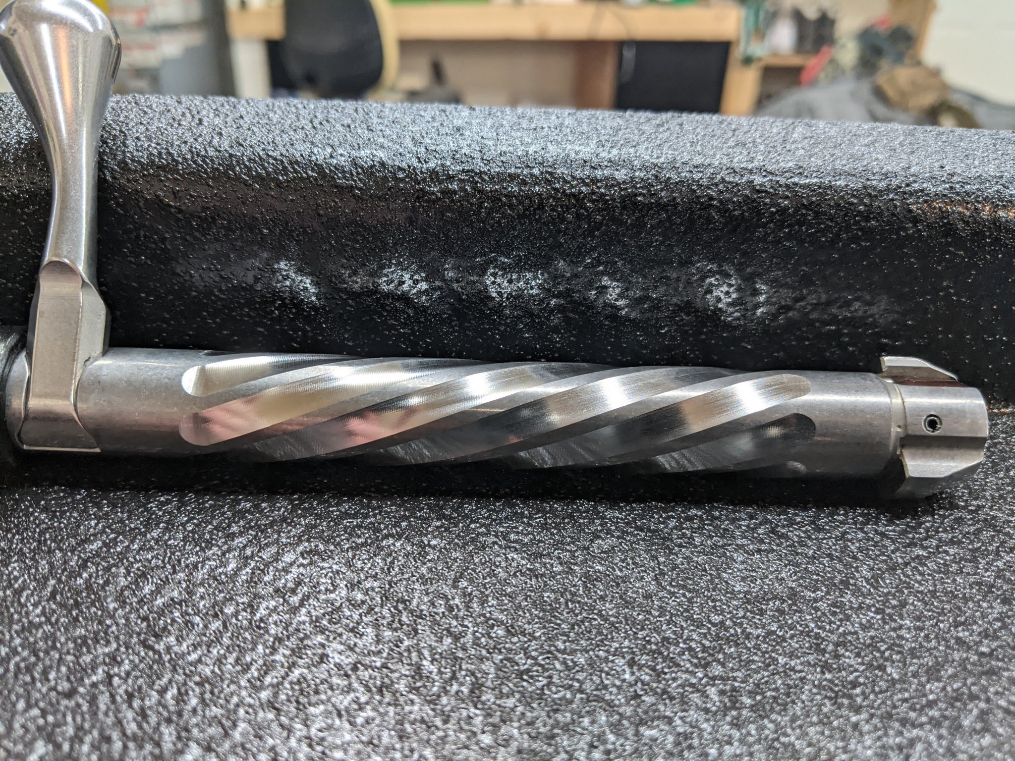

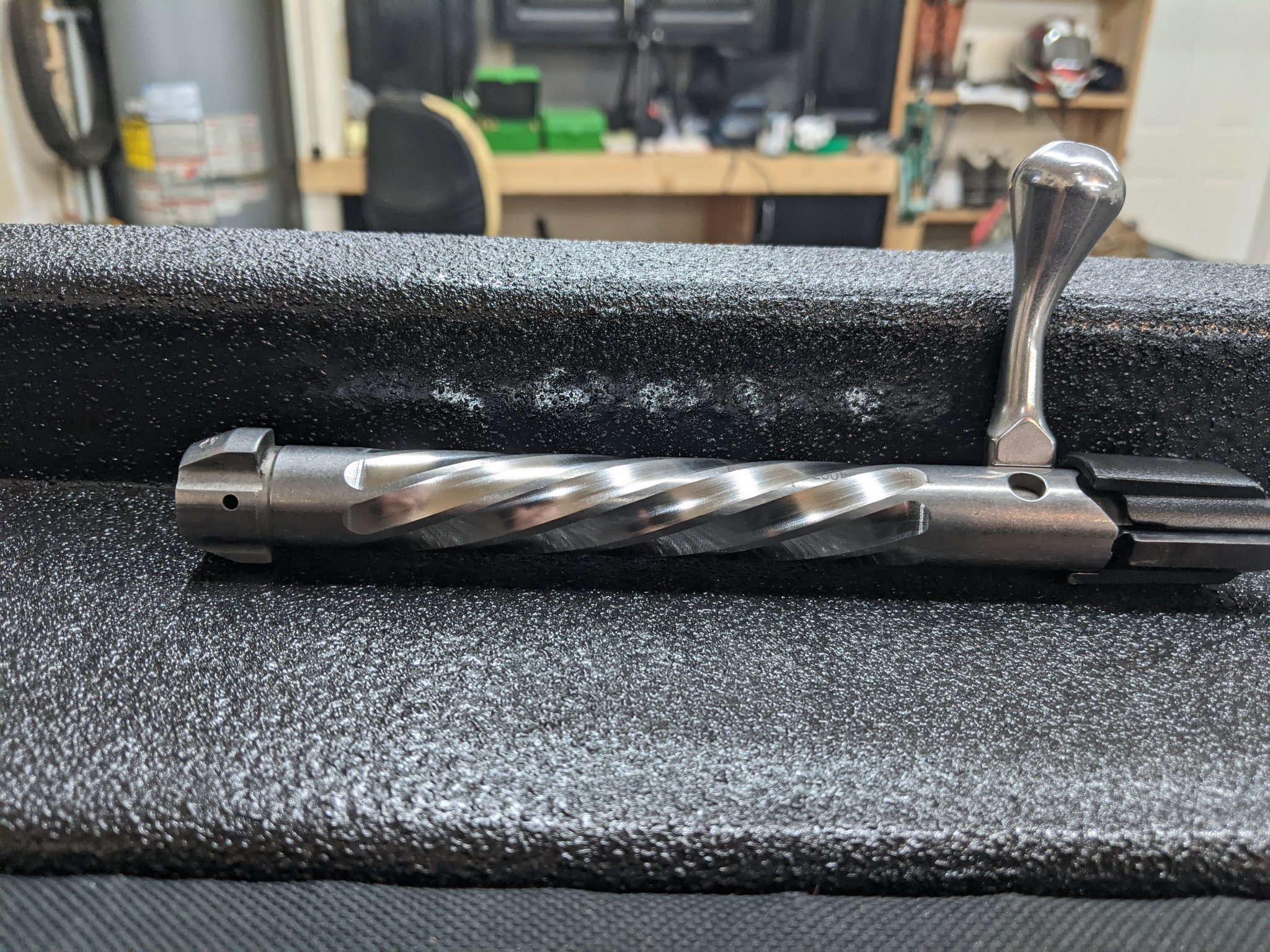

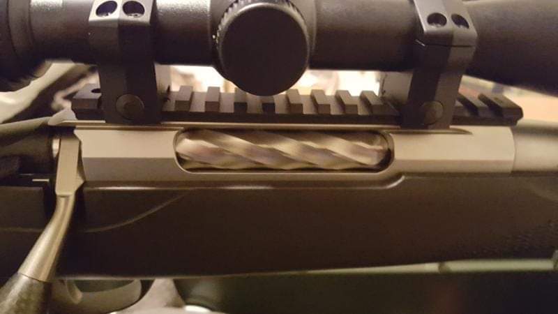

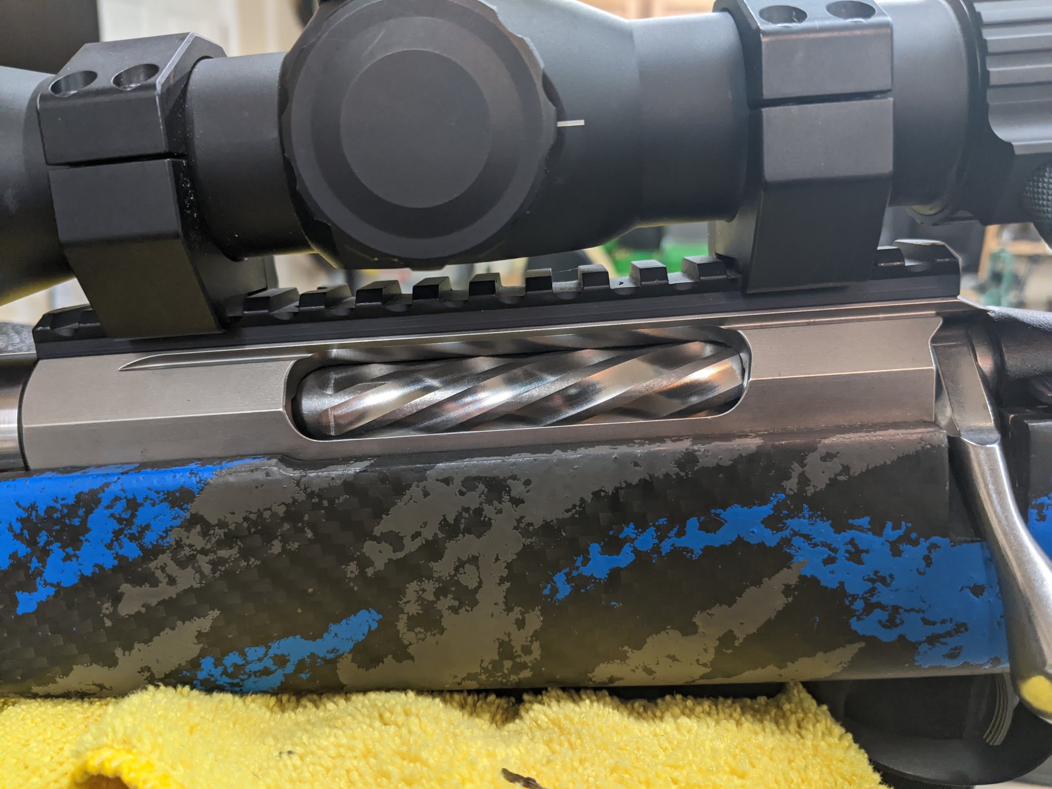

Id like to get some opinions on this, I just got it back and IMO it's not done correctly. Not from what I have seen from other flute jobs they have done. Here is one that looks correct, and mine. It appears to me that the flutes stop (or start) in the wrong spot.
I emailed LRI with these pics and this is the response I got.
I just checked my programing, both left and right hand start at the same position. From your pictures it looks as though your ejection port is longer in the front by the width of the scope base screw. The top picture the front of the port looks to stop behind the screw, where yours ends at the front.
Unfortunately I can not move the flutes any farther ahead on the bolts without running into the locking lugs.
Is your tikka a T3 or T3X?
Opinions???

The radius of the cutting tool is the limiting factor. If you want flutes cut in the face of your locking lugs, I'm sure that could be accomodated.......
All kidding aside, LRI has an impeccable reputation and I'm willing to bet they cut the flutes as close to the lugs as they could, without actually cutting into the lugs (A. Bad. Thing.). Functionally, the way the flutes are now, there are no negative side effects.

It looks like the "ideal" image is a Tikka T3 and yours is a T3X which has a larger ejection port. Arguably the fluting could be exactly the same, you're just seeing more of it.
Look at the bottom picture, see the front screw hole over the ejection port? Look at the top picture, see the screw hole over the ejection port?
Not enough detail to tell. But you can quite easily count pic rail spacings. They’re a standard.
Here’s Tikka LRI bolt.

They look like two different brands of rails. The spacing is standard. The mounting screw location is not. The picture of your bolt does show a lot of room foward.
The bolts in the pictures are apple and orange comparisons to me. The flutes in the first picture are either deeper or cut with a larger diameter tool than the first bolt. Look at the flats between the flutes. Little to none in the first picture. Chad is a smart guy but he still has to turn a profit. Maybe he is using a short shank ball tool to run it harder (Faster) and the holder is keeping him from getting closer to the lugs.
So Chad is saying that he can not move the bolt in the mounting fixture with out hitting the lugs? Not hitting the lugs as in cutting into them?
One over hangs the front of action by one third of an extended stanchion. The other truncates the first stanchion flush with the action.
They both start the first space in the same location.

You need a pic of your bolt and a "properly fluted bolt" side by side unless you can hold them side by side and measure to be certain.
With cnc the machine doesn't just decide not to flute the entire length one day, unless the zero coordinate somehow got offset, it does the exact same ops to every bolt using the same program.
Are those pics both lri fluted bolts?
The first pic appears to have been done with a totally different tool, a bigger endmill, makes me wonder if that's a totally different company.
In the first pic if you zoom in I think you can see the end of the ball endmill cut, it's just hidden by the shadow, so it'd be very similar to yours with proper lighting if that's the case I think?

Again, I'm not trashing LRI or anyone, just questioning why it looks different than all the other Tikka bolts I have seen done by LRI.
Chad was NOT the machinist that did the fluting. Kalyb is the guys name who did the fluting and emailed me back.

Could it possibly be because the flutes on the other Tikka are larger? If you compare the two you can see yours are smaller and have more surface area in between flutes. I think if they were larger a lot of that untouched space on the end would be taken up. But cant say if that would make them look identical.
but I’m with the OP here. Cosmetic or not. See a pic, send it in to have that done, and it comes back different. Not bashing on anyone, but I would be a little bugged also.
