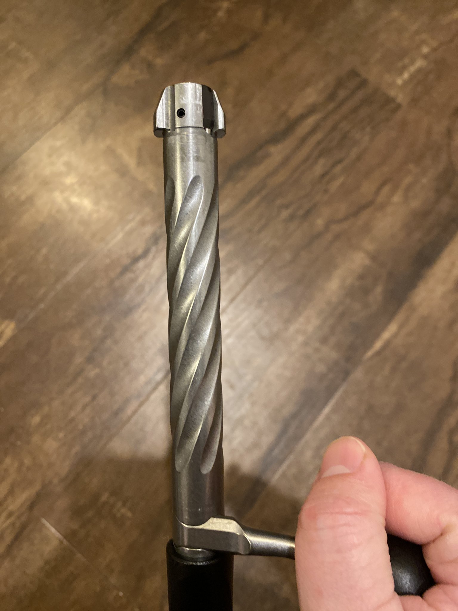

Could it possibly be because the flutes on the other Tikka are larger? If you compare the two you can see yours are smaller and have more surface area in between flutes. I think if they were larger a lot of that untouched space on the end would be taken up. But cant say if that would make them look identical.
but I’m with the OP here. Cosmetic or not. See a pic, send it in to have that done, and it comes back different. Not bashing on anyone, but I would be a little bugged also.
The flutes on the other definitely look deeper. Maybe just shadow? They definitely aren't very deep on mine.🤷
I've sent 2 barreled actions off to LRI for bells and whistles, and did not get fluting. Fluting is cosmetic. Don't get cosmetic surgery and then regret it. Just drive that rifle--it will shoot great, and the flutes are just candy. They look great to me fwiw.
Well crap. I thought my rifle head a fluted bolt like it shown where it's shorter than the ejection port. Apparently I'm thinking of an old rifle.
In any case, I wouldn't be concerned about it at all. The only question is whether or not it's mechanically sound
It looks like the first .5" of flutes from the bolt are covered by the reciever. Is there any way to measure both receivers? As in length of the ejection port and where it starts and stops. I am NOT a machinist. To me the bolt looks even.
Yep, looks even to me. My only question was about the flutes on the back of the receiver stopping under the receiver and the front not. Looks odd to me. 🤷
Here is a pic of my tikka factory fluted bolt from my new t3x veil wideland
Does this count as a "First World Problem"? Just kidding....I'd shoot the shit out of that rifle.
I have one rifle with a fluted bolt, a POS Mountain Ascent. I am just not a fan of the fluting of the bolt...but my opinion might be jaded because this truly is just a 1 MOA rifle (as guaranteed by the manufacturer). I have a 1903A3 from 1943 that is more accurate.
You will always having tooling marks unless you polish the surface to remove the tooling marks.
I think what I see is a bit excessive, and would expect better for a top-tier job.
I'd be surprised if Chad says that's as good as it gets from his shop.
I know the barrels I've had fluted by him never looked like that.
JMO, calling it as I see it.
If we agree they fluting is only cosmetic (not sure I agree) and the owner does not like the cosmetics then there is an issue.
He basically got a C cup on the right and a D cup on the left. He wanted D cups and now looks lopsided.

A mill finish has to have tooling marks its just the nature of the process, that is why you either surface grind or manually polish if you want a higher finish above a mill finish.If you view the photos on LRI website all the bolting fluting shows tooling marks which is standard for the process.
i thought both looked pretty good. i think your reference point is relative to the ejection window whereas perhaps to the expert its relative to datums on the bolt.

And, it’s an example out there of how a tikka bolt with that ejection port and those particular flutes look. Fluting is not just cosmetic, but it’s definitely part of it. Now someone who was considering this may be able to change their plans if they don’t like the looks of it.
The bolt fluting program written for Tikka actions is at least 7 or 8 years old now. It's not changed one bit in that time. The machine is a 4-year-old Haas VF-2. The tool package lives in that machine because it's what we do all the fluting on. -and we do a metric shit ton of it.
EDIT: It's not changed in the sense that once it's vetted in the control, that's it. We DO however add to the library of options.
The 4th axis and tailstock live on that machine as well. They are bolted to a subplate that's machined, stress relieved, and ground. It has not come off the table since buying the machine new in 2016. The collet that goes into the 4th is the same collet I machined 12+ years ago.
So, unless there is some cosmic force at play, the fluting is the same from one bolt to the next.

The bolt fluting program written for Tikka actions is at least 7 or 8 years old now. It's not changed one bit in that time. The machine is a 3-year-old Haas VF-2. The tool package lives in that machine because it's what we do all the fluting on. -and we do a metric shit ton of it.
