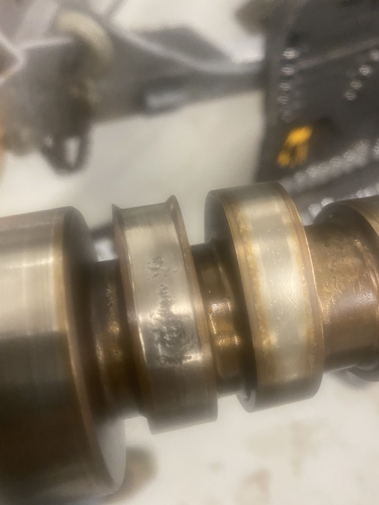

I have a work truck with an LQ4 6 liter that had the oil pump fail. I had to limp back to my shop a couple miles, with virtually no oil pressure. Came to find out the cam was smoked too. Replaced cam, timing chain, lifters, pushrods, valve seals, and of course the oil pump.
Upon reassembly, startup oil pressure was reading 20 psi. Once the motor fully heated up, oil pressure dropped to 2-3 psi. Figuring I must’ve damaged the oil pickup tube o-ring during assembly, I tore it all back down, checked o-ring and replaced with another OE part and reassembled. Upon reassembly, it has exhibited the same behavior.
There’s no significant bottom end noise, but I’m assuming I have a bad rod bearing based on a light knock when the motor is gradually increasing rpm during light acceleration, and have ordered bearings as well. I had visually inspected them when I had the windage tray off and attempted to wiggle them all to verify. I’m assuming they may have been damaged from the 5-10 drive with low pressure.
Is there something I’m possibly missing? I understand the cam bearings “could” be a culprit, but have doubts about that. Any LS techs here ever experience similar problems? Motor has about 230k on it.
It registered up to 15 psi over the couple miles. As low as 3-4. I’m really hoping it’s not trashed. No indication of spun bearings, but I’m sure they will tell the tale when I get them out.
Cam was wiped out long before the pump went

No way I'd waste time with the cam when you lost oil psi and drove it. It needs a complete tear down.

Dude, you wiped a roller camshaft. That in itself is quite an accomplishment.
Your crank is all probably all grooved up and the oil galleys in the journals are full of bearing material. I admire your optimism, but you're trying to band-aid an engine with serious problems and 250k on the odometer. Don't spend too much time and money fooling with it.

As stated above the engine is trashed. Don’t waste any excessive time or money in band aid fixes. Your taking a lot apart so you clearly know what you doing. Look at that lifter and cam lobe. You know the real answer lol. Your just looking for support/ hope for a miracle... we’ve all been there lol

You dont know LS engines do you?
That cam/lifter failure is EXTREMELY common.
Its not so much the cam, but the lifters that are garbage. The spring fails, you lose pre-load and then it HAMMERS the cam and the results look like the picture above. I refuse to put factory lifters back in LS motors because I dont trust them. Johnsons all day long...
And as everybody else says all that debris going through that motor has likely trashed at least main bearings, but possibly also cam bearings(guessing you inspected them when you swapped the cam though). The crank MAY be ok, may not be ok.

Camshaft was toast long before this. It was toast long before I even bought the truck. It’s a known issue with the LS, along with oil pumps
