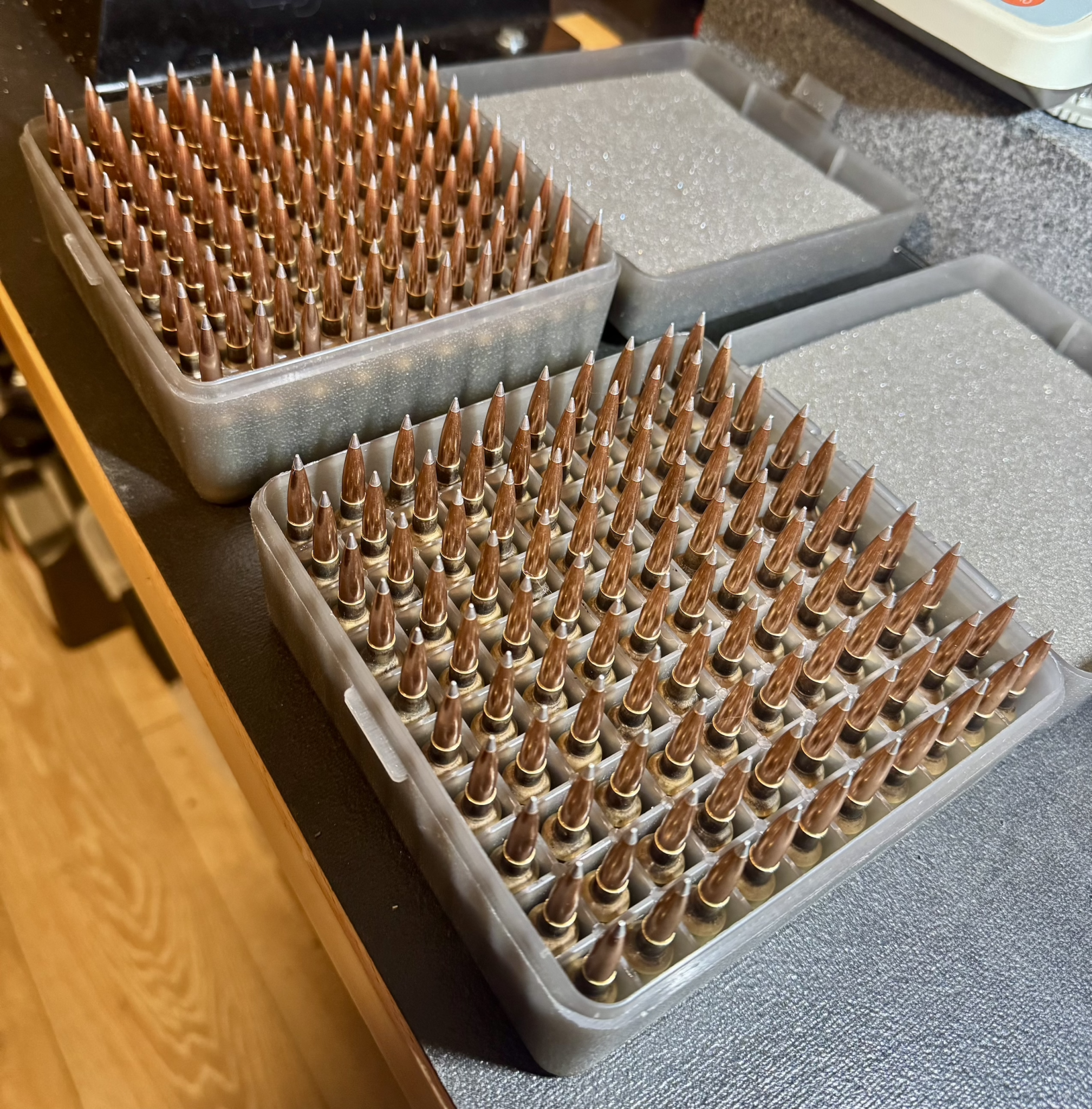

IMHO some of you guys do way too much work for little, to no, gain. Shiny/pretty brass doesn't shoot any better than brass that isn't quite as nice looking (in fact, most of the stuff some guys do to it to make it pretty, actually only makes it shoot worse).
Unless my brass lands in mud at a rainy match or something, fired brass goes straight into the AMP.
My steps are (starting with a fire case):
- anneal
- spray lube (IPA/lanolin 10:1 mix, 4-5 sprays into a 1-gallon ziplock freezer bag per 100 cases, worked around for a minute or 2 and then bag opened up for the alcohol to flash off for ~10 mins)
- FL size and deprime w/ decapping stem (no expander ball)
- dry tumble (in 20-40 grit corn cob blasting media, pours out of flash holes like water when finished, so you don't have to beat the shit out of the cases using a media separator)
- mandrel (the leftover dust from tumbling is lube for the necks)
- inside neck chamfer only (VLD chamfer head, I just kiss them enough to smooth things out for seating bullets and remove any potential peening damage from the mandrel)
- prime
- powder (to the nearest kernel)
- lube inside of necks (IPA/lanolin mix on a couple of wetted q-tips, quick swirl inside each case's neck, takes ~1-2 minutes per 100)
- seat bullets
...and FWIW, as far as trimming, I only trim my brass once per season/barrel. Once multiple firing cycles pile up, I check the fired brass in the chamber with a borescope, and if it has to be trimmed, I take it back to SAAMI minimum (and then don't think about it again for maybe another ~10 more firings/cycles).
