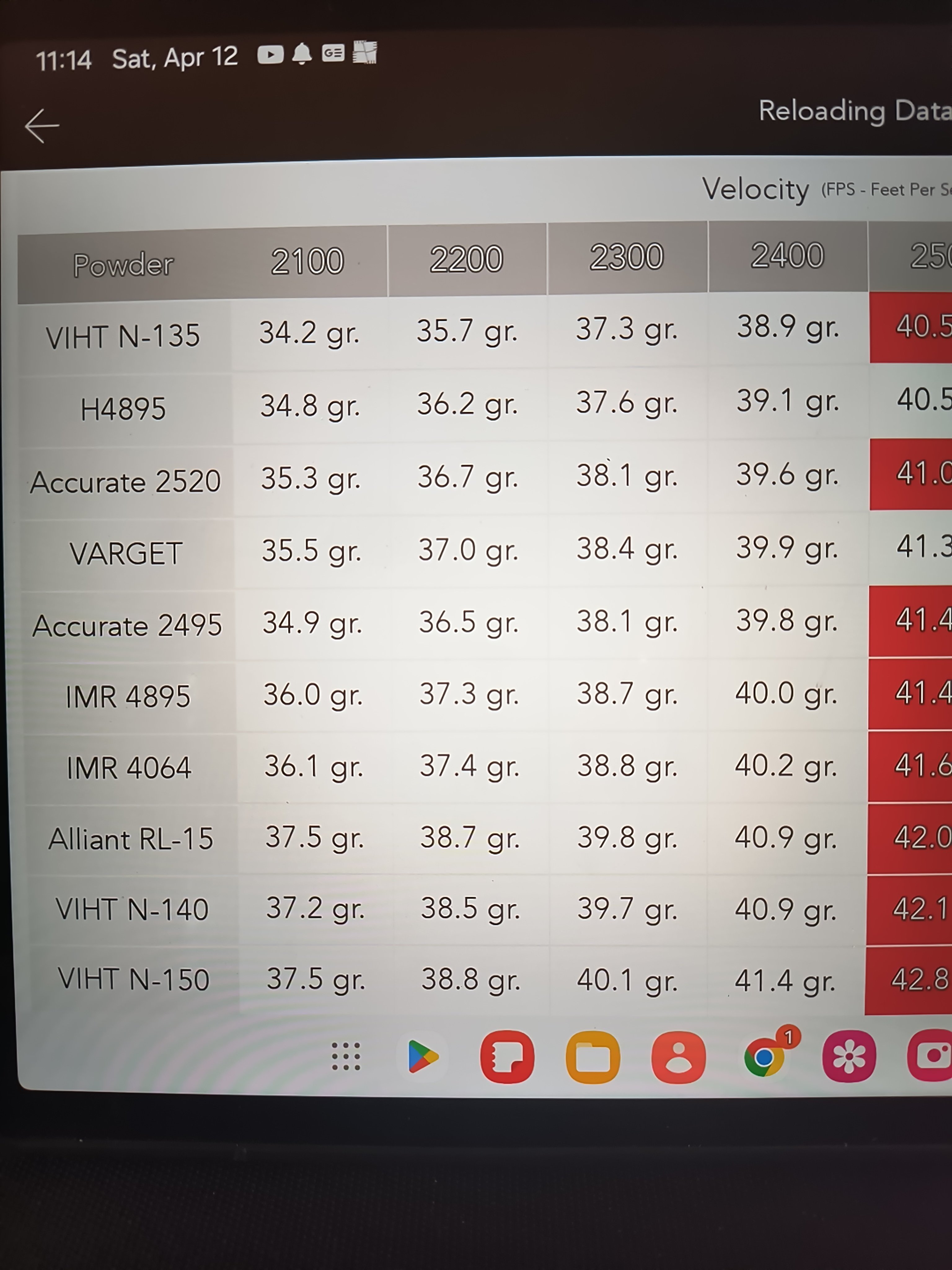

2200 would be extremely slow for that combo
That's what Hornady lists it at, has me confused.
But I shoot it and it groups well.

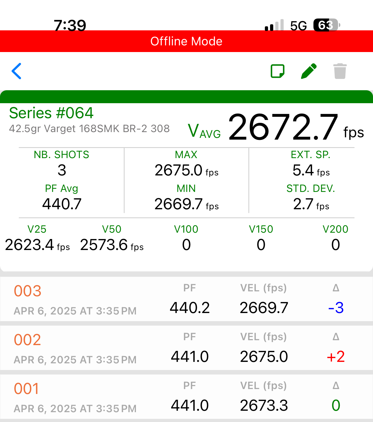

Tikka T3x ctr in 308 win 168 smk
Varget powder 37.5 gr hornady chart says 2200fps
My speed 2670
What's up?
What length barrel are you using? Is the Hornady data base on a 24" barrel?
That low speed on Hornady chart looks to me like it's based on a 20" barrel??? And that'd be inline with my Varget data. Out of my 26" barrel I'd get ~2,393 using 37.5 grs, but typically, when I run Varget, I'm using 42.2 grs that'll give me 2,642 fps. It appears that your 37.5 grs is only filling your case to ~ 86% case capacity. Case fill that low just might be part of the reason for some higher velocity and might results in high ES's due to inconsistent ignition??? For sure, something isn't adding up??? 🤷‍♂️
20 inch 1/11 twist
Used win service rifle info, closer twist and length
Shoots soft and consistent
Even when allowing someone else to shoot, stays in 3/4moa or less
9 0z trigger takes a few shots to get used to.
Maybe your “Varget” is H4198
On my 3rd different lot all same ish speeds so.....
