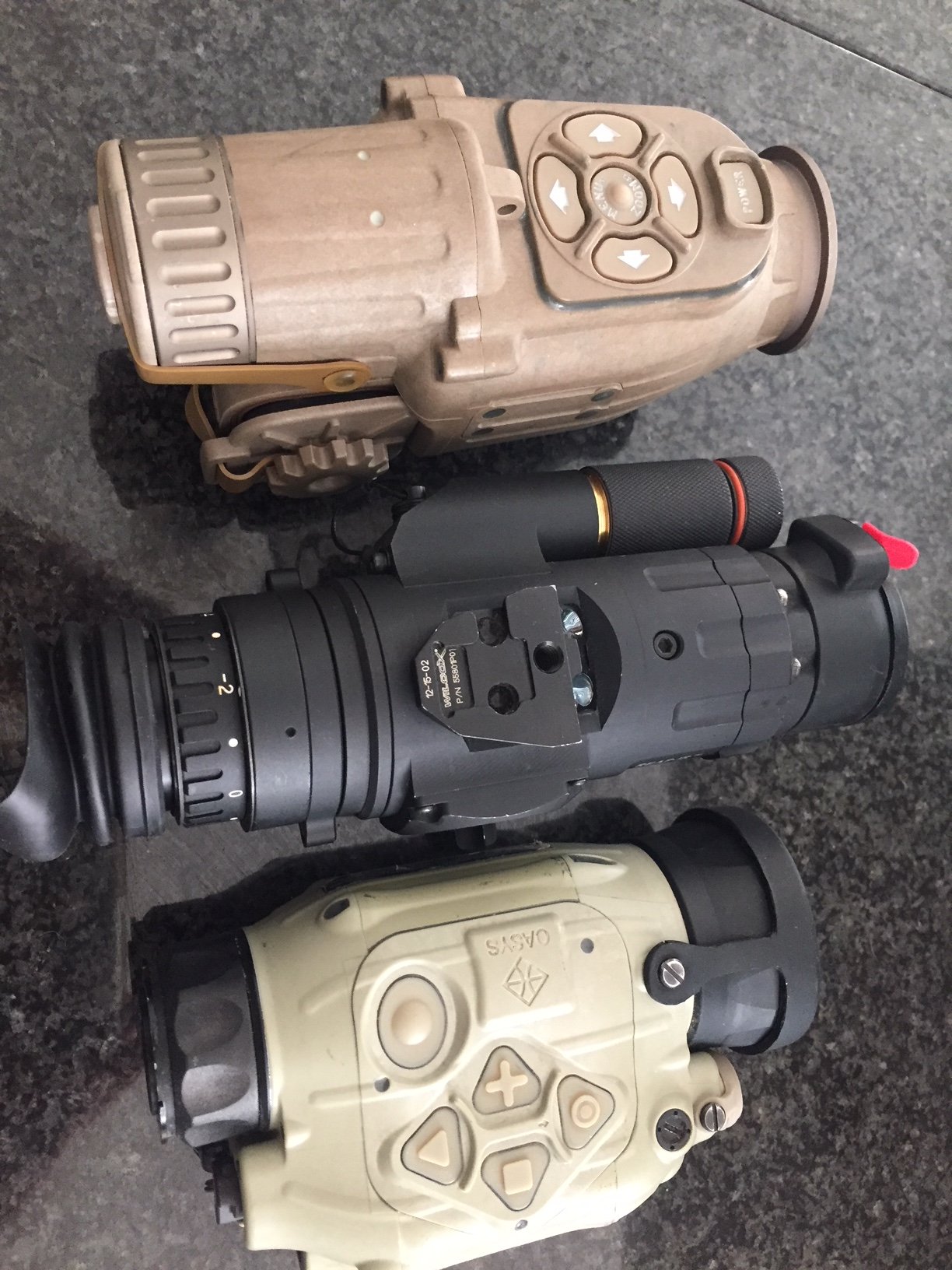

UTCxii mounted on my rifle......
Sold my LWTS.......
This is a pict of my spares.......

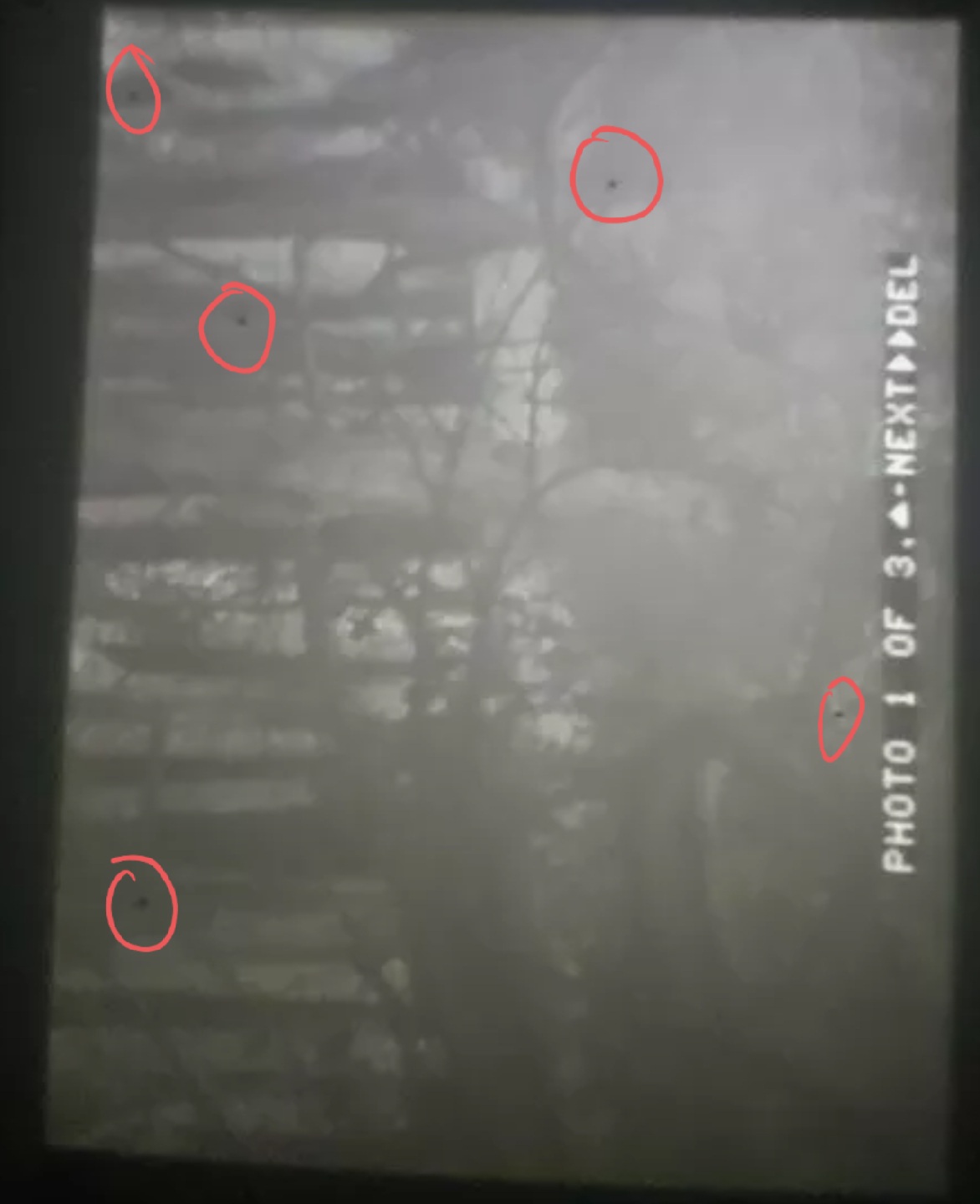

Have a question, looking at a used BAE OASYS UTM looking at pictures it looks like it has some dead pixels. Would you guys purchase a used unit like this or is it something that if it goes bad you're f*cked? Thanks in advance.

View attachment 7428070Have a question, looking at a used BAE OASYS UTM looking at pictures it looks like it has some dead pixels. Would you guys purchase a used unit like this or is it something that if it goes bad you're f*cked? Thanks in advance.
Well, possible / likely radioactivity aside, UTMs are now 7-9 years old. Four stuck/dead pixels ain’t so bad. Some will disappear with a NUC, but assume there’s no fix.

Non-Uniform Correction. Uncooled thermals need to continuously compensate for thermal drift on the FPGA. Most units, including the UTM, need to do that manually. If pixels are just “stuck” and not entirely bad, a NUC will sometimes fix them.
