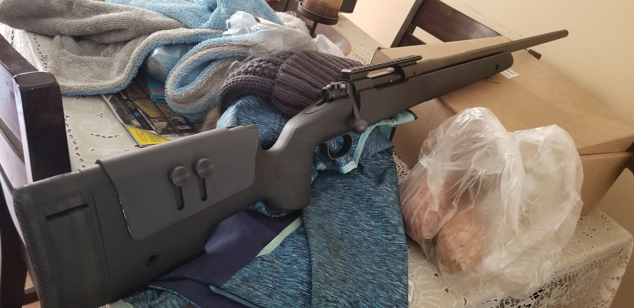

Just installed it on my FN PBR XP A5 Mcmillan. ( 300 WSM ) So far, very impressed!
Especially considering the trigger has no creep to begin with, the M*Carbo spring lightend the trigger pull weight substantially! I'm in the process of trying to find my damn pull gauge lol......once I find it, I'll post the pull weight.
Actually found my trigger pull gauge, and after removing both nuts, and replacing the factory spring with the M*Carbo spring, the trigger pull weight is a CONSISTENT 1.5 pounds. This is prolly the nicest rifle trigger I've ever pulled. She had no creep to begin with.
