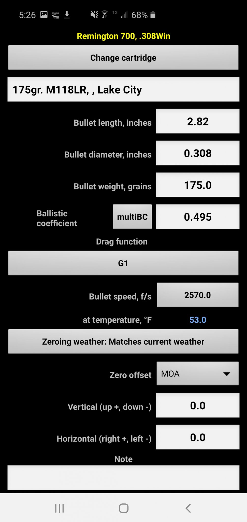

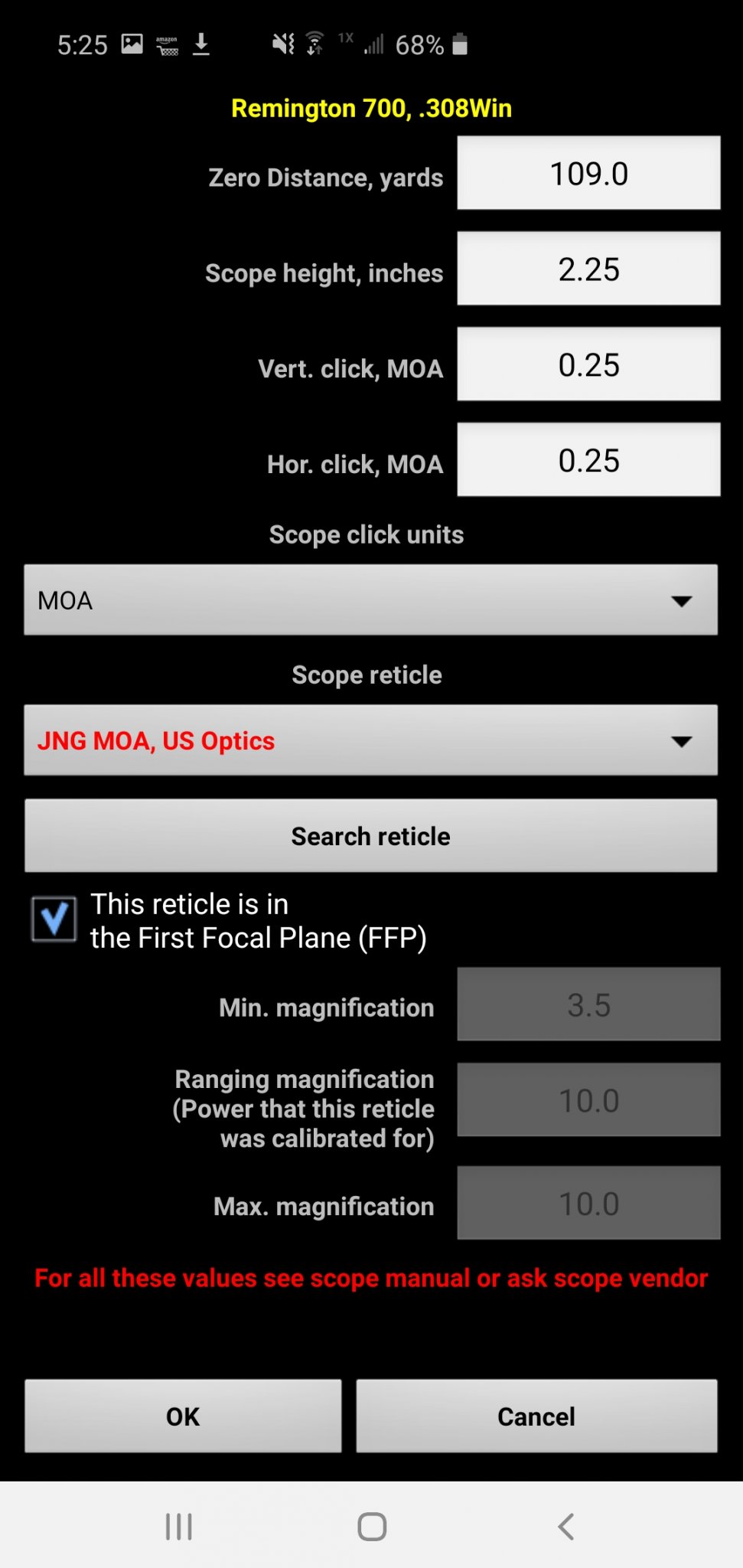

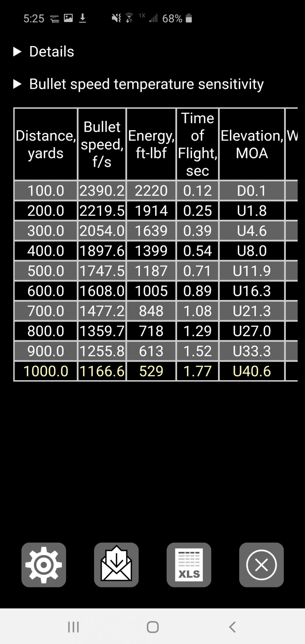

I am trying to figure this out without a chronograph as I do not have one. I purchased 500 rds of M118LR from a hide member here a couple of months ago. I spoke with the member I got the ammunition from and he said my bullet speed on dope card looks slow. Below are the specs on the rifle and some screen shots from Strelok Pro. I pulled the data for the M118LR from the online library. Has any one on here ever shot M118LR from a 17.5" barrel that might have some info to share? Is it possible to figure out without a chronograph? This is by far some of the most accurate ammunition that I have shot.
Remington 700 S/A
17.5" Brux barrel (MTU contour) (1:10 twist with 5R rifling)
McRee Chassis
US Optics ST-10 JNGMOA reticle
TPS steel rings
NF 20moa base
