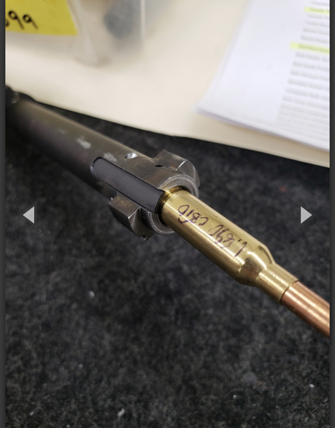

Does anyone know where I can get an M16 style extractor for a Remington 700 .223 and a print for installation? PTG told me their mini one won’t work for it and LRI isn’t showing their mini one available to order. I can do the install myself and would rather not have to send my bolt off.
Also for clarification, I don’t want a sako style extractor. And no, it’s not a matter of needing a new factory extractor or ejector. I’ve gone 3 of each without the problem being solved (one of the ejectors I lengthened to come almost flush with the bolt nose). The only cases that don’t just fall in the receiver are Lapua and even then it’s only 90% of the time they eject at all. It seems that they’re the only ones with a thick enough rim. All others extract just fine but pop loose before they eject and I have to physically remove the spent case by hand.
I realize your asking about extractors and prints but I just had one installed by LRI on a R700 224 Valkyrie bolt gun build (.420 bolt face) but he does them for all other calibers.
Call them. They may be of assistance.
