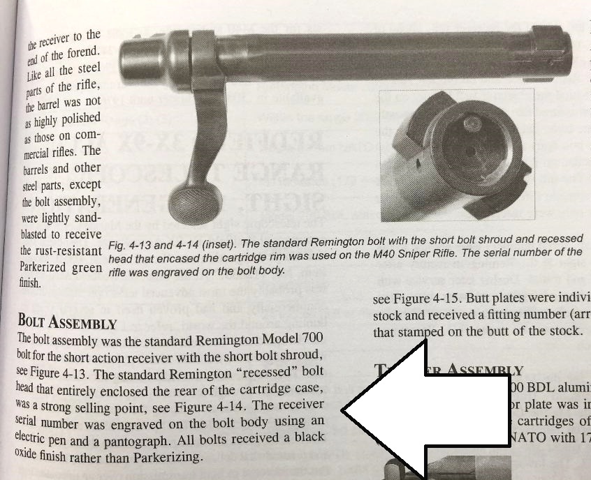

Source: Collecting the American Sniper Rifle: 1945 to 2000, by Joe Poyer, page 66. There are various errors in this book, but that info is correct.
Remington didn't bother polishing the M40 bolts to a high-level, and simply hot blued them, resulting in the 'black oxide' finish.

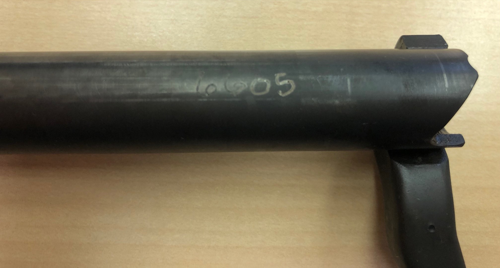

The bolt in the pic is not correct for the Vietnam Era due to a couple things I see.
#1 the pic shows a long bolt shroud and the correct shroud is short.
#2 this shows an anti bind groove on the side of the locking lug which was not done until the 70’s.
Although the finish described may be correct for the era.

The picture of the bolt may not be correct for a 1966 M40, and might represent a correct 1969 M40 bolt. However, as you noted, the info re finish is correct as Joe Poyner used the Remington Archives for that section of his book, which is what I think you were asking. Black oxide finish is correct (Tip: if you have a commercial bolt that was highly polished or jeweled, it will need to be sanded with coarse sandpaper to mimic an M40 bolt).

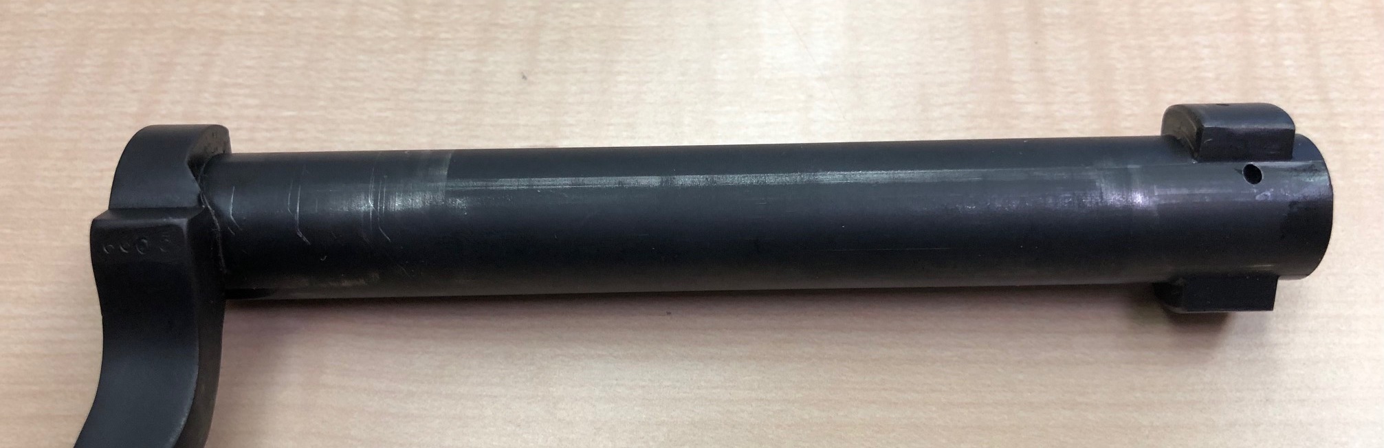

This is not an original M40 bolt, but was refinished at PWS with the black oxide finish, same as what Remington used in the late 1960s.
It is from an early 1990's C-prefix rifle, and stamped as done on M40A1s. I recommend trying to mimic this finish on an M40 clone.
Last 4 of serial number engraved on bottom:

The picture of the bolt may be correct for a 1966 M40, and might represent a correct 1969 M40 bolt. However, as you noted, the info re finish is correct as Joe Poyner used the Remington Archives for that section of his book, which is what I think you were asking. Black oxide finish is correct (Tip: if you have a commercial bolt that was highly polished or jeweled, it will need to be sanded with coarse sandpaper to mimic an M40 bolt).
