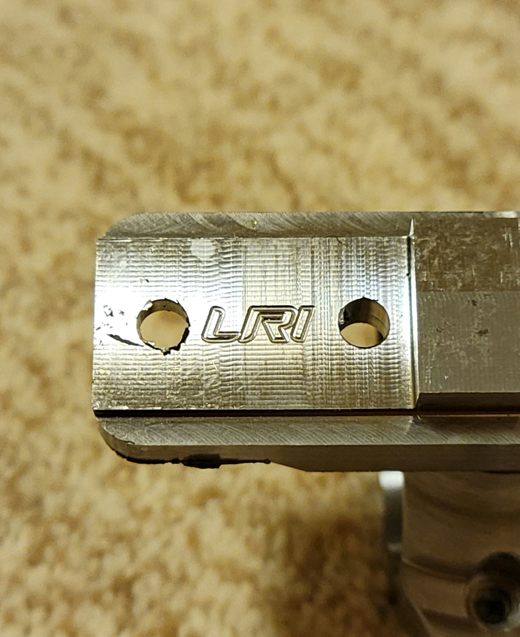

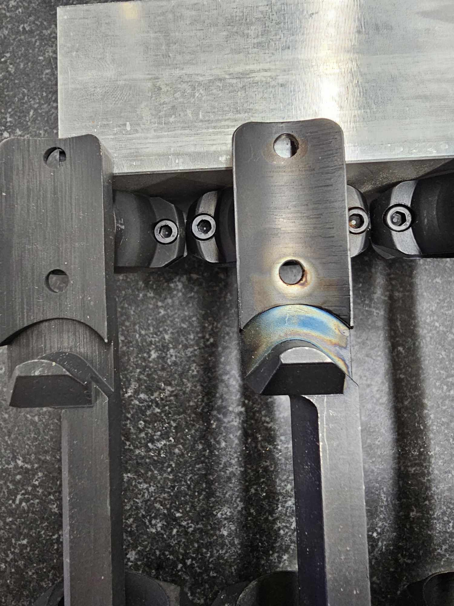

Very strange, maybe it is bluing salts? I have a hard time thinking of the dull black finishes of todays firearms as bluing. I picture the old polished guns of yesteryear with a beautiful blue finish.
Between the rings and scope? Could be powdered rosin. Spu:hr recommend it's use when mounting a scope in their systems.
The only other thing I see is on the front lug, when looking at the bottom, the semicircle doesn't go all the way around and the front of the lug. There is a straight side on the left side of the lug.
Jumping back into this a bit this morning as material for the bases finally arrived last Wednesday.
This stuff was ordered 9.26.2023. -Not sure what that was all about as its just cold finish flat bar stock.
Whatever...

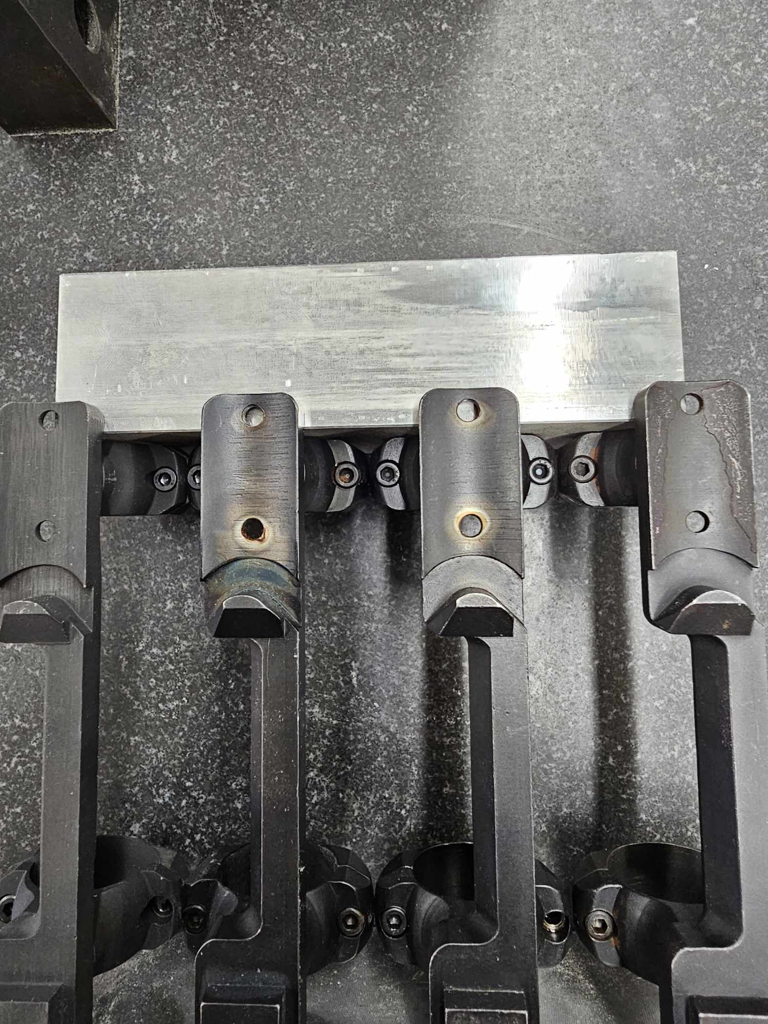

Ok, I've reviewed the notes here and I've chatted with Ryan a bit. I'll try to address this detail by detail.
The photo above. You are indeed correct. My first article on the left is different than the sample on the right. However. I have a gaggle of samples that Ryan provided me. There are differences between them. The middle two are what we'll call "masters" as the 2nd one on the right came out of the box. The one right next to it is a very close 2nd place as it's very clean as well. (doesn't appear to have ever been put on a gun)
The one on the far right is the one I used in the photo that you commented on. I just grabbed it without really paying much attention when I was showing the one I made. It is indeed different. The takeaway from this is that this particular feature was likely given a bit of a leash on the tolerance callout of the print as it has no impact on anything. That, or the parts just evolved based on the lots being run and the people making them. That is just my guess based on making stuff in a shop for the better part of my adult life. Either is very likely. I doubt seriously that Unertl was making these in a 5 axis machining environment back then.
Keep in mind I'm using my cell phone camera to take these. The macro lens option is only so good and I can't stand directly over all the parts simultaneously. I say this because looking at this photo, the two below still appear radically different because of the left side facet. That feature is actually really, really (REALLY!) closely matched. It's just a camera angle thing.

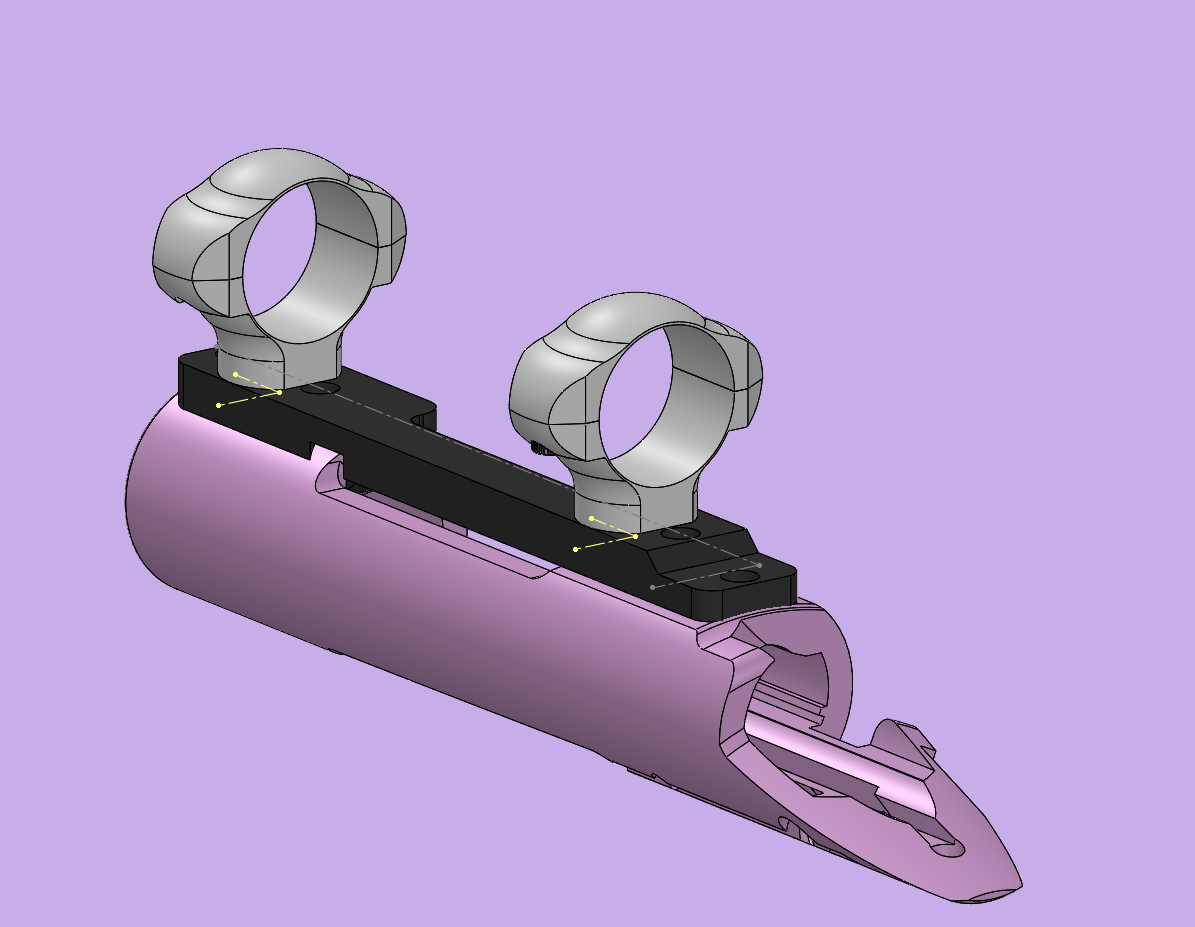

The spacing of the base holes where it attaches to the receiver ring/rear bridge. I had a hole off by .012". This resulted in a cascading effect. That has been updated now. (good eye)
Rings:
As pointed out, there's a couple things to fix. The hole presentation for the screw heads being number one. The center to center hole location between the two ring screws is 1.270". The model shown here is the 6-32 tapped hole. In this view the counterbore for the screw head is not visible.
When you fat finger the numbers, the outside to outside of the counterbore measures 1.500". The rings I made have the hole locations correct. The difference is the outside shape. The originals tuck inward more on the bottom side. I missed it. ($%&@)
Sooo, I'm going to see how feasable it is to rework what I already have done. If that turns into a shitshow, I'll get some new material and make them over again.
Next, the saw used to split these into two halves.
My first article is not right. The saw was too thick (.062"). I knew this going into it. I was just after something to hold in my hand to get a feel for how close/far I was from the original.
I ordered new blades (at the bargain price of almost $400/each) and they are here. The new blades are .028". That should get it. If for some reason that doesn't work, I'll get a thinner blade. They are offered as thin as .002" thick. (nuts as that is thinner than a sheet of notebook paper) I'm hoping to not have to go to that extreme as those blades are more expensive and 100x likely to explode if my shit is wired extremely tight.
That's all I have for now. I'm going to assemble another here and try out the new .028" blades.

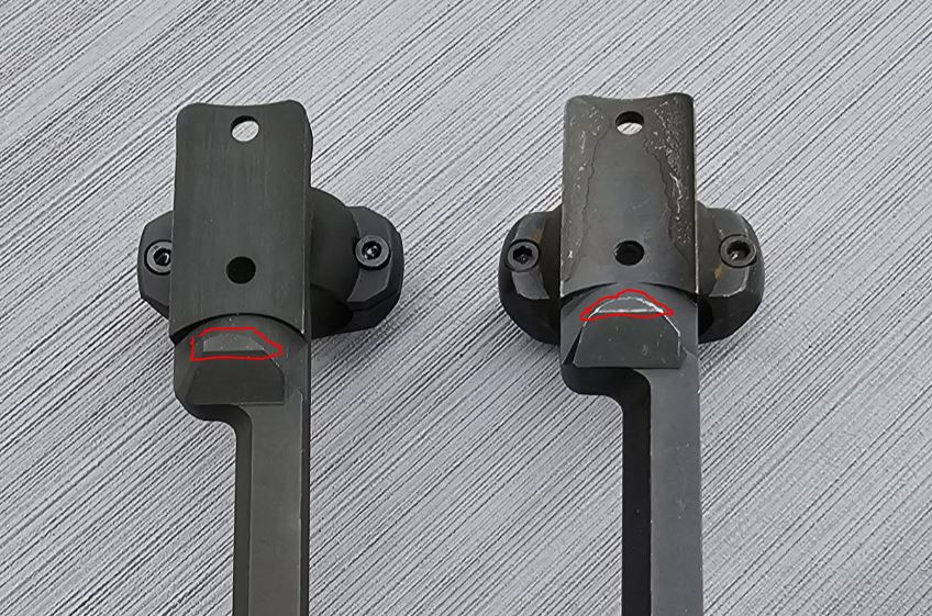

Rings:
Rings:

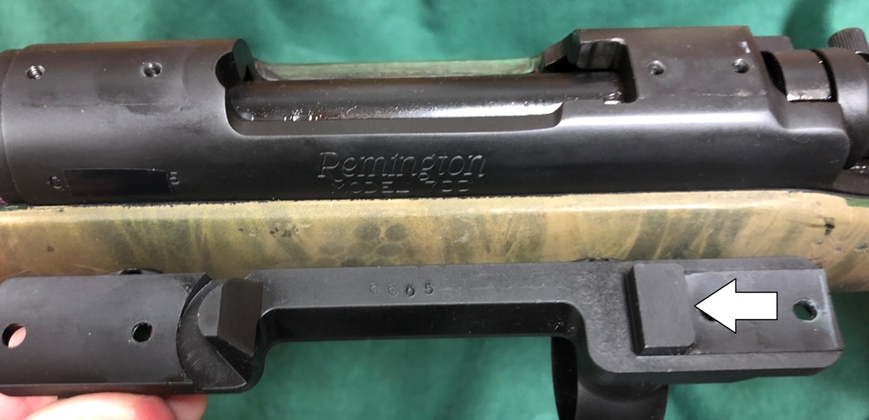

Speaking of "leash on the tolerances" of the scope mount. A local retired USMC MOS 2112 who built the M40A1 sniper rifles in the 1990s told me the Unertl mounts were typically a little long in the area shown by the arrow. He told they almost always had to file a little bit off the back of the rear lug on the scope rail to 'hard fit' it to the action. Why? The lug slot on the M40A1s were cut by hand, and so the length of the lug varied a bit on the receivers.
He said the goal was to make sure the scope rail had no lateral 'play' when it was installed without the mounting screws, and I guess that kind of tight fit would slightly reduce the shear forces acting on the screws that were holding the mount to the receiver. Just an fyi that an old timer told me about this part. I tried to buy his original Unertl scope rail that he had from the 1990s, but he wasn't ready to sell it... So this is a repo scope mount, not an original.

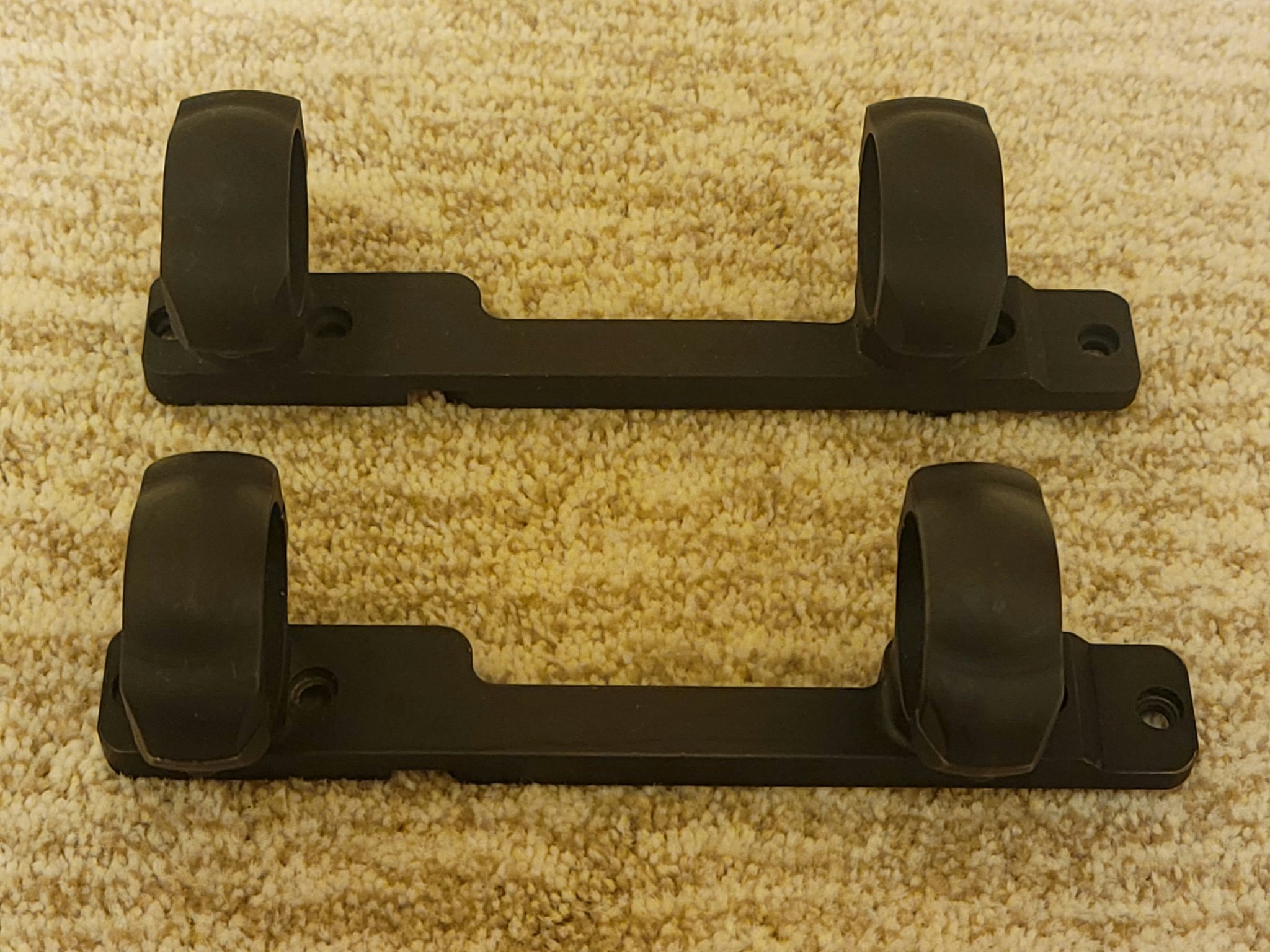

The reproduction prototypes look awesome! Chad is going to give the repros a few minor tweaks to ensure that they're 100% to original A1 mount specs! This project is nearly complete, and the scope mounts will probably be available for purchase soon (and for far less than what an original USMC Unertl mounts currently sells for!). There will be enough for everyone who wants them, so don't think that you might miss out on them. These will be available, so no need to pay stupid mark-ups from scammers/scalpers that will try to flip them.
It might be a good idea to check this thread again towards the end of this month (or possibly the beginning of next month) and see if we make a major update.....
Real and repro mounts:

Hell yeah! You, sir, are absolutely correct! So, that's it, that's the great update! Sorry gents, nothing else to see here in this post. Well, actually, I think that I might have more stuff to tell you guys, but I'm not sure that it's anything important.

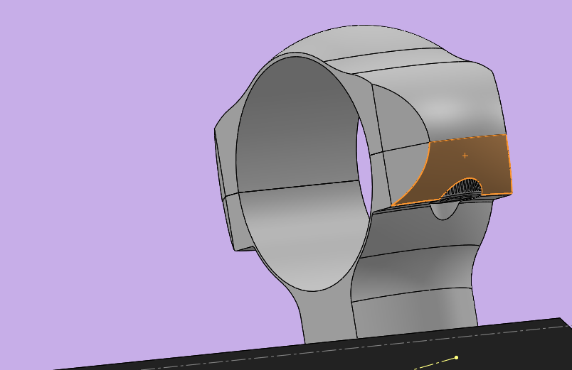

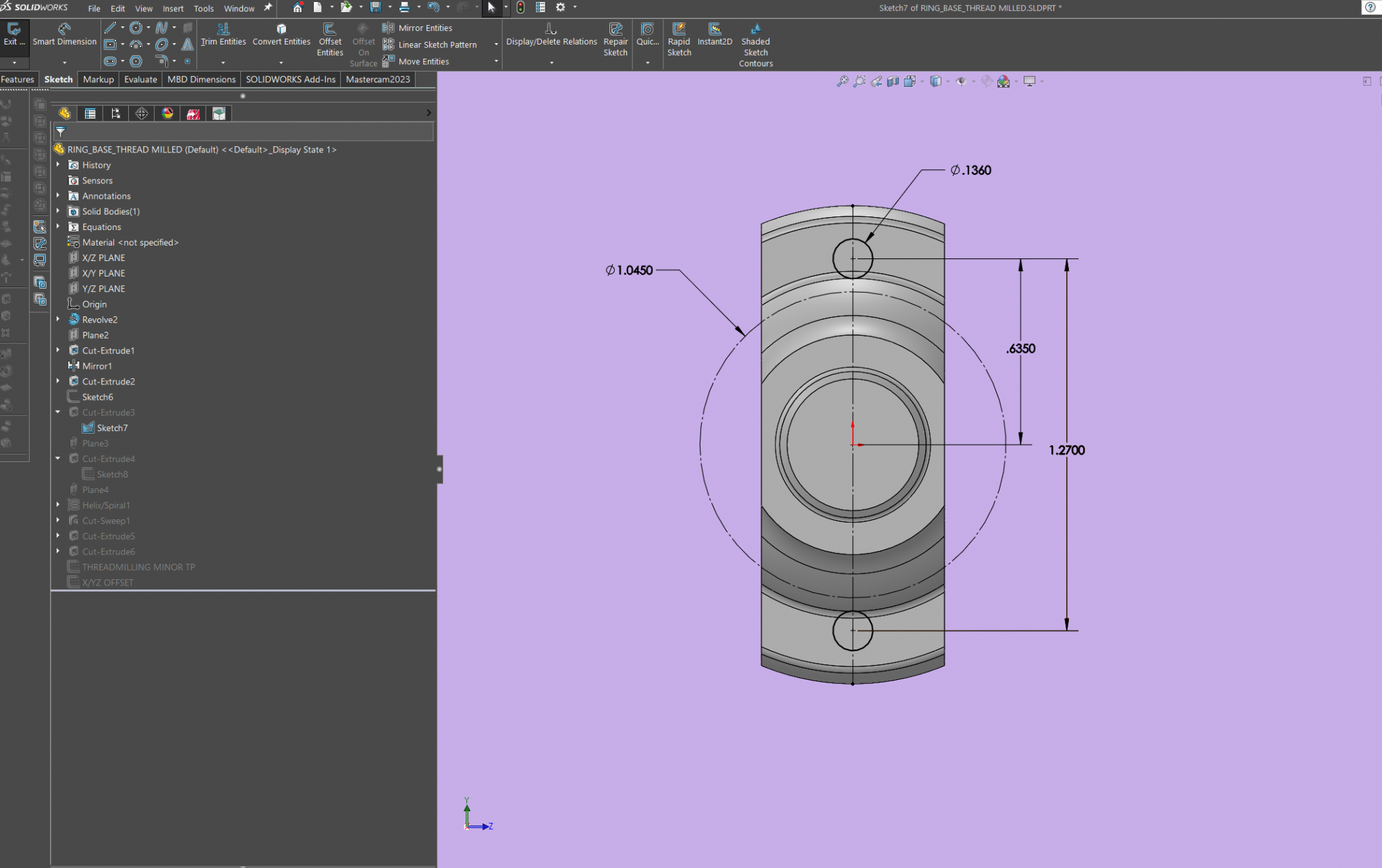

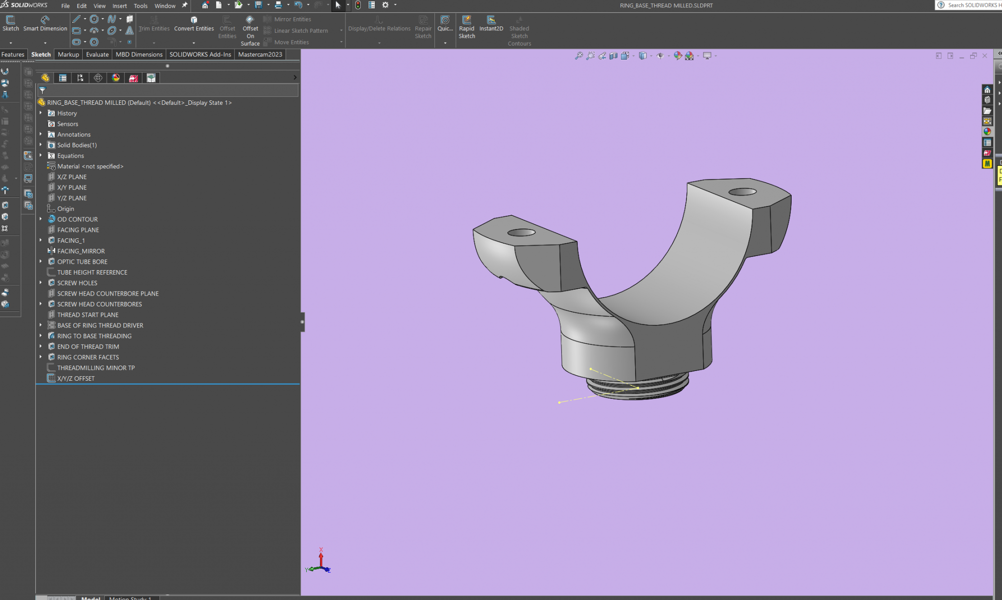

So, we begin again... I had a geometry error on the lower ring where the screw head goes and since this is a pass/fail exercise, well, you get it...
I'll try to be more punctual regarding photos/updates.
Corrected model.

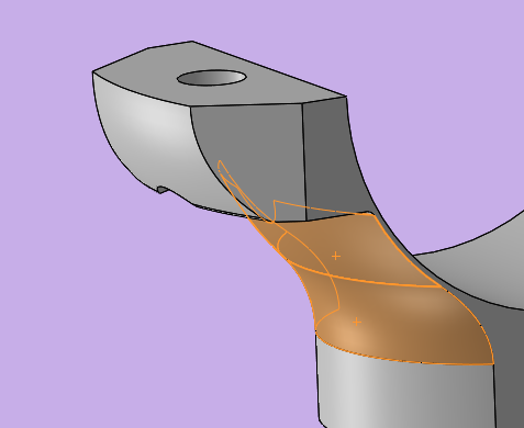

Here's where the goof was. The 2 radius features and tangency was off a bit, causing the screw heads to look radically different than the artifact pieces Ryan provided me.

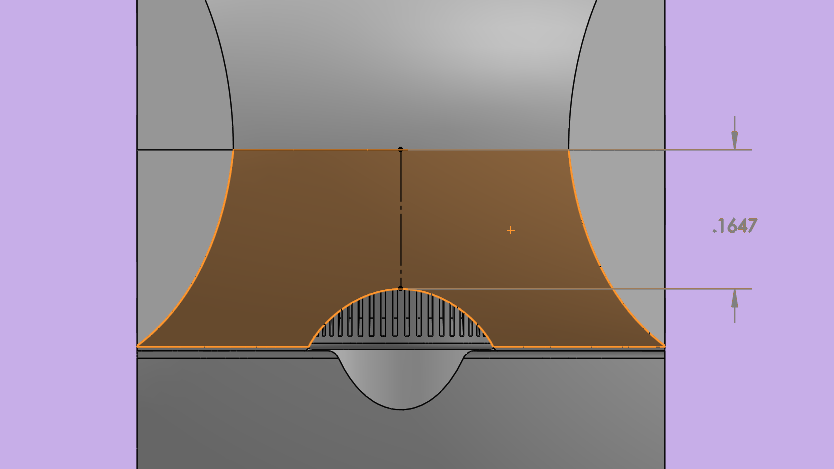

Next, this feature which directly influences how much exposure the screw head has when viewed from the side profile.
The issue is it varies from one set of rings to the next. Checking my artifact samples, the distance ranges from .158" to .173". It's not a dimension/feature that was controlled very well. Probably because it doesn't have to be. The radius doesn't do anything other than drive the outside shape and the only visual cue is how much screw head gets exposed when viewed from the side.
I played with this a bit and landed on .165" as the happy medium. This dimension exposes enough of the screw head so that no one ought to make a fuss over it. Because it's all a guess to get that number, I quit at .1647". Checking this on an optical comparator is tricky as the rings/bases are all attached and it's easy to mistake one ring for another because of how a "shadowgraph" works.
I think we're in a good spot now to run a new batch.
