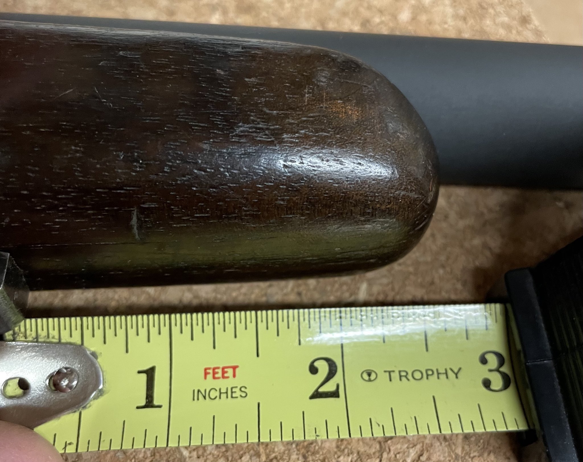

front is 2 1/2" the butt swivel is also 2 1/2 " measured from the lower wood not the butt plate.

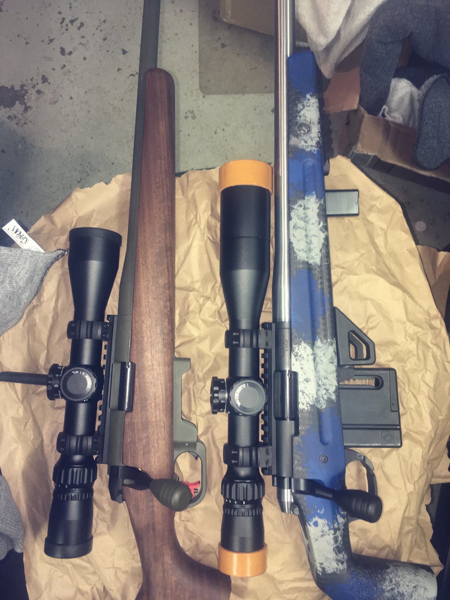

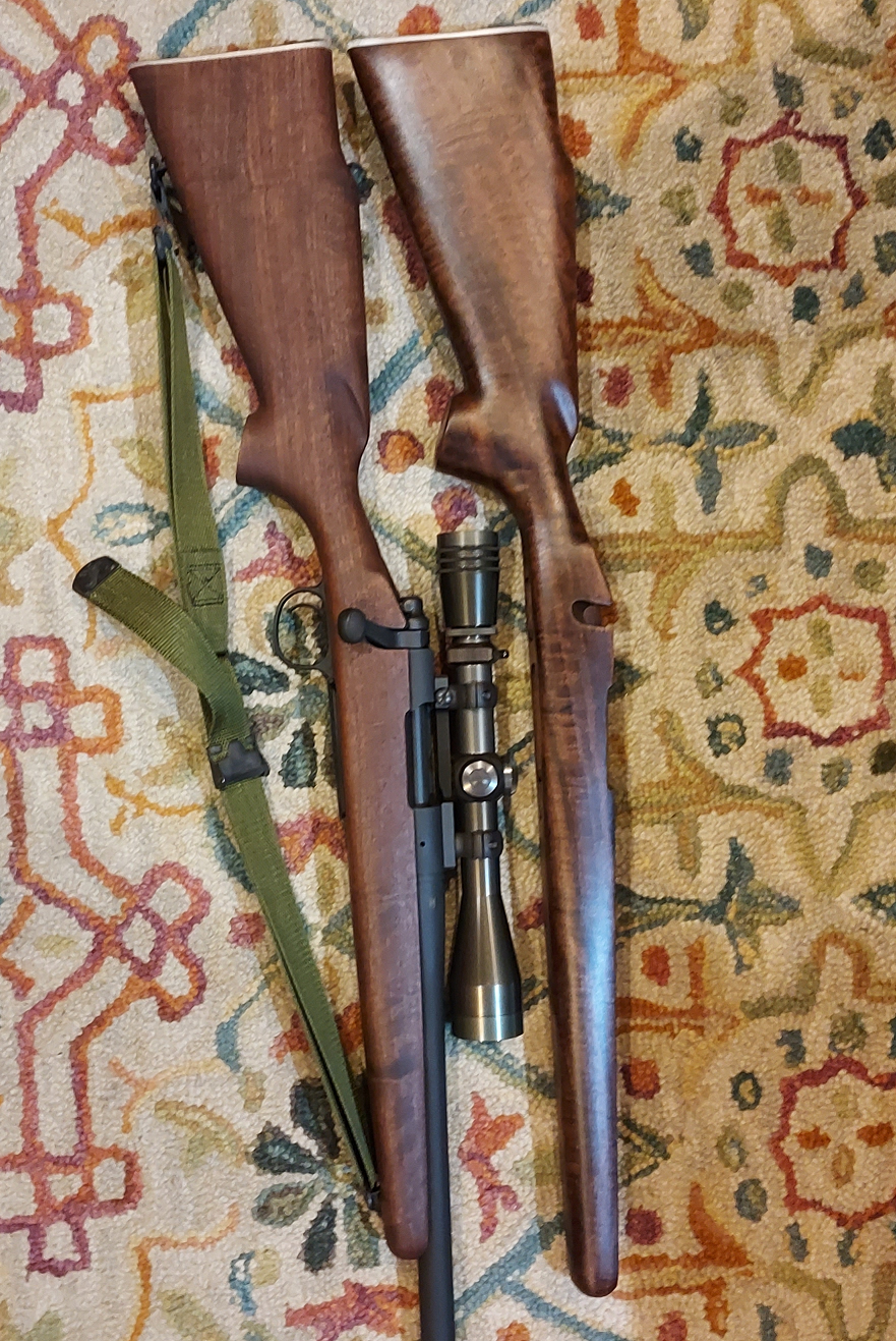

I have a comparison of the Taylor Precision Stock versus a SSA M40 stock. Pretty close in most aspects but the TP stock is about 2 inches longer in the fore end. The total length from the front of the recoil lug is 10 3/4". Any thoughts as to why that might be? I'm pretty sure that both are modeled after the Type 1 styled m40 stocks but wanted to get your opinion. Thanks.
Reactions: deltawiskey
Those are both great looking pieces of wood.
I wonder if OAL was a factor when stocking rifles.
You would think our Eli Whitney based manufacturing would churn out exact duplicates but from looking at the variation in length of some pre64 Winchester stocks there was a lot of variation in length and girth in my small sample of 4 stocks.
I bet even at Remington if they had a good piece of walnut and there was going to be a defect at the very nose of an otherwise suitable piece of walnut they found a way.
Now the differences between Dep Taylor and SSA…..who knows.
I’d like to look at more examples from each and see if there are differences among the same production.
I’m guessing SSA and DepTaylor were a bit more discerning in choosing their raw stock for the limited runs so the variation would be minimal.
But!
SSA may have built off a short original Remington M40 and Dep Taylor may have CNCd off of measurements from a long M40.
Thanks Pmclaine, That would make sense. I have a gunville coming in this week. Will take pictures of the 3 together once received. I will say this Taylor Precision stock is absolutely beautiful...Pics don't do it justice...
I wish Dep Taylor would build more.
For a short bit he was making or going to make wood sticks for Vudoo .22’s. It was a beautiful looking rifle.
Good luck with your Gunville. My hearsay is that it will test your woodworking skills.

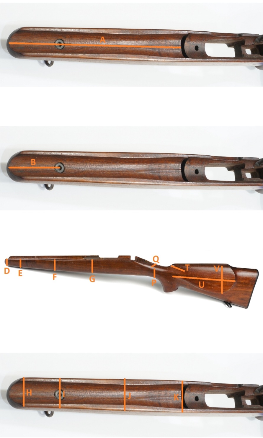

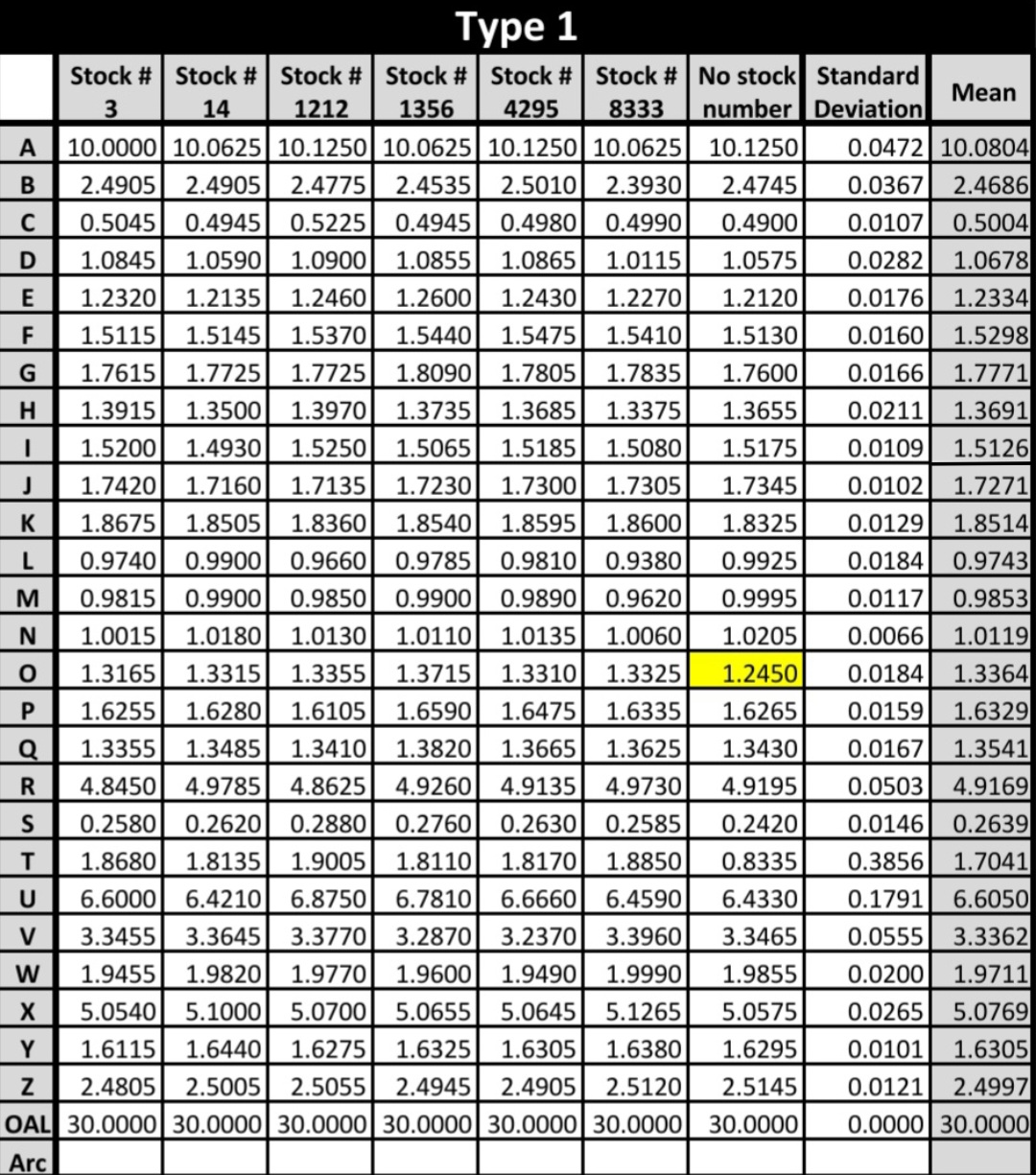

And before any asks me for this information........
Here it is:​
Please keep in mind that this is as accurate and repeatable with each original USMC M40 stock as I could possibly make it. I've done an enormous amount of first-hand research with the entire M40 series of sniper rifles, all of which is has resulted in completely new information for the collector/historian community. M40 stock research like this has never been done before, this is all new information that isn't in any reference book.
If you're finishing a wood stock for your M40 clone build, please use the information I've provided below. Compare my measurements with the measurements from your stock and see how well they match up. The closer that your stock's measurements are to what I have listed in my chart below, the closer your stock will be to the original USMC M40 stocks.
The first two stocks on the chart (#3 and #14) are named after the rack numbers that were painted or stamped onto each of these stocks. The next four stocks on the chart are named after the last 4 digits of the original M40 serial number that was stamped on the bottom of the grip. If anyone needs information about the number stamps used on the bottom of the stock's grip, I can take measurements from the stamped numbers and post that information (clone builders might want to replicate these numbers on their stocks using the last 4 digits of their rifle's receiver serial number). The last stock on the list didn't have any identifying marks, so it's named after it's lack of numbers.
The 7 stocks are all in a row across the top of the chart. The 28 areas of measurement (of which only 27 are used) are all in a column down the chart. The A to Z letters in the chart correspond to the A to Z letters in the list below this paragraph. The list below tells you what measurement each letter represents. Since the list below isn't descriptive and concise enough on it's own, I also included photographs of an original USMC M40 stock with the A to Z measurements drawn onto the stock in the photos. Each line on the stock in the photos has a letter next to it, that letter can be matched up to it's counterpart on the descriptive list. All of this information is probably extremely obvious to you guys, but I still wanted to document everything in case some people had any questions.

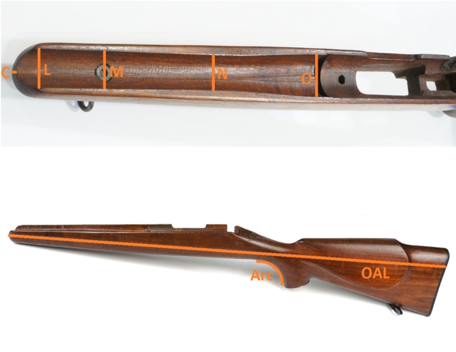

One last note, in the photos below, you'll see 2 photos of the M40 stock's forend. This is not the same photo/information erroneously posted a second time, each of the 2 stock forend photos contains a different set of measurements. So, please look closely at them! Let me know if you guys have any questions about these M40 stock measurements, I'll do my best to answer them.
All measurements below and in the chart are in inches.
A. Length from the front of the recoil lug to the tip of the forend
B. Length from the tip of the forend to the center of the front sling swivel
C. Height of the stock at the tip of the forend (bottom of the stock to bottom of the barrel channel)
D. Height of the stock at the tip of the forend (right before it starts to taper off)
E. Height of the stock at the front sling swivel
F. Height of the stock midway on the forend (4 inches from the front of the recoil lug)
G. Height of the stock at the front of the recoil lug
H. Width of the stock at the tip of the forend (right before it starts to taper off)
I. Width of the stock at the front sling swivel
J. Width of the stock midway on the forend (4 inches from the front of the recoil lug)
K. Width of the stock at the front of the recoil lug
L. Width of the barrel channel at the tip of the forend (right before it starts to taper off)
M. Width of the barrel channel at the front sling swivel
N. Width of the barrel channel midway on the forend (4 inches from the front of the recoil lug)
O. Width of the barrel channel at the front of the recoil lug
P. Height of grip
Q. Width of grip
R. Circumference of the grip
S. Grip protrusion below the stock
T. Length of thumb cut on the cheek piece
U. Length of cheek piece
V. Height of cheek piece
W. Width of cheek piece
X. Height of butt
Y. Width of butt
Z. Length from end of the butt of the center of the rear sling swivel
OAL – Stock overall length (without buttplate)
Arc – The arc of the grip (I never got around to measuring this area of the stock, so there isn't any arc information recorded on the chart)
All the information in the chart below is measurement in inches:
Yellow highlight = bedding material throws off the measurements
Yes, I still have all the information I ever posted on the M40 Forum, nothing of mine is lost.......

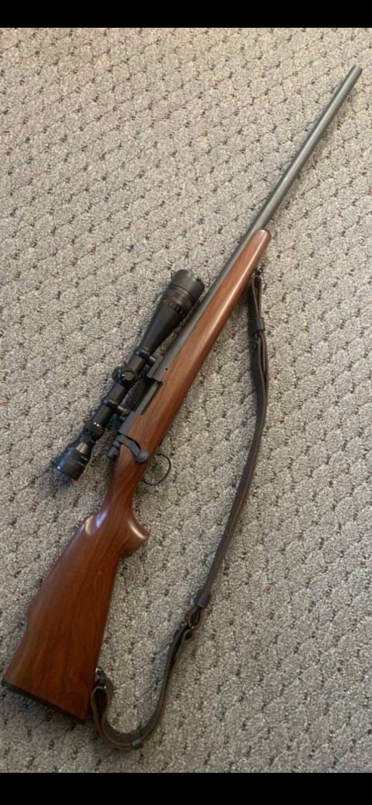

How’s this one ? OEM Remington Stock
Detailed measurements on a reproduction M40 stock can be exactly the same as an original USMC M40 stock, but the brass pin that's visible on the right side of the stock in your photo will always be a dead giveaway that it's not a USMC M40 stock. This is not any type of criticism towards you or your rifle, I'm just using your photo as an example of a clone with a brass pin visible on the right side of the stock.
It's a small detail that everyone needs to remember when making a reproduction USMC M40 stock. On original USMC M40 stocks, the brass pin is only visible on the left side of the stock. On Remington built wood stock rifles (other than the M40), the brass pin will usually be seen on both sides of the OEM Remington stock. Technically, it's a long, thin screw, but I've always called it a pin.
P. Height of grip
Q. Width of grip
X. Height of butt
Y. Width of butt

Thanks USMCSGT0331, Awesome info as always. I'm really interested in what your measurement "A" was, on average, for the real M40 stocks. Just based on your picture it appears that the SSA stocks are closer to your original than the TP stock. In all other ways the TP stock is fairly close to the SSA. Having said that, I don't plan on taking any wood off of the TP stock to match. If you are able to post the info you have I can take the action out of the SSA rifle to compare measurements if anybody wants them. Be good info to have for the SSA guys out there.
I really appreciate all of the input from you guys. I was fairly active on M40rifle.com years ago "Capthook73". Been out of the game for a minute but the bug has bitten me again. I absolutely love these rifles and this is the only reason I'm on the hide...
Thanks again.
Thanks USMCSGT0331, Awesome info as always. I'm really interested in what your measurement "A" was, on average, for the real M40 stocks. If you are able to post the info you have I can take the action out of the SSA rifle to compare measurements if anybody wants them.
It sounds like you're not able to see the chart I posted at the end of my post. That chart has all the information you're looking for, and even has the average of "A" for all 7 original USMC M40 stocks (it's 10.0804"). The very last column has the mean/average for each row, it's the average for all 7 original M40 stocks for each letter measurement. I also did the same thing with the standard deviation so that everyone can see how incredibly uniform Remington kept their production for these stocks. Please let me know if the images aren't showing up in my post and I'll fix it.
Lol...I see it now. Not sure why it wasn't showing up before. Thanks. Your attention to detail boggles the mind...Are you taking deposits for your book???

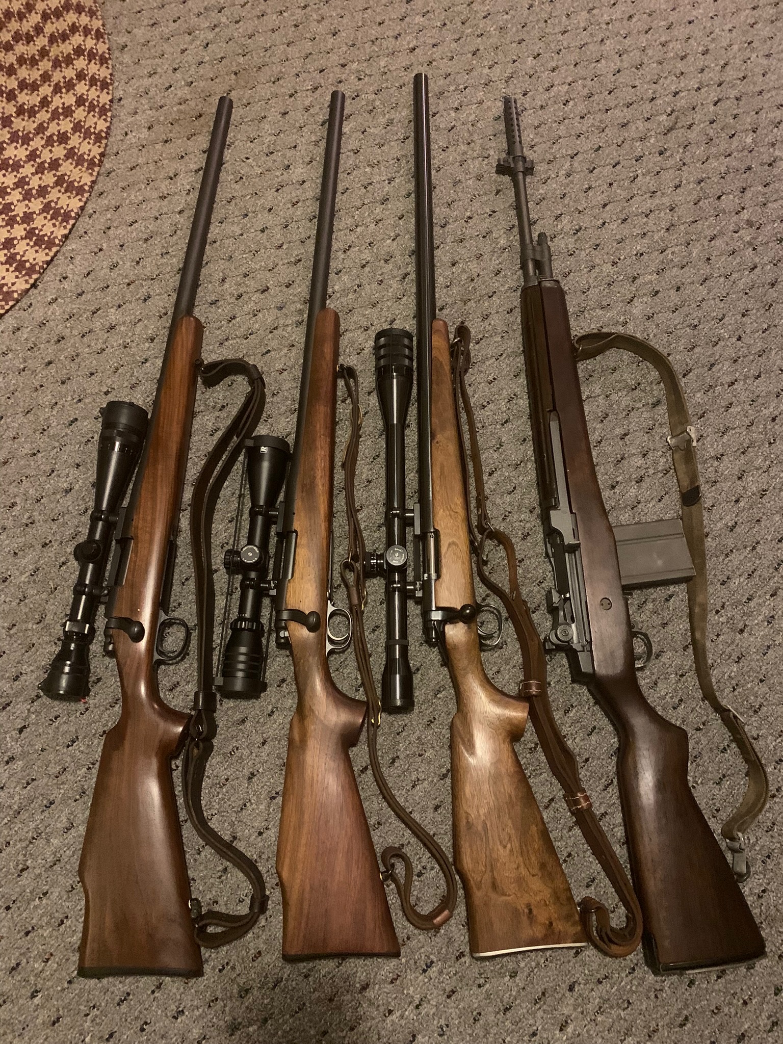

This are all OEM Remington stocks . I have been involved with the clone thing for many many years with the Harley’s and 32 Fords . Unless it is the real produced as from the produced it is always a clone . There many me no way to reproduce anything that is 100 % real . A clone is a clone . There are 3 OEM Remington stocks in my collection , none of the three are exactly the same , but none are clone reproduction stocks .
Reactions: Frank Green
