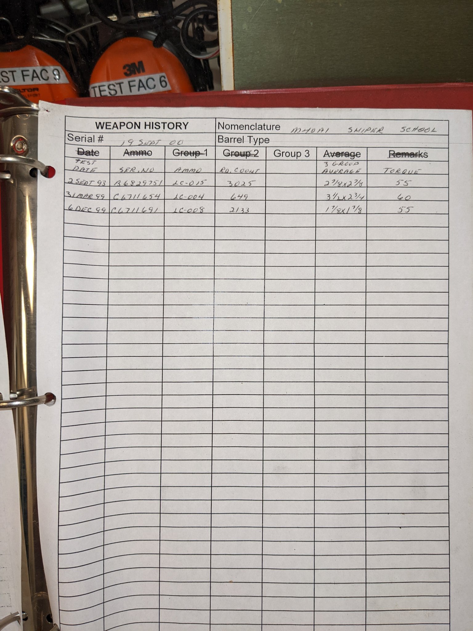

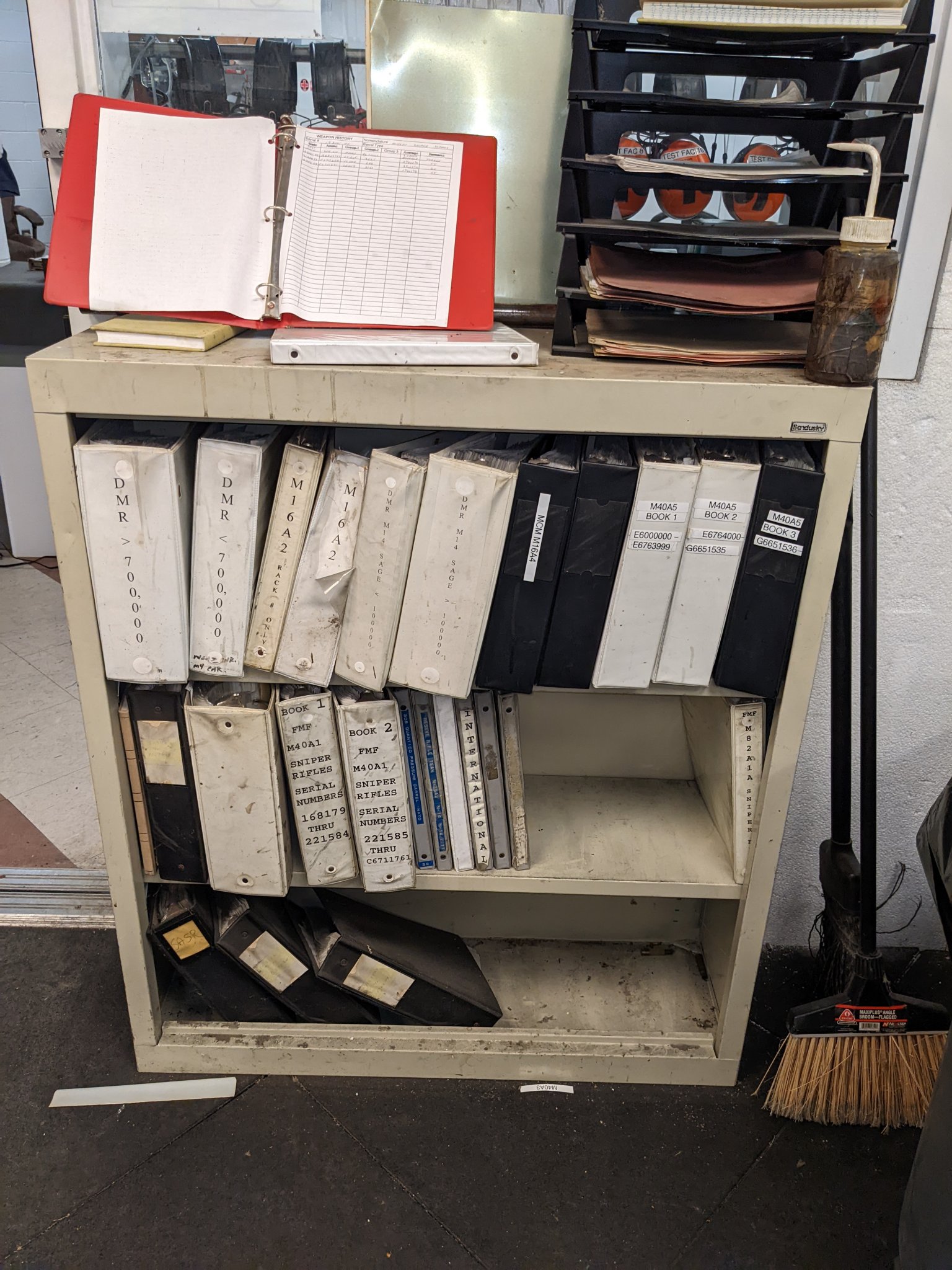

I do in fact still have all the 3 ring binders and I know who you are referring to, because I have only ever let one person that doesn't work here go through my books. I will not mention his name either. As you can see, I do not need to go to some archive because these records have never been archived. I have been working in the test facility since 2001 and these binders and log books have never been out of the test shed with the exception of 2006-7 when they were building the new facility. At which time all the records were locked up in PWS. I went thru the binders this morning and came across this mystery serial number that was indeed test fired on 2 Sept 1993 and on this history sheet it is an A1.
As for 12's having carte blanche to make a "hobby lobby" gun and call it whatever he wanted is probably more along the lines as to what you said. Again you are more than welcome to come out and go through the log book and the 3 ring binders. Plan for 2 days minimum.

Thank you for the information, it's interesting to see that it's marked as an A1. It's in line with what the other documents show for the nomenclature, each USMC entity referred to the upgraded A1 in a different manner. Is there anyway you can pull more information on that serial number? Why did that rifle have it's own binder as an M40A2? And why was SYSCOM referring to the upgraded A1 as the A2?

Best guess on the SYSCOM paperwork was that was probably done by a tech writer that doesn't know squat about guns. I actually found that history paperwork in the school houses paperwork, not an A2 binder. I have yet to find that unicorn. I have hunted that serial number for a day and a half now and that's the only B serial number I have found so far. I'm going to dig into some rifle team binders next. We have always done experimental stuff for them, maybe find it there.

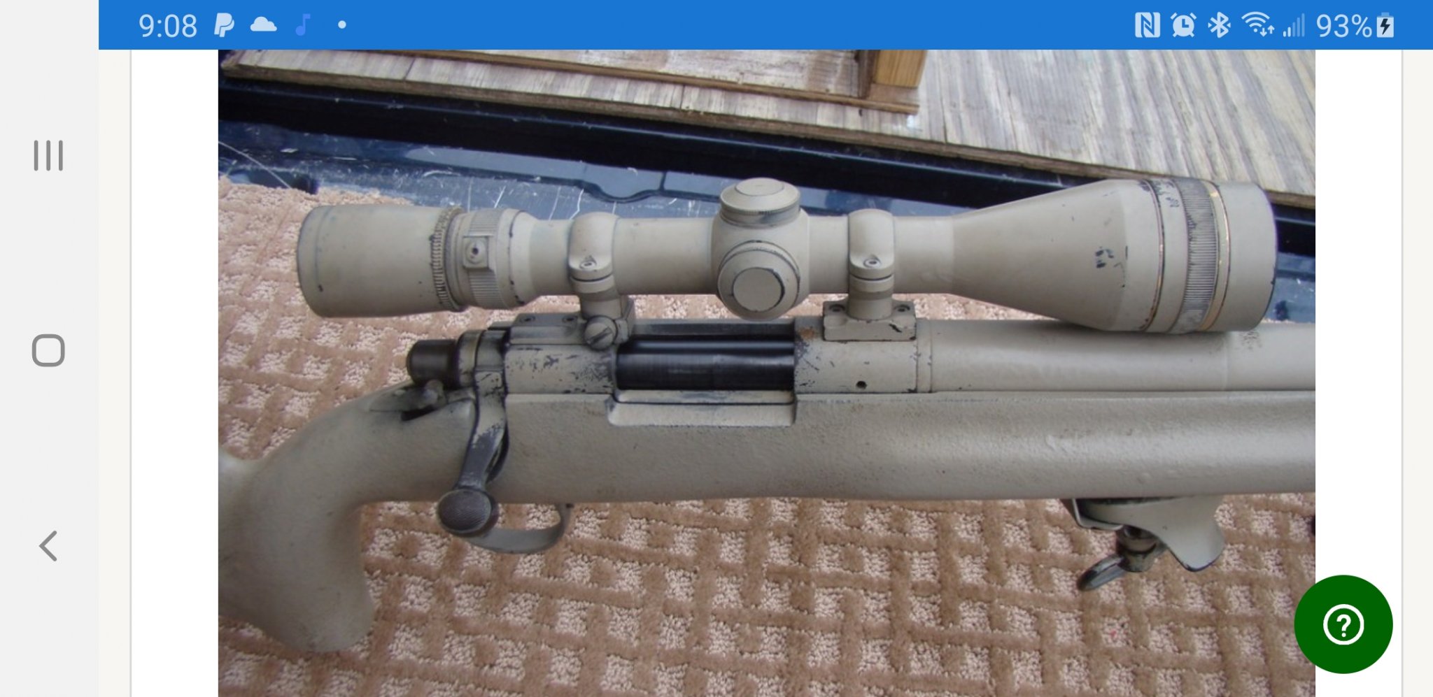

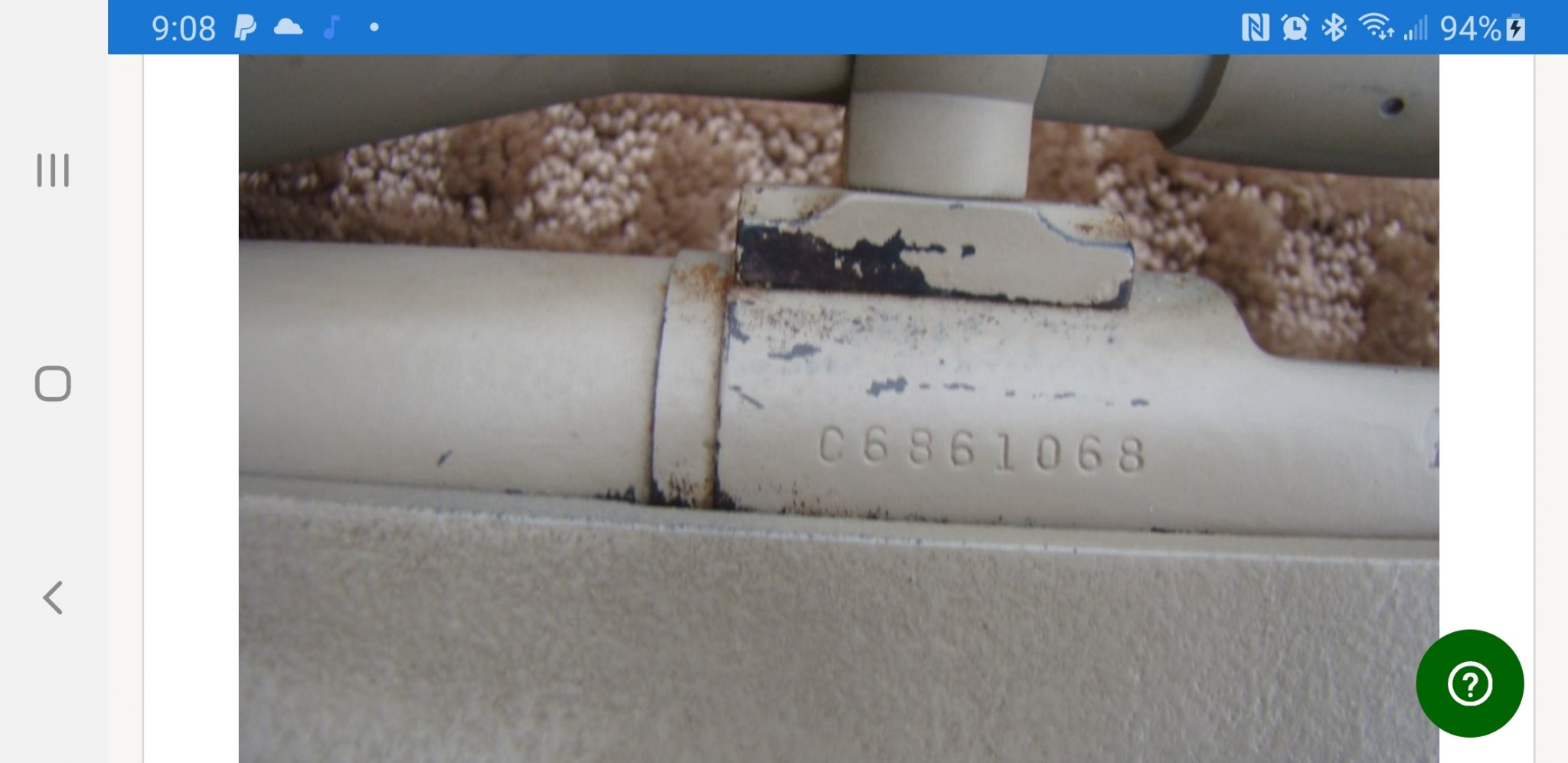

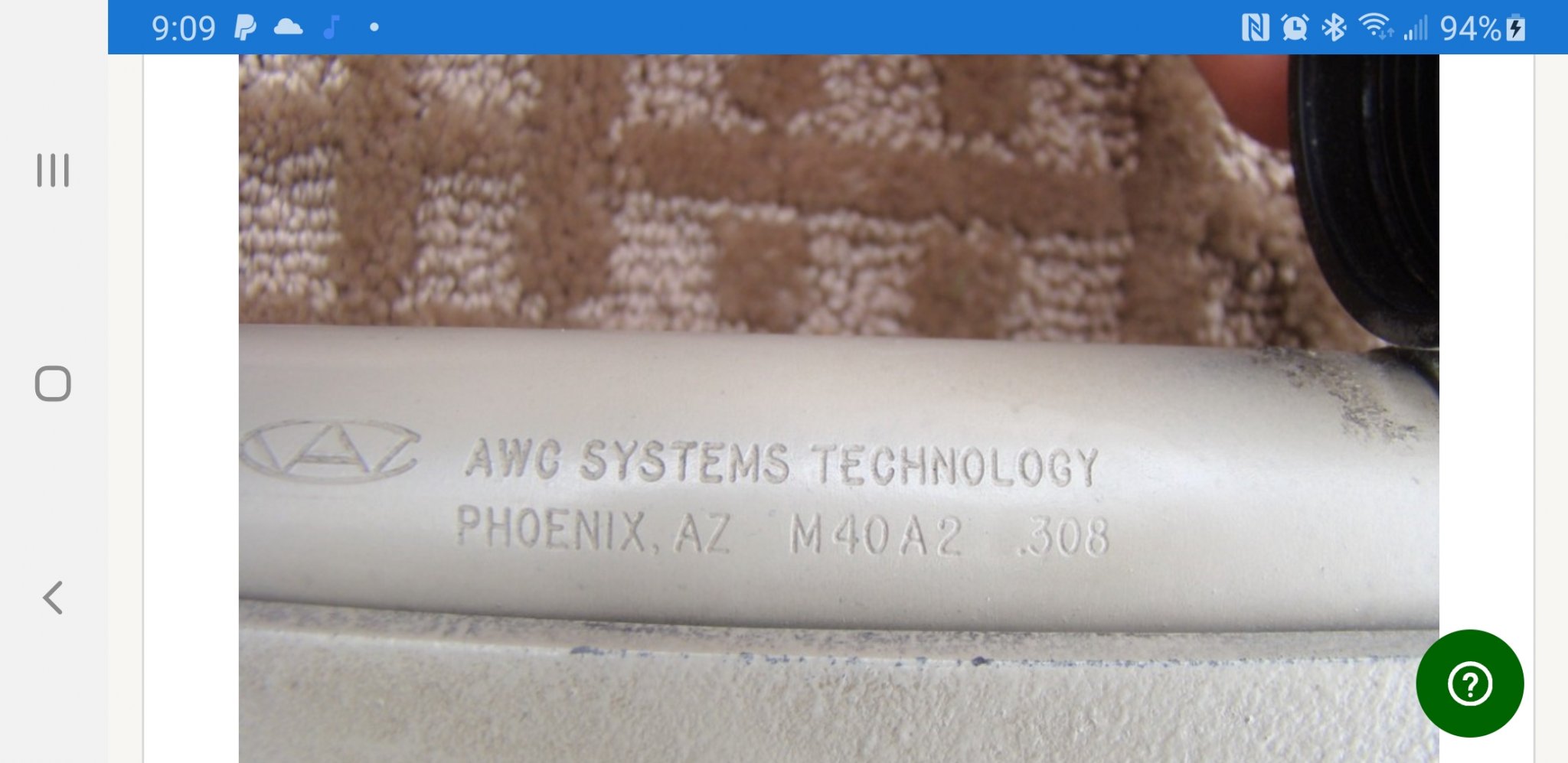

So I got the book "The Complete Book of US Sniping" by Peter Senich and in the section about the M40A1, it shows a picture of a rifle and calls it the M40A2. Now I've never heard of this, I always assumed it went from A1 to A3 (although didn't know why). So what was different about the M40A2 compared to an A1? I see that it has a bipod attached and what appears to be a Leupold Optic instead of the Unterl.
