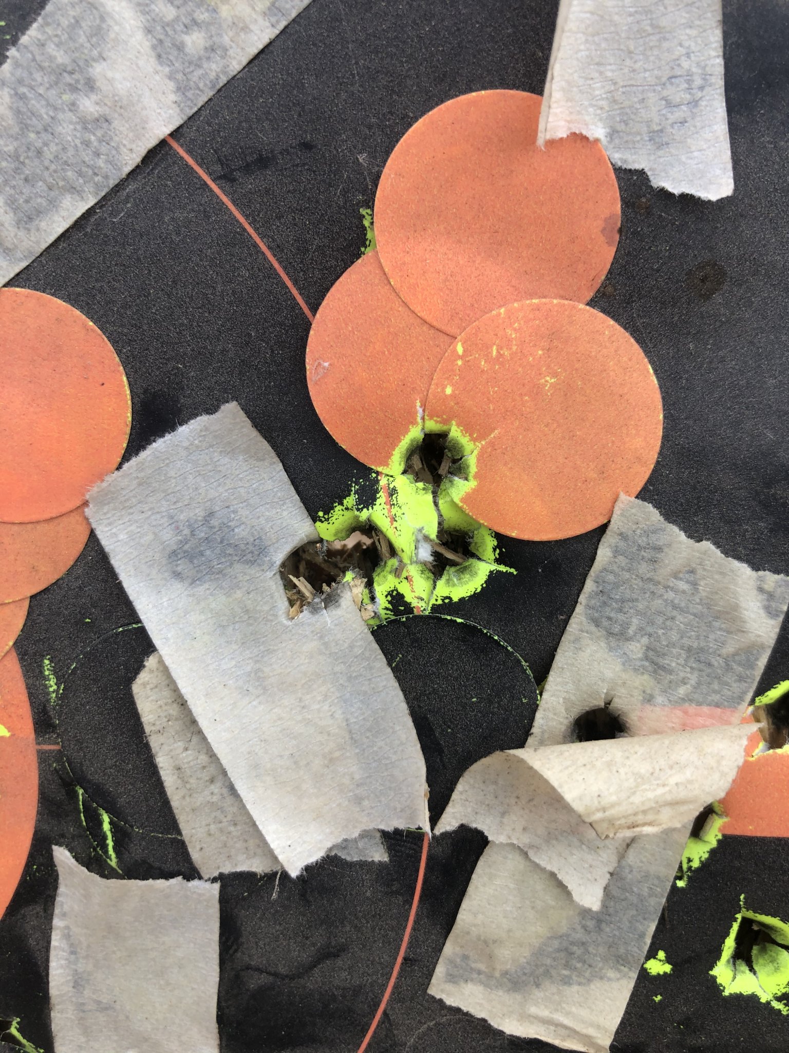

FYI, I put a proof barrel in a m5e1 and did not lap it. This is the one and only 100 yard group I shot with it after I installed it. I wouldn’t worry about it if I were you.
