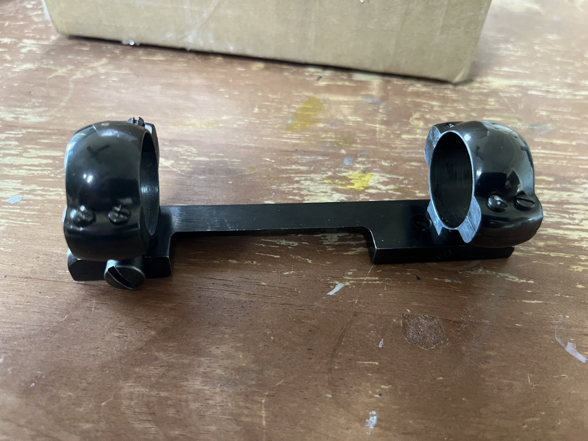

A Redfield like this is appropriate I believe.

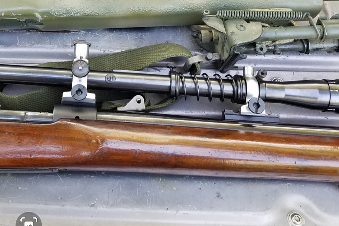

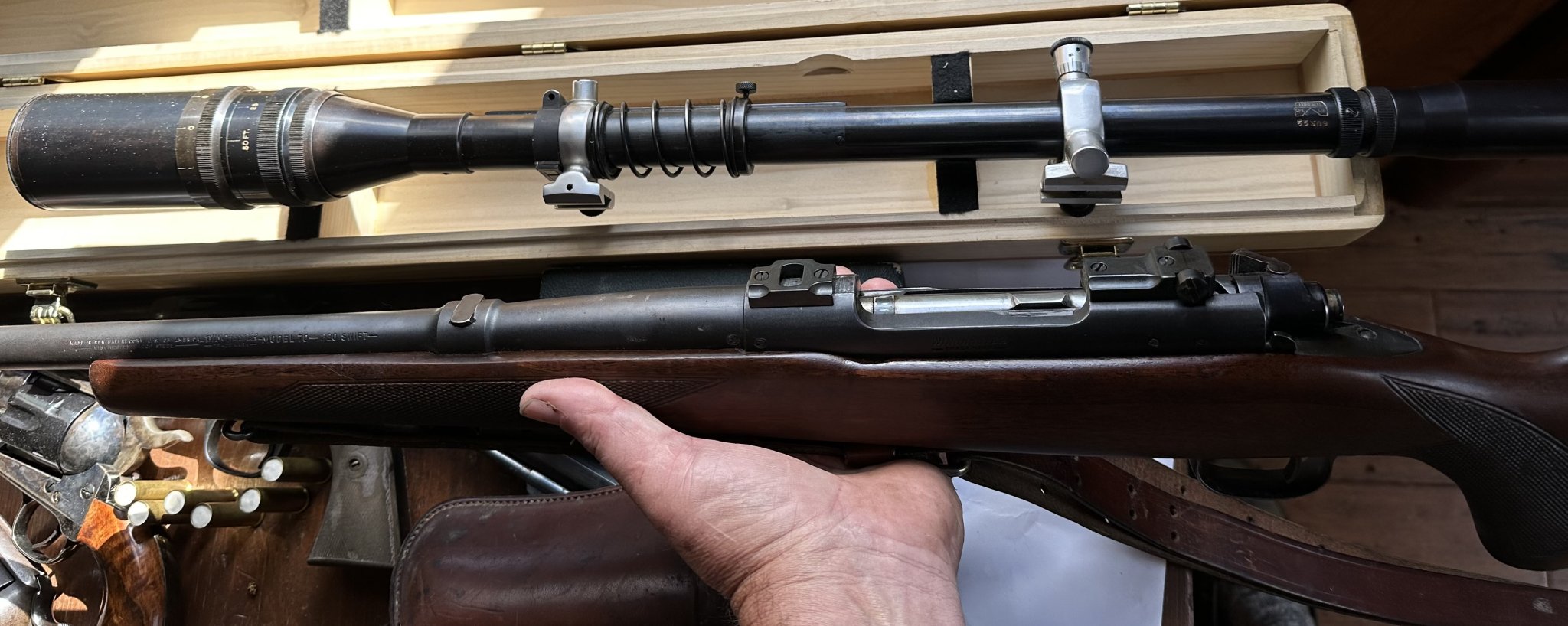

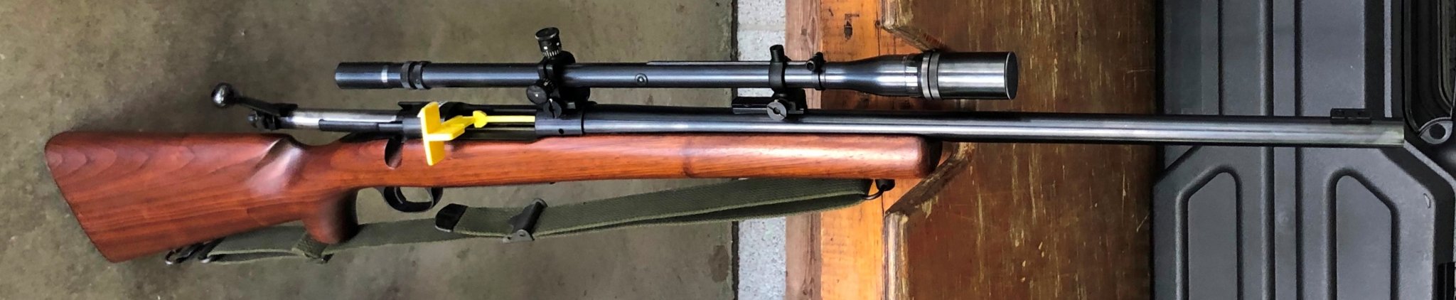

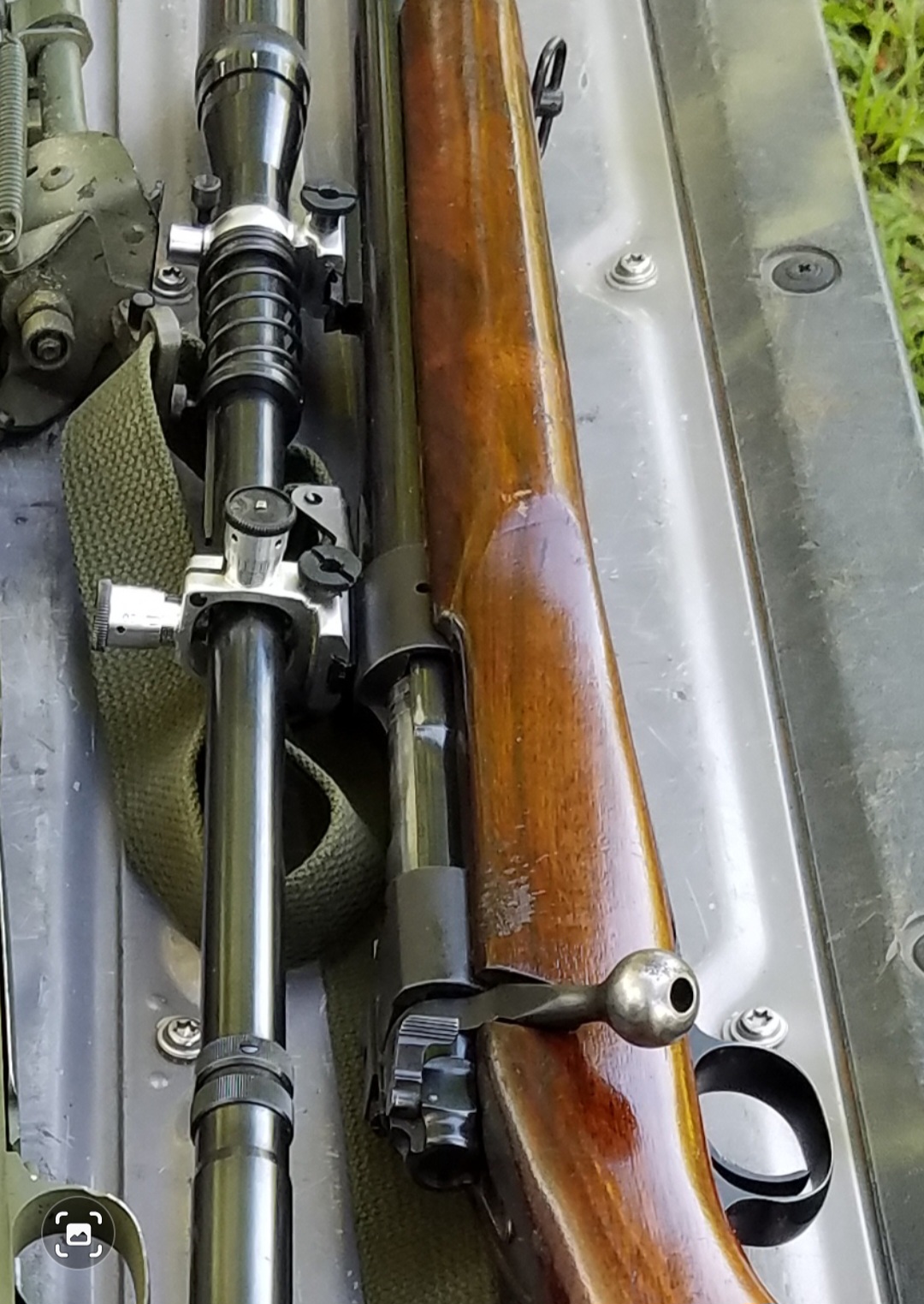

Here's my pre-64 project built in 2016. Tips? You want to use high-quality hardened screws on these mounts, not soft Chinese screws that can come with the Leatherwood 8x repo USMC scope. (I have one of those of my M1903 rifle, but the M70 has an old 10x Unertl w/ good screws).
There is a coil spring in the lower left that maintains pressure on the scope tube. It's critical that the spring provides good tension.
The two large mounting screws can loosen-up, so I put a little bit of white paint at 12 o'clock so when I'm at the range I can ensure it's tight. (I learned the hard way during its initial outing at a vintage sniper match - that even a little bit of loosening of the front mount screw - will cause a lot of horizontal stringing). As for being delicate scopes. Well, don't drop the rifle with one of these scopes, and don't take it out in the rain either. It's not sealed. My 2cts.
As for scope bases, I prefer to use these US-made parts by an dedicated artisan, they are high quality.
Good luck with your project.

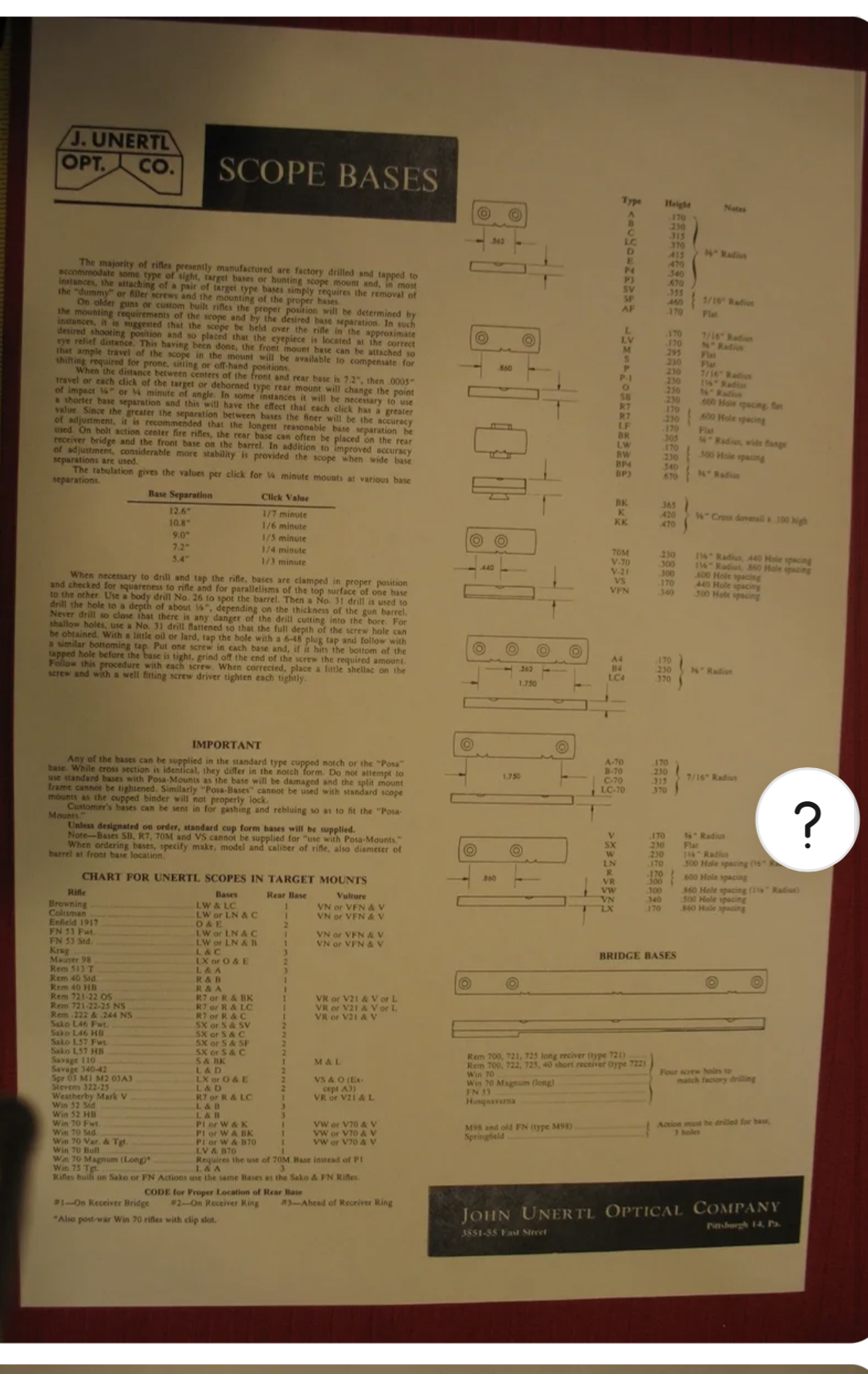

As for measurements OP, I have been eyeballing this sheet which will give you some of the measurements @Random Guy is speaking of. If I’m correct that is, he can chime in cause I’m semi retarded in most aspects of life
RandomGuy makes a good point about the base screws.
Don't use the Chinese screws in the package. Get American screws.
In your original post, u state the 70 target u have is drilled and tapped. U use the front receiver holes and the barrel holes approximately 6.5" in front of the receiver (center to center 7.2").
This hole spacing is to keep the adjustment clicks on the scope 1/4 minute of angle. Change the spacing, change the click value, do, don't do that.
Base heights can vary w barrel diameters, and if you shoot past 600 yards, you can change the height to keep the scope closer to ring center as you go out. Ring center is critical as you adjust bc if u go far enough in elevation, the windage will change as the tube curve rises or lowers.

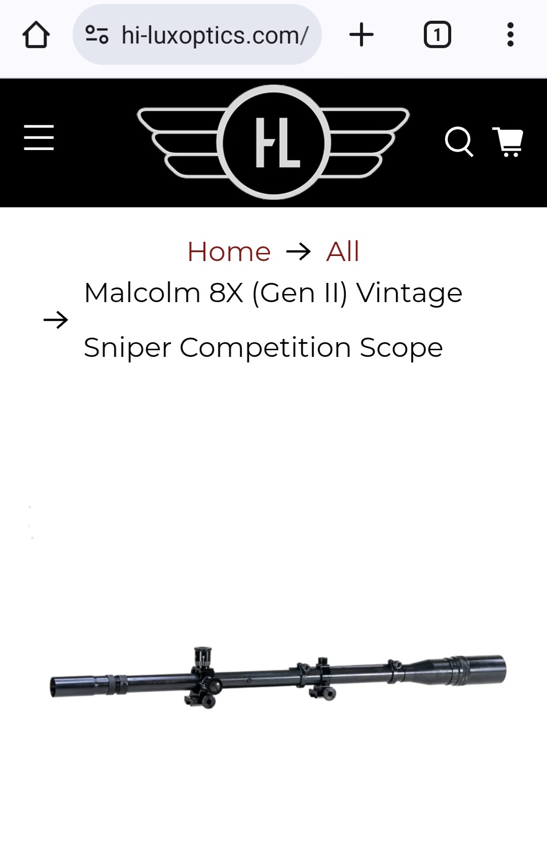

Thank you all for the information, I’m leaning towards the Hi-Lux/Malcom 20x Vintage target. Really have been on a retro kick these last few years and thinking this will pair nicely with the Remington 540X and Win 52

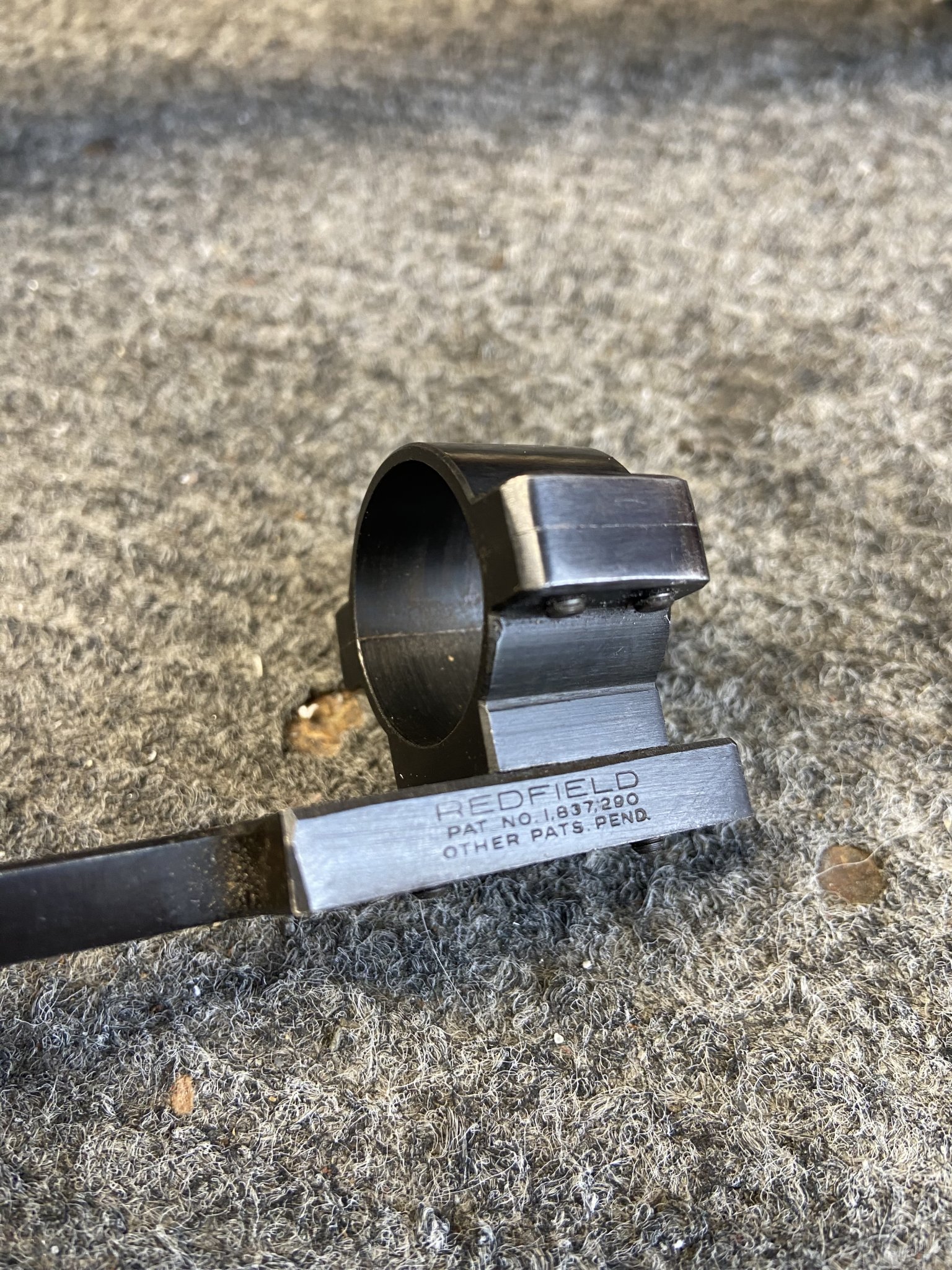

With regards to @RandomGuy would those mounts you shared be better than the factory HiLux mounts? If they are, I wont shy away from doing it proper and paying now rather than later.

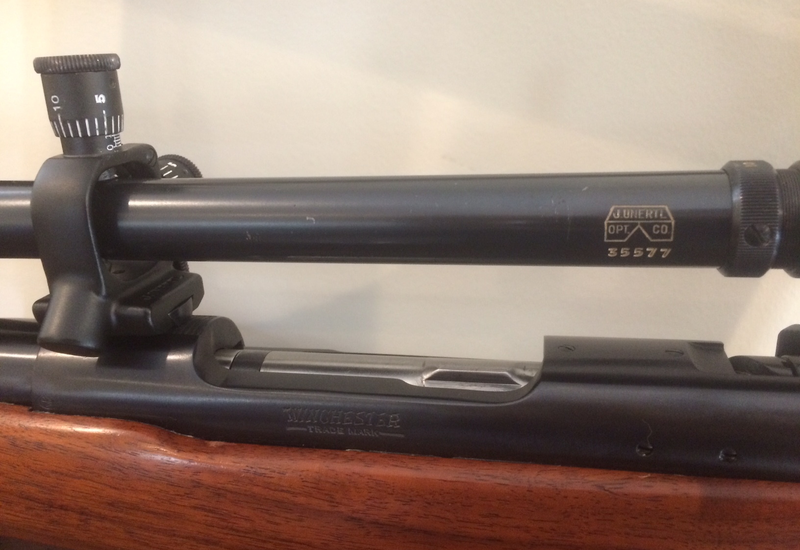

Recently picked up this Unertl.
Want to mount it to my pre-64 model 70 .220 Swift.
I know the weaver bases need to come off..
Looking for mounting block options to fit receiver and in the barrel dovetail.
Anyone have part numbers and/or recommendations?
Cheers, Sirhr

Look at Steve Earle Products or fleabay.
Or better yet @RTH1800 may have some. He has a lot of old stuff like that
Reactions: RTH1800
Replied. I’ll get them shipped.

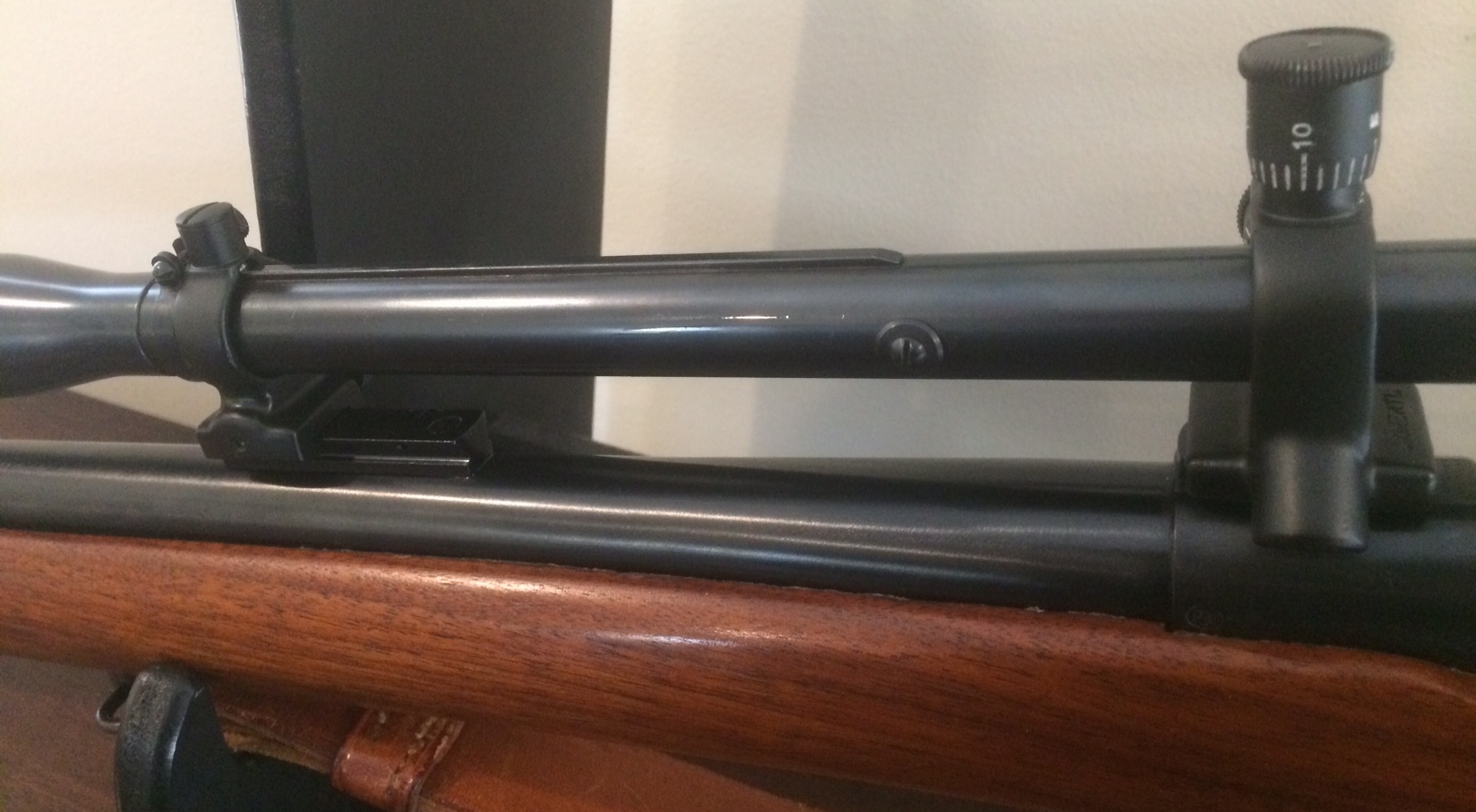

Also going to add some basic information regarding Unertl type scopes.
Sir’s scope has the standard mounts. Not the notched Posi mount. Much easier to find bases for.
It also has AO so that simplifies things.
The spring and front and rear keepers are used for positioning and setting eye relief. When not in use it’s best to loosen rear keeper and resting the spring. Has a thumbscrew to do that. When cleaning or after being damp you can back off and wipe tube under spring with light machine oil to prevent rust. Once re positioned it will return to exact zero.
The two screw circular piece with the power marking retains the reticule. If you back the screws out slightly it will allow you to rotate and level reticule to plumb.
The eyepiece can be loosened via the locking ring to focus reticule for maximum sharpness.
On scopes with no AO they have two screws on front part of tube. When slightly loosened you move forward or back to focus on target at desired range.
Many of these old scopes have one or more adjustments locked up from lack of use and dried oil. I normally get them freed up with hair dryer or heat gun.
No need to over tighten the thump screws on the bases. A simple hand tightening without much force will hold fine. No need to use tools or damage them.
That is about it. If anyone has question please feel free to ask.
