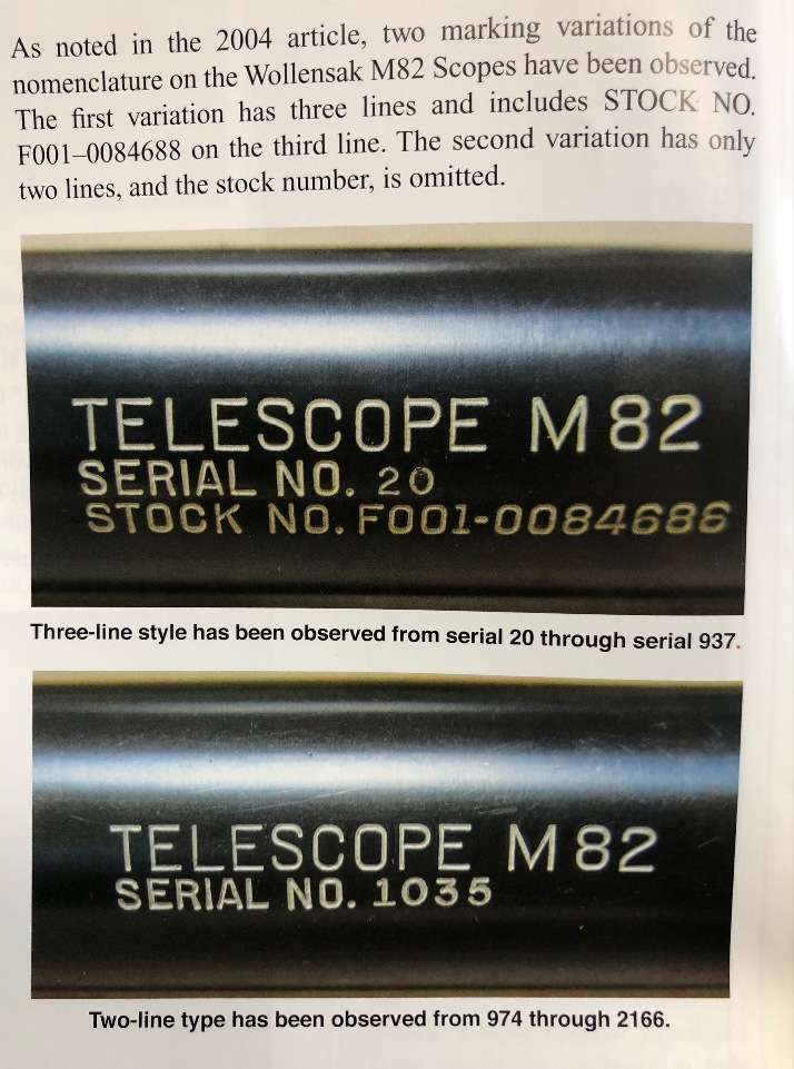

Hopefully it's okay to post this picture from the Garand Collector's Association (GCA), Summer 2013 edition (Page 11) - that ODCMP mentioned.
There were apparently two types of markings on the Wollensak M82 scopes, and the original shipping boxes were dated Oct 1946, suggesting they were delivered after WWII with a contract exception allowing "work in progress" to be completed. Pretty neat and unusual scope.
